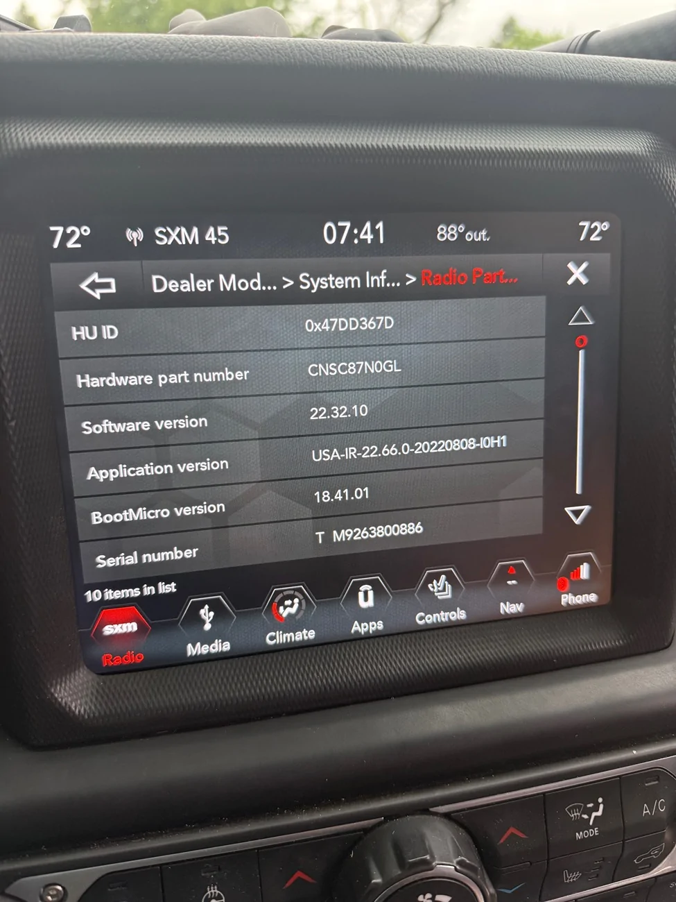

Thank you guys for all your info and tips!!
Just want to tell everyone I was able to fix my boot loop using this thread. I installed a "new" aircard from eBay and it restored my old version on my head unit. Everything is working as it used to. And now I'm debating to do the update as I'm on verision 22.66.
