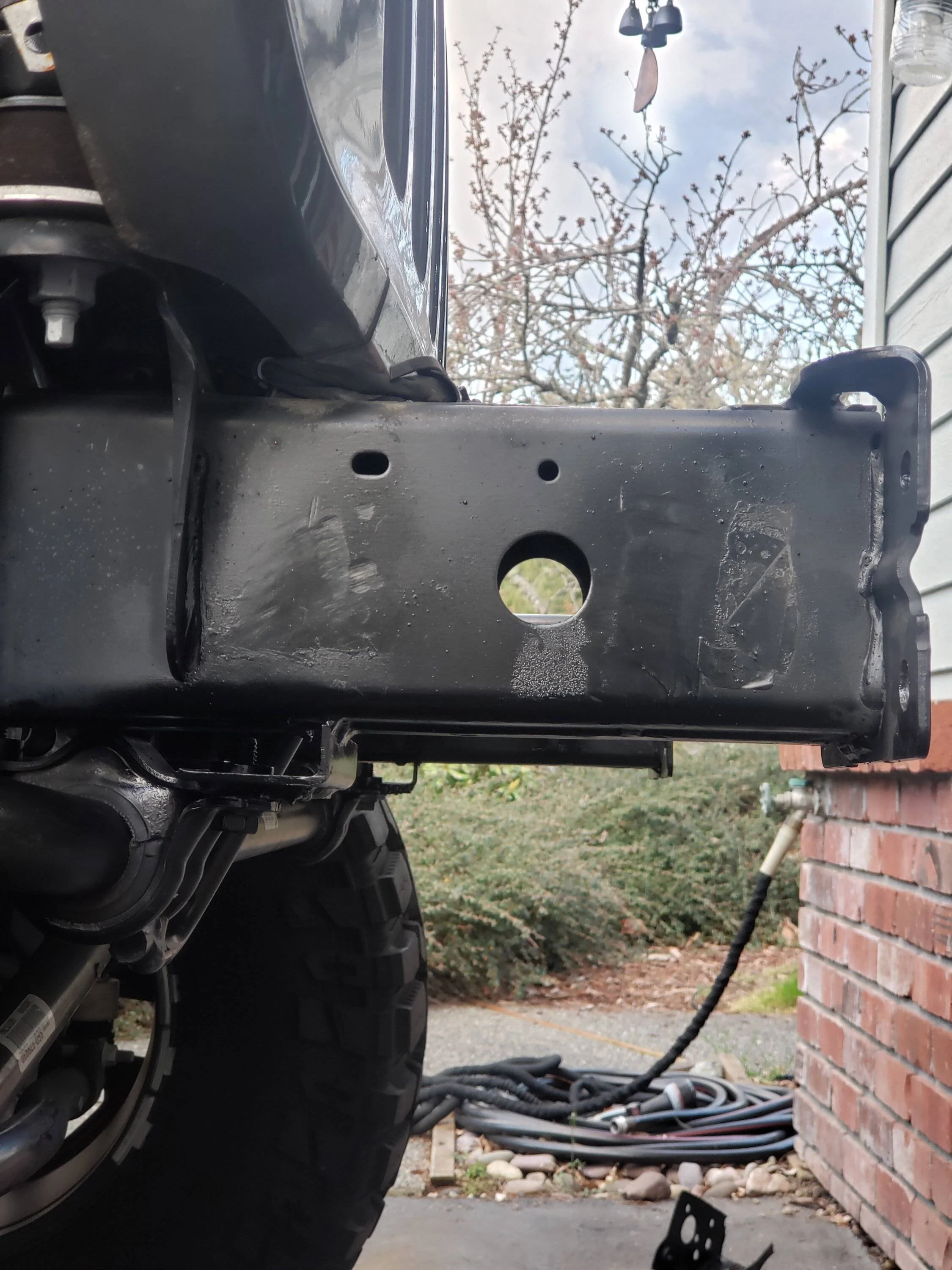

I went a little overboard, but it works just fine. Im using a normal sway bar with quick disconects, and a custom bumper.
Jeep Wrangler JL Tusk Chop (pics/progress anyone) 20220306_165008
Jeep Wrangler JL Tusk Chop (pics/progress anyone) 20220402_185435
I slugged the frame to add additional support for my winch tray.
Jeep Wrangler JL Tusk Chop (pics/progress anyone) 20220403_155904
Jeep Wrangler JL Tusk Chop (pics/progress anyone) 20220917_182019
Biggest thing to look out for is the front of the sway bar mount is tied into the "tusks" so be sure to have a plan for that. I cut some box tube up and welded that onto the frame to bridge the gap (you can see some of it in the pictures).

Appreciate this. I've scribed and marked off keeping ESB in mind. This weekend going to start. Nice bumper btw.

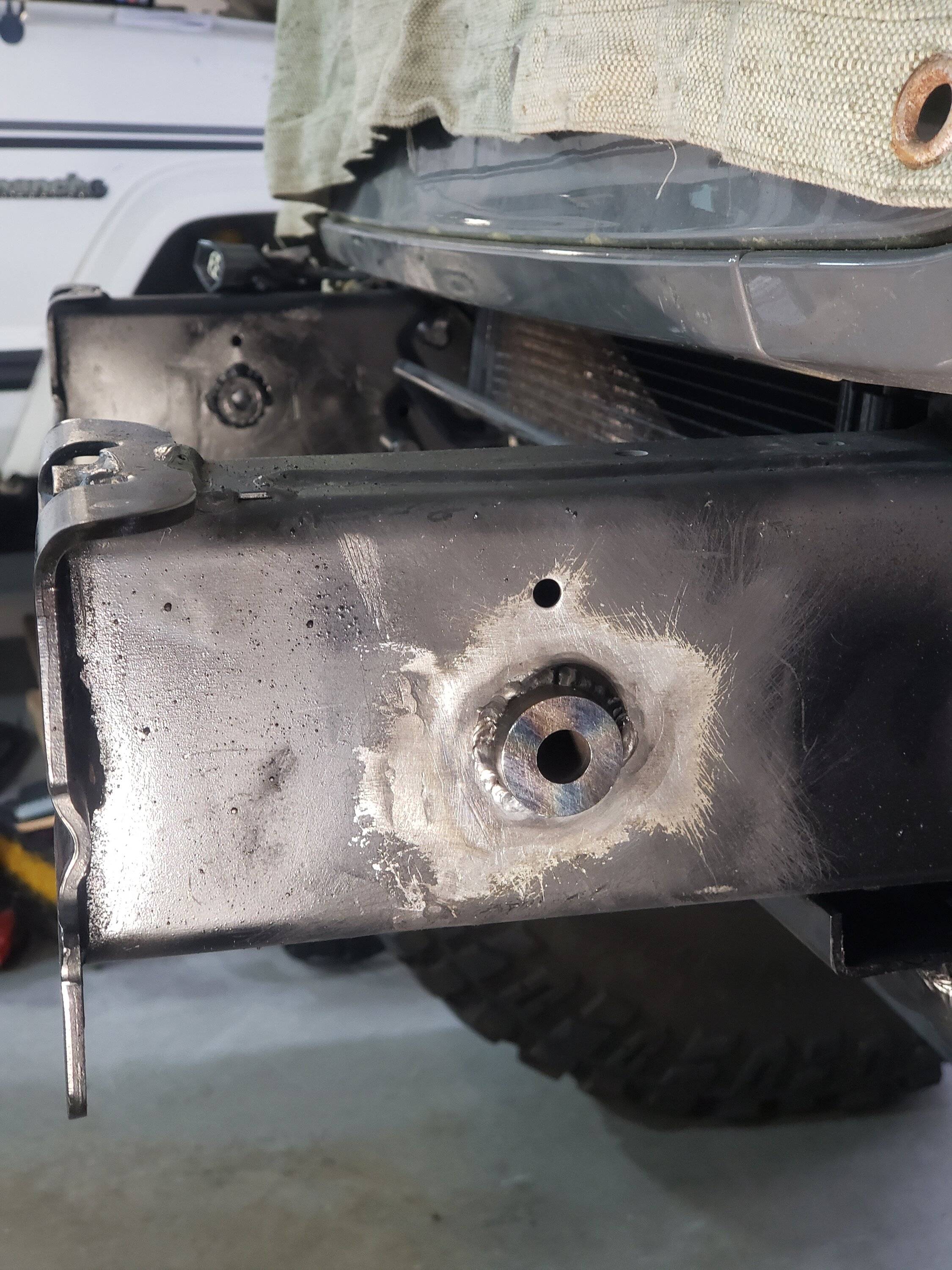

Whats funny is I meant to take a ton of pictures while doing all this work, and I was bumping up against a trip and ran out of time. Plus, I suck at taking pictures.
Basically what I did, is I used most of a JCR winch tray meant for a stock bumper, cut the "wings" off that tied into the tusks, and made my own that tied into the "slugs" I showed above. They went from being under the tray, to the top.
This is a piece of 3/16" plate with a weld washer, thats what the JCR plate is made out of so I figured it was strong enough. A "wing:"
Jeep Wrangler JL Tusk Chop (pics/progress anyone) 20220709_122236

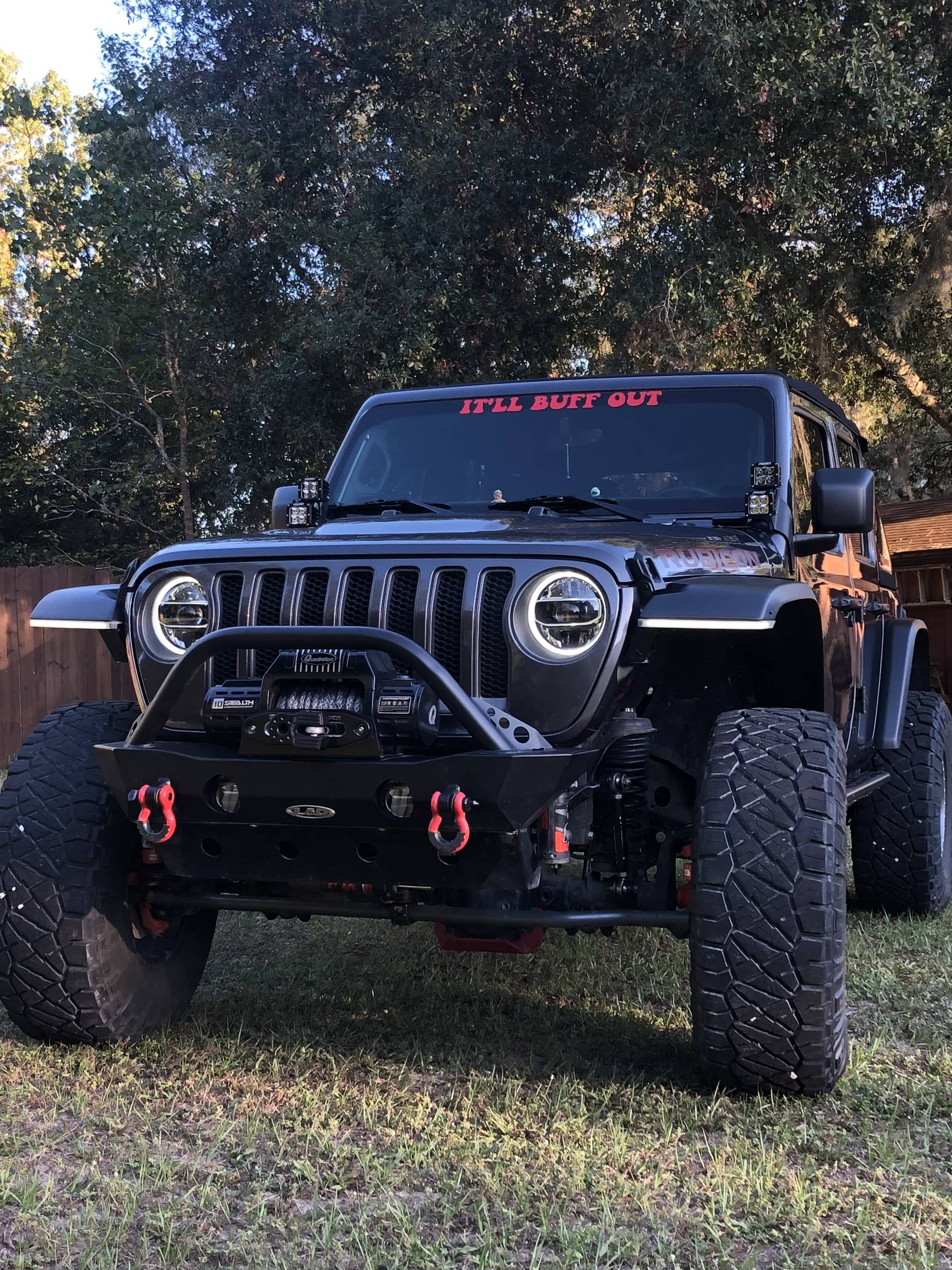

And bumper pics. Its actually two parts. As mentioned, the JCR winch plate and the bumper shell. It was easier for me to fab, plus you can get things a little tighter IMO. Shell is 1/8" plate, doubled up in spots along with some angle iron. Tow hook mounts are from EVO.
Jeep Wrangler JL Tusk Chop (pics/progress anyone) 20220918_153852
Jeep Wrangler JL Tusk Chop (pics/progress anyone) 20221112_112300
Jeep Wrangler JL Tusk Chop (pics/progress anyone) 20220918_153946
