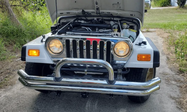

Got this dual brightness 3157 LED bulbs from Auxito for my 2006 Jeep Wrangler TJ. Much brighter than the OEM halogen bulbs. They went right into the OEM slot and are way better. They made this 14 year old Jeep look young again.
