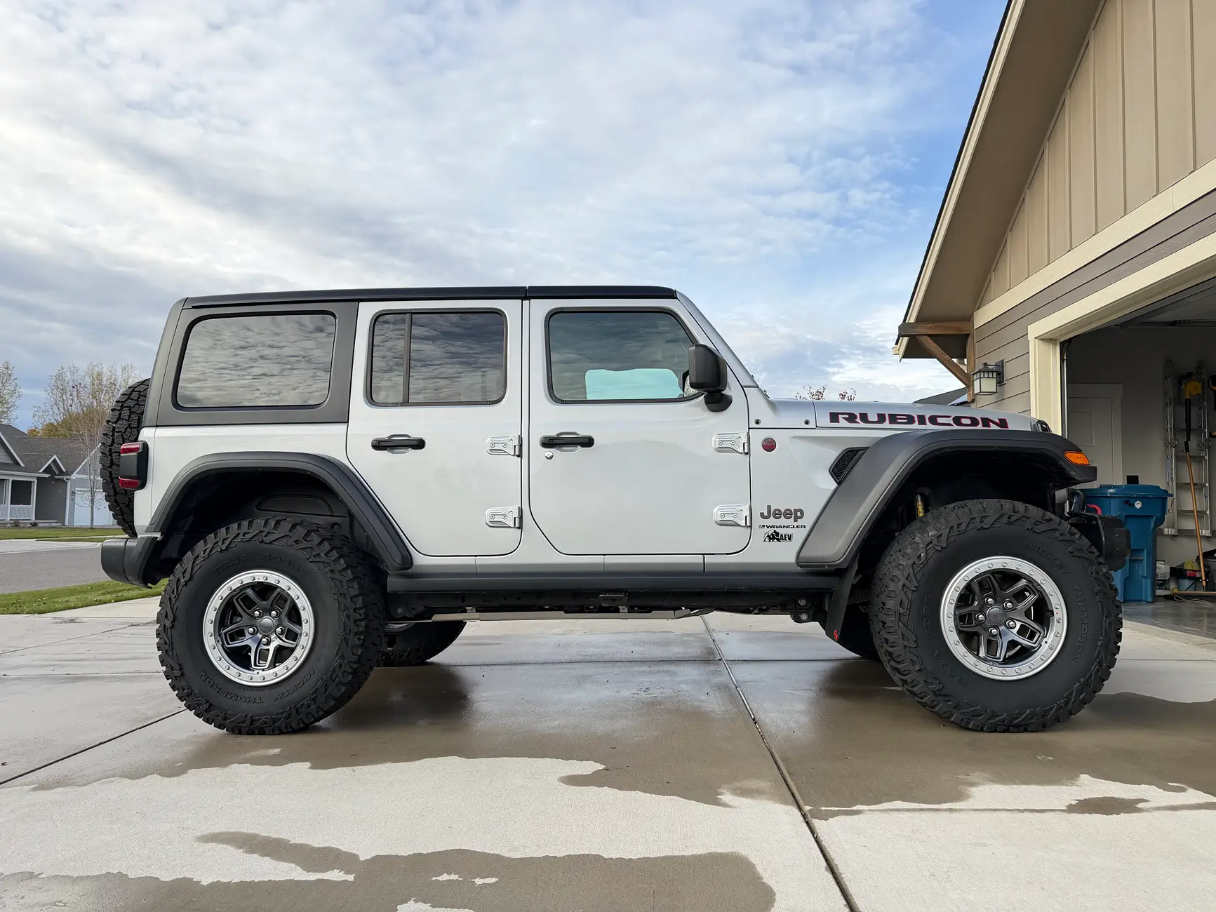

if you want a small 37 the Mickey Thompson baja legend exp is small according to Mickey Thompson....the Baja Boss series tend to run on the larger size of 37's..I know the Toyo ATIII's run on the smaller side as well. don't get too small of tire or you will just want something bigger..my 37's are already looking small...maybe look at a small set of 38's :)..
