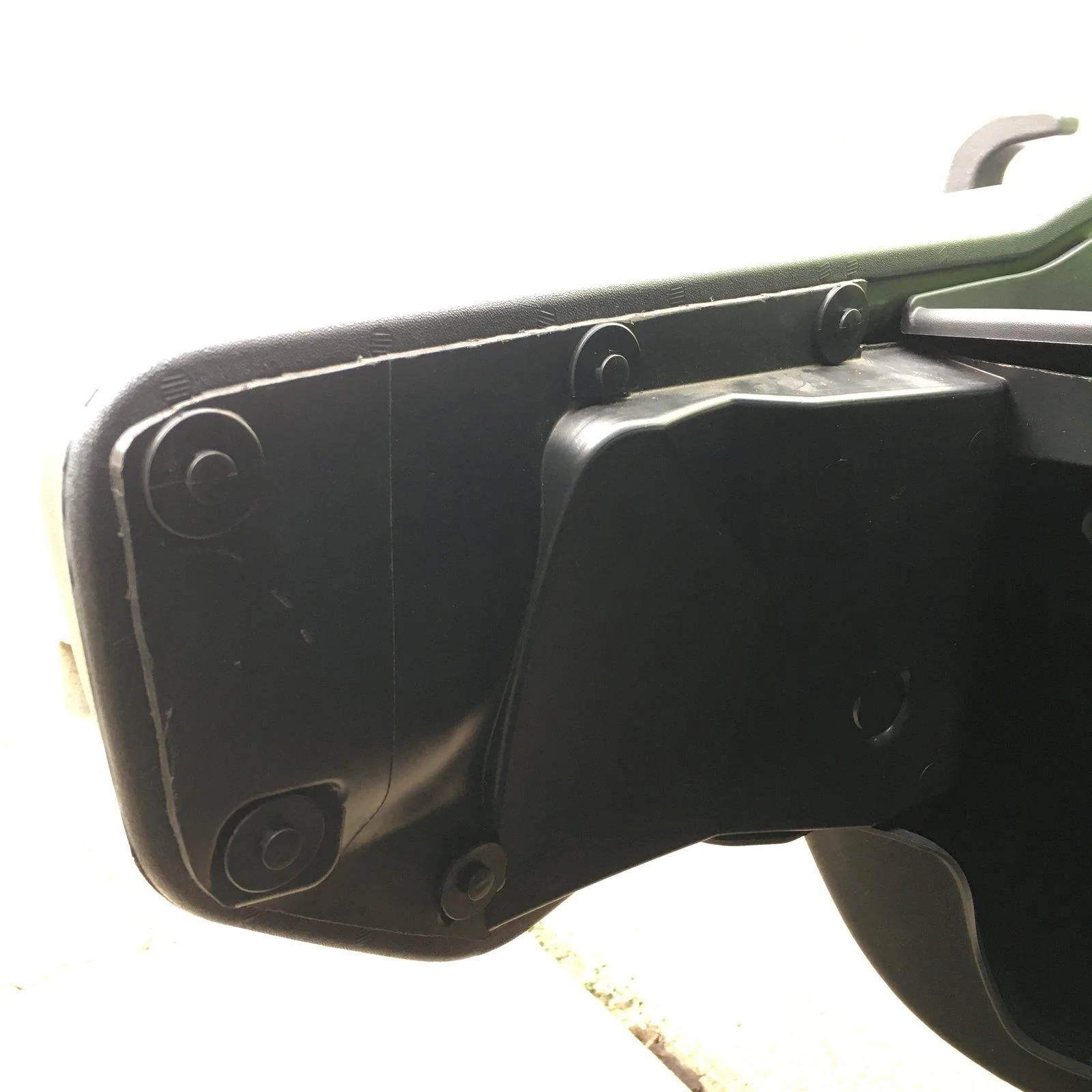

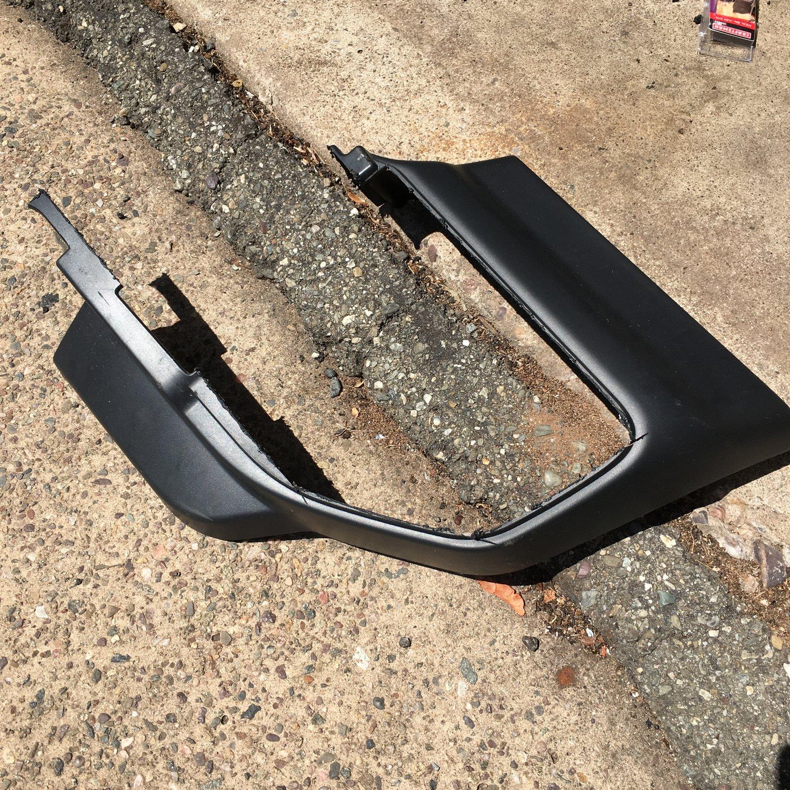

Since I put on the 35s, I am occasionally hearing a rubbing when doing a full turn lock. Seems to happen more when turning while reversing. I trimmed what I saw was rubbing, yet I'm still hearing it. Anyone else have this issue after 35s and 2.5 lift. It wouldn't be a big deal, but it makes a loud popping noise, which causes everyone to stair because they think they are about to witness an accident. Now I find myself parking in places where I don't have to turn much to pull out, just to avoid the gawking.
I trimmed the whole piece on mine with a small cutoff wheel, removed the nutserts from the bumper, and reattached it with trim push pins I had laying around from an old project car.

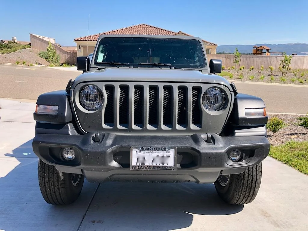

What does it look like from the front?
it is the splash guard/fender extension that is on Sport JLs. Plenty of folks (myself included) have removed them, some of those (myself included) trimmed off the outside and reinstalled to give some protection to the back of the fog light.
One note - the newer JLs are a little different shape than in the video, and don't use different size bolts.

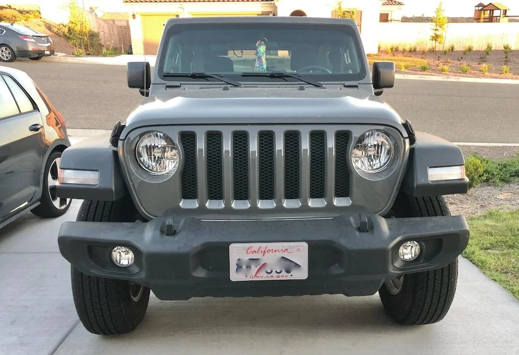

and a before/after for reference
