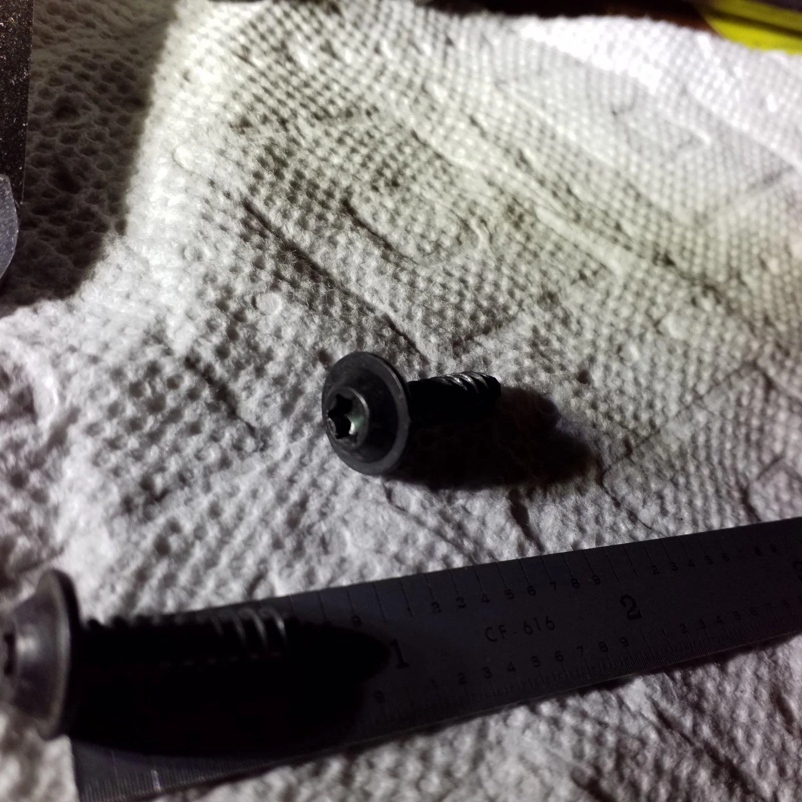

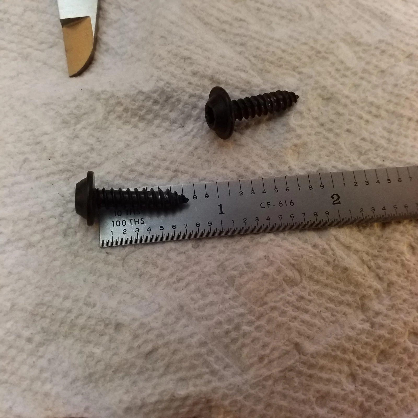

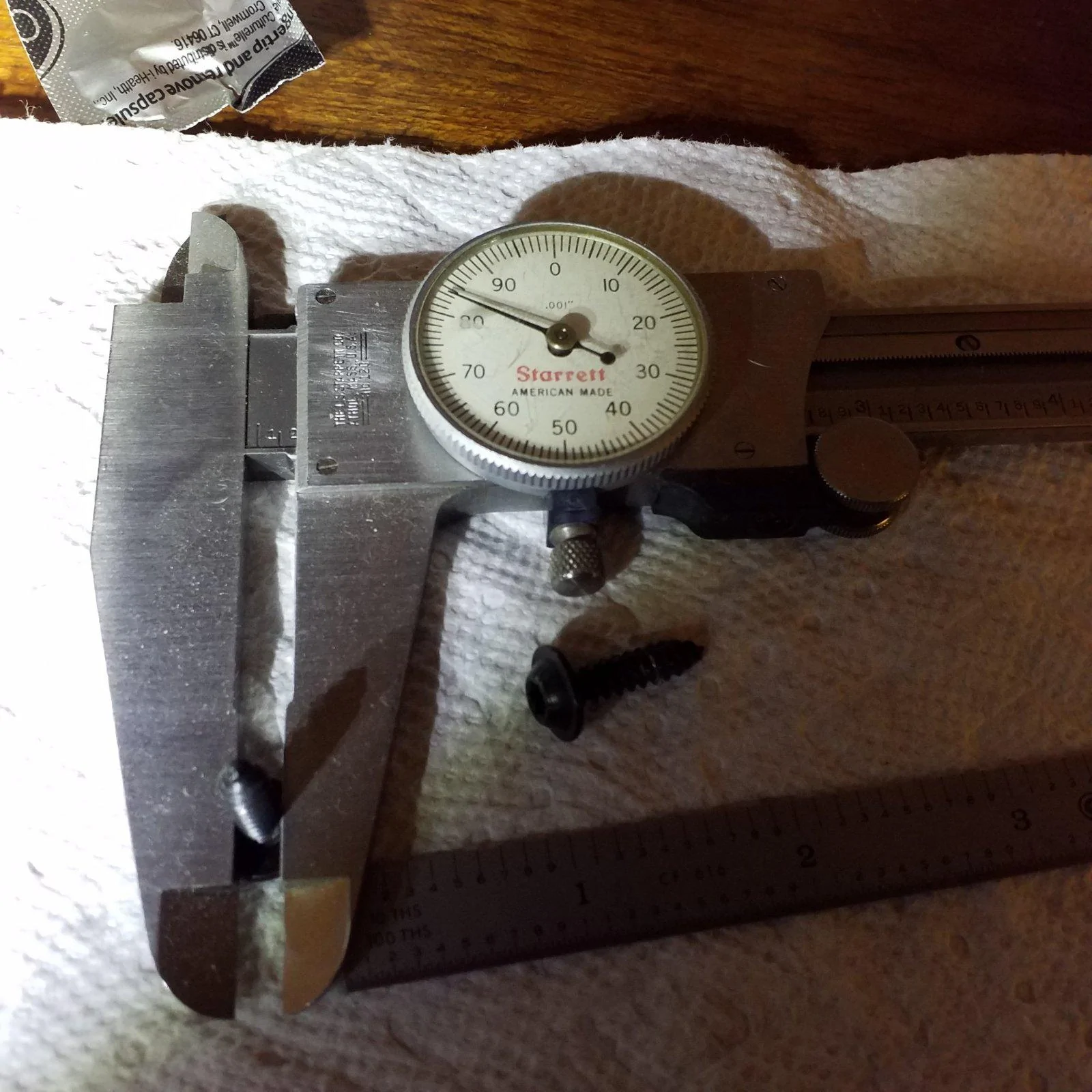

I believe it's this screw. I think it's the same screw as the rollbar trim. The Mopar spec for the rollbar trim says this:
Mopar Part No.:6101946 and calls it a 4.2x20 mm self tapping screw. However, my measurement of the major diameter suggests it's closer to 5mm. Pull one of your rollbar trim screws and measure it. I think you'll find it's the correct screw. If not, hit the autoparts store for their "emergency" parts rack or just put a #10 sheetmetal screw in there. It's a "tinnerman" nut (formed sheetmetal nut) and has a bit of flexibility.

Very nice calipers btw.
