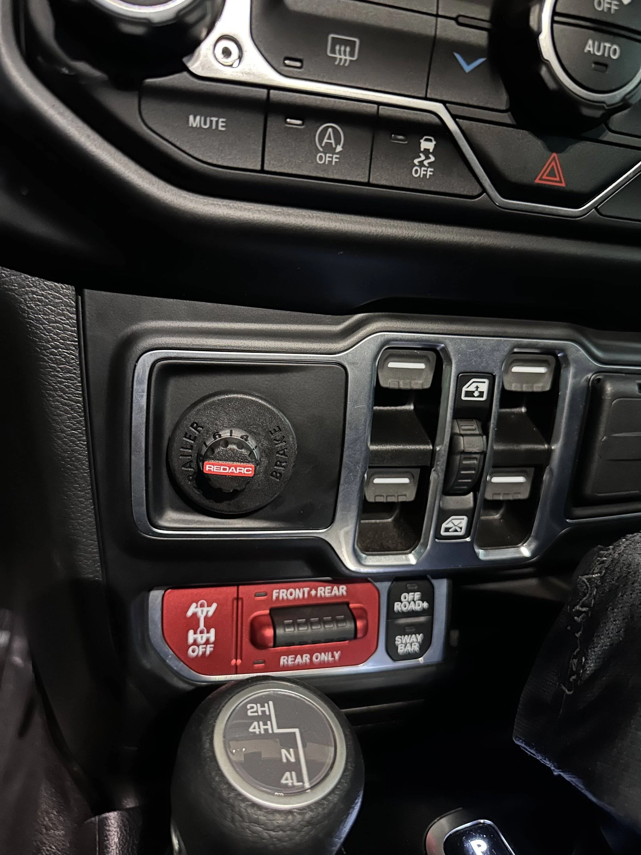

I was finally able to test my brake controller last night with a globe circuit tester and some help from the wife and everything is working as expected using this video as my guide:
The question from this original post was about the connector under the driver side dash and its usability if the Jeep did NOT have the factory tow package. After investigation, that connector is NOT usable. There is no power to that connector as the fuse it should be connected to in the PDU does not exist and one cannot be put in the fuse holder. I am not sure if the other wires in that connector are useful or not, but I did not use any of them.
My install included the following parts:
Redarc TowPro Elite: https://www.redarcelectronics.com/us/tow-pro-elite-electric-brake-controller
RedArc Encapsulated Protection Device: https://www.redarcelectronics.com/us/electric-brake-controller/encapsulated-power-diode
RedArc TowPro Mounting Kit: https://www.redarcelectronics.com/us/electric-brake-controller/tow-pro-mounting-kit
RedArc Switch Insert for Isuzu (I know, but trust me, it works!): https://www.redarcelectronics.com/us/switch-insert-to-suit-gmc-isuzu
In Line Fuse Holder: https://www.etrailer.com/Accessories-and-Parts/CURT/C58470-1.html
Lots of 12 and 14 gauge wire, butt splices, heat shrink tubing and electrical tape!
The install is not too bad once you figure out what you are going to do, hopefully this post helps others.
  • I installed the main unit under the steering wheel using the mounting kit. I had to bend it back so it is basically mounted flat instead of vertical like some of the videos show. There are fins on the plastic panel under the dash that were hitting the unit when vertical.
  • I installed the control knob where the 12V DC adapter was on the dash. This is where I used the Isuzu switch insert. You really dont need a 12V socket removal tool, it might help, but it was not that hard to get out, as long as you dont plan on using it again.
  • As for the wiring, I used the included universal wiring harness. I extended all of the wires coming out of the harness using butt splices with integrated heat shrink, and electrical tape. I created one loom to make it easier to fish under the dash to the passenger foot well.
  • I sent the power and ground wires through the gromet on the passenger side into the engine bay, grounded to the body at the existing ground terminal, spliced in the in line fuse holder and eventually connected the power to the positive battery terminal.
  • On the inside, the blue traler brake signal was connected to the blue trailer brake wire from the Mopar trailer wiring harness.
  • For pedal brake signal, at least on my 2022 JLUR-XR, there is a single wire wrapped up in the front passenger side kick panel. Once you remove the black tape wrap you will see that it is the desired dark green with white stripe brake signal wire drop.
  • This where I used the Encapsulated diode just to be safe. The red wire from the universal wiring harness connects to the red wire on the left side of the diode. When looking at the diode, make sure the side with RedArc embossed on the plastic is facing up.
  • The Green wire with white stripe is connected to the orange wire on the diode.
  • The Red wire on the right side of the diode is not used.
  • Once all the wires were connected, I bundled them up and shoved them behind the kick panel.
  • Last step is to connect the positive battery lead to the battery and close all the trim pieces back up.
Here is a shot of the control knob with the Isuzu switch insert. I like the look, almost factory. It sticks out just a bit, but not enough to bother me.
I hope this helps the next Jeeper!
