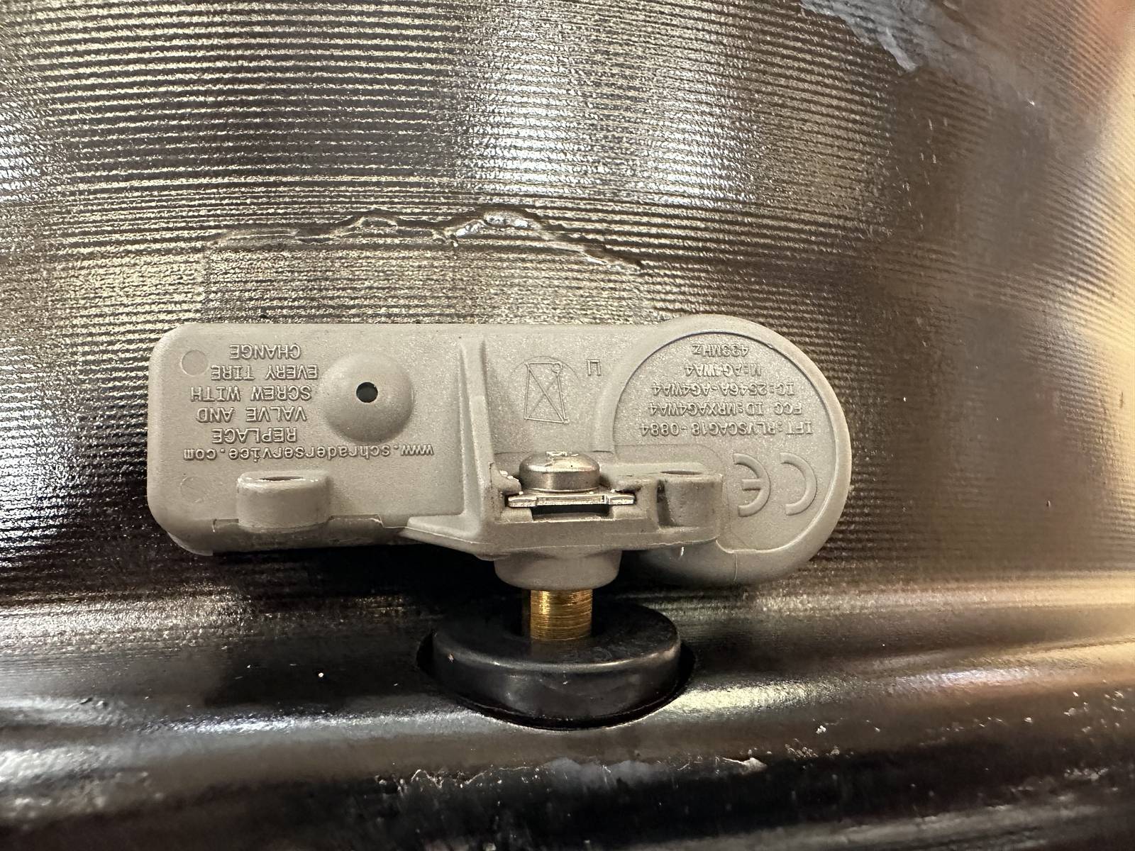

It will be a routine swap for any tire shop with no issues. They attach to the valve stem inside of the wheel with a screw. Here is a pic as an example although not your exact setup.
Thank you so much! This is very helpful! I am NOT mechanically minded - lol! But I'm learning so much here on the forum by reading all of the posts!
