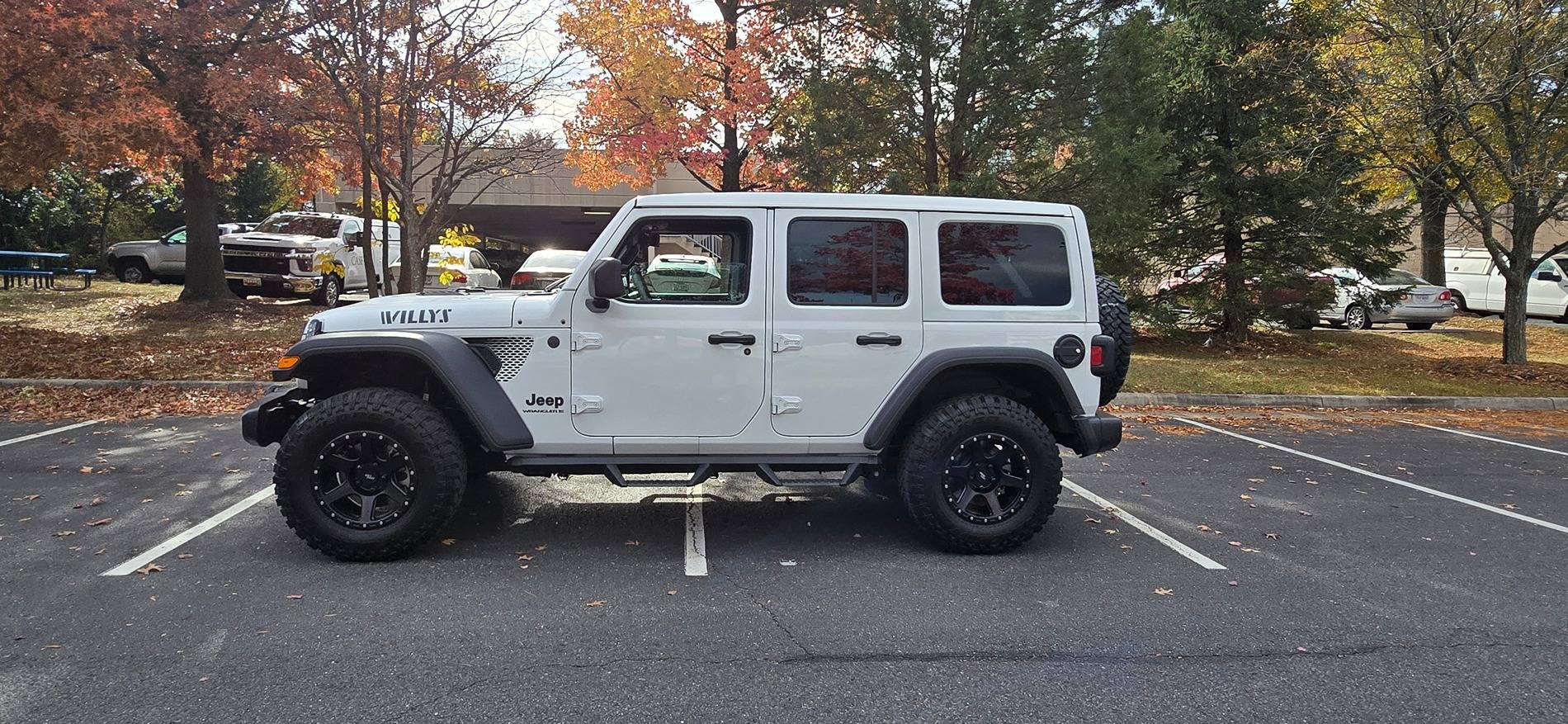

Share some photos when you have that installed. A friend will start the mods on his new JL after finalizing the mods on the Raptor which got 35" KO2's, XD852 xd wheels, and Bomber Baja bumper. The gunmetal RT112 looks nice
I posted pics.look above your reply
