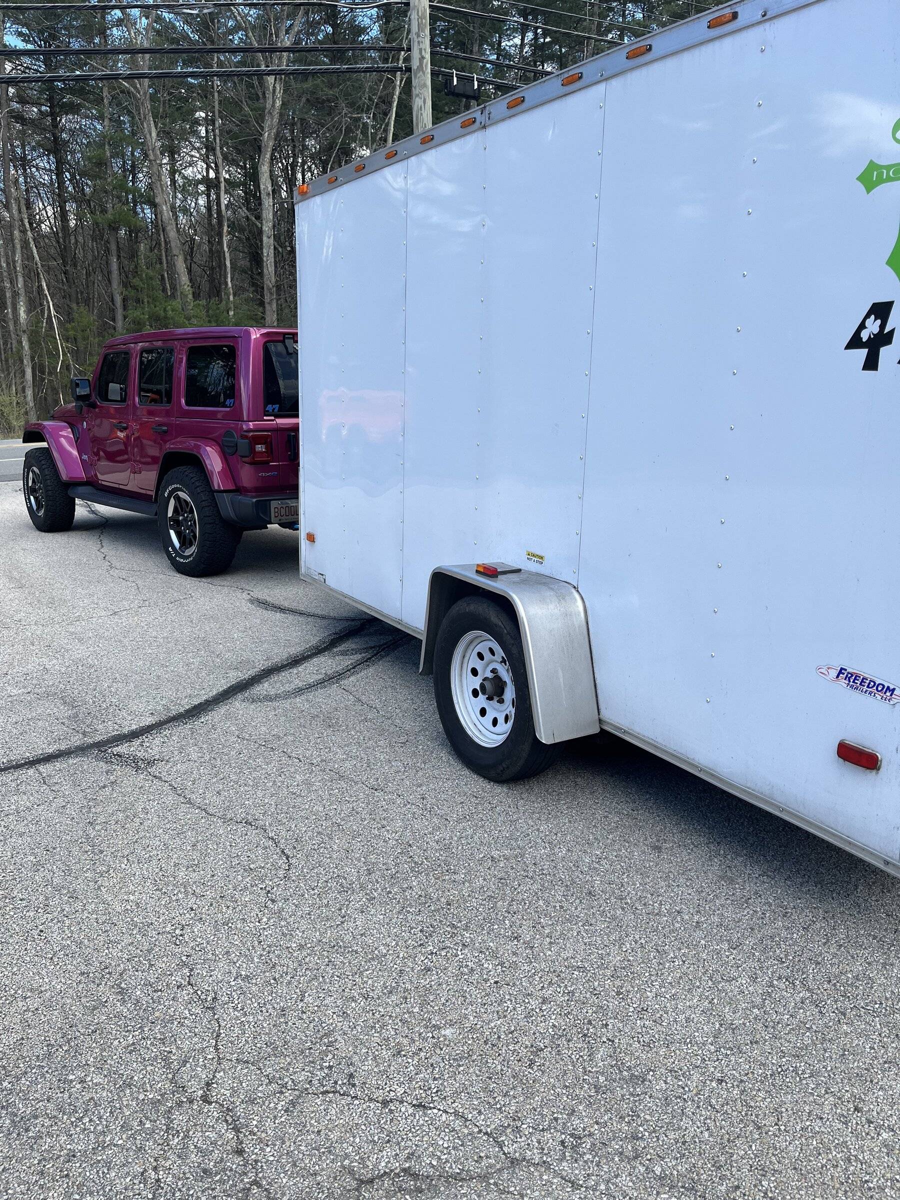

I tow a 7x14 (including the V) enclosed, that normally loaded is probably 2,500 lbs. 21 Sahara 4xe tows it very well. Just be sure to balance the weight, including appropriate tongue weight. I've found that this helped me some with trailer sway, and am now also testing Air Lift 1000 airbags.
