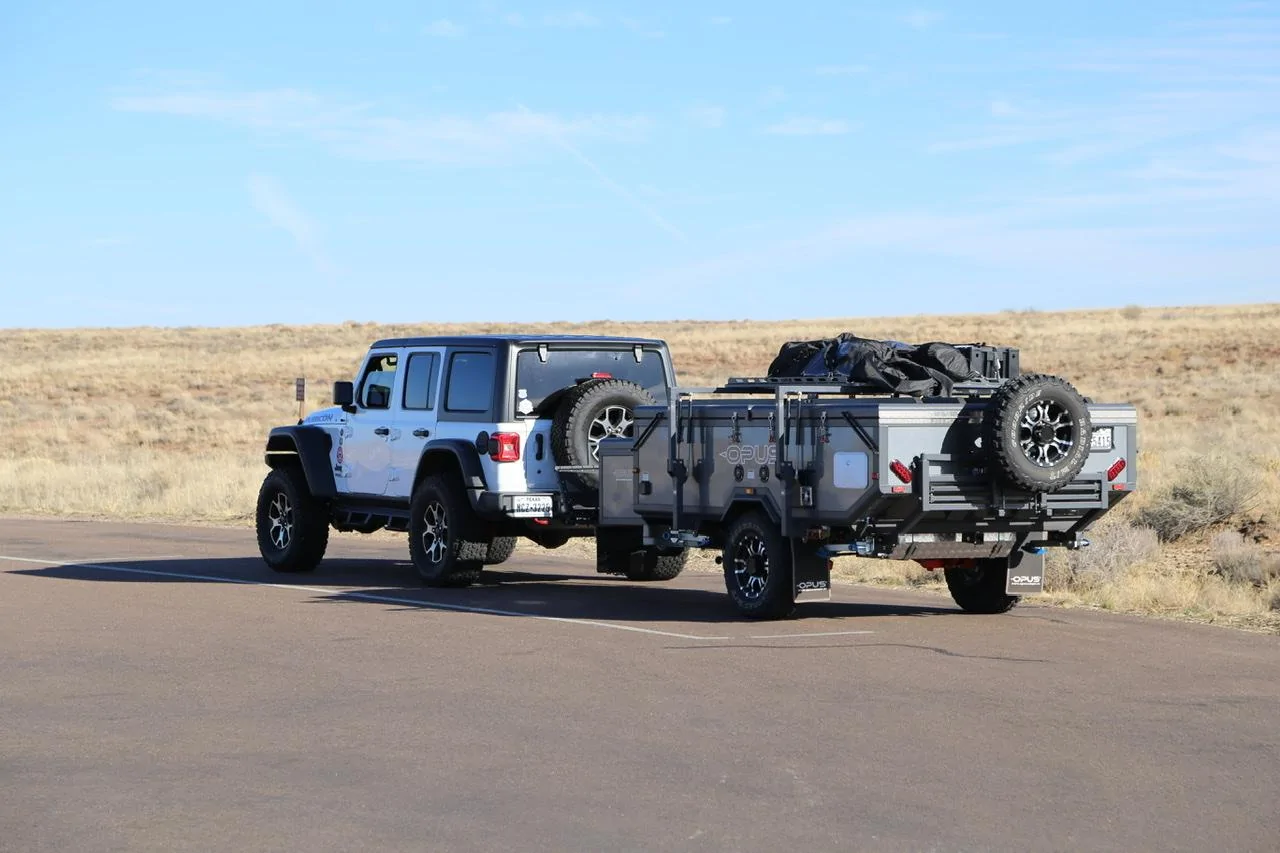

I have a lifted JLUR on 37s and pull a camper all over the US. My solution for the hitch problem was to put a real bumper with a reciever built into it.
I put on an ACE Engineering bumper that I think is just about impossible to hurt. I think the Jeep would cave in around it before you could hurt it. The camper I pull is set up high so it can be pulled off road, so I do not even use a drop hitch with it..

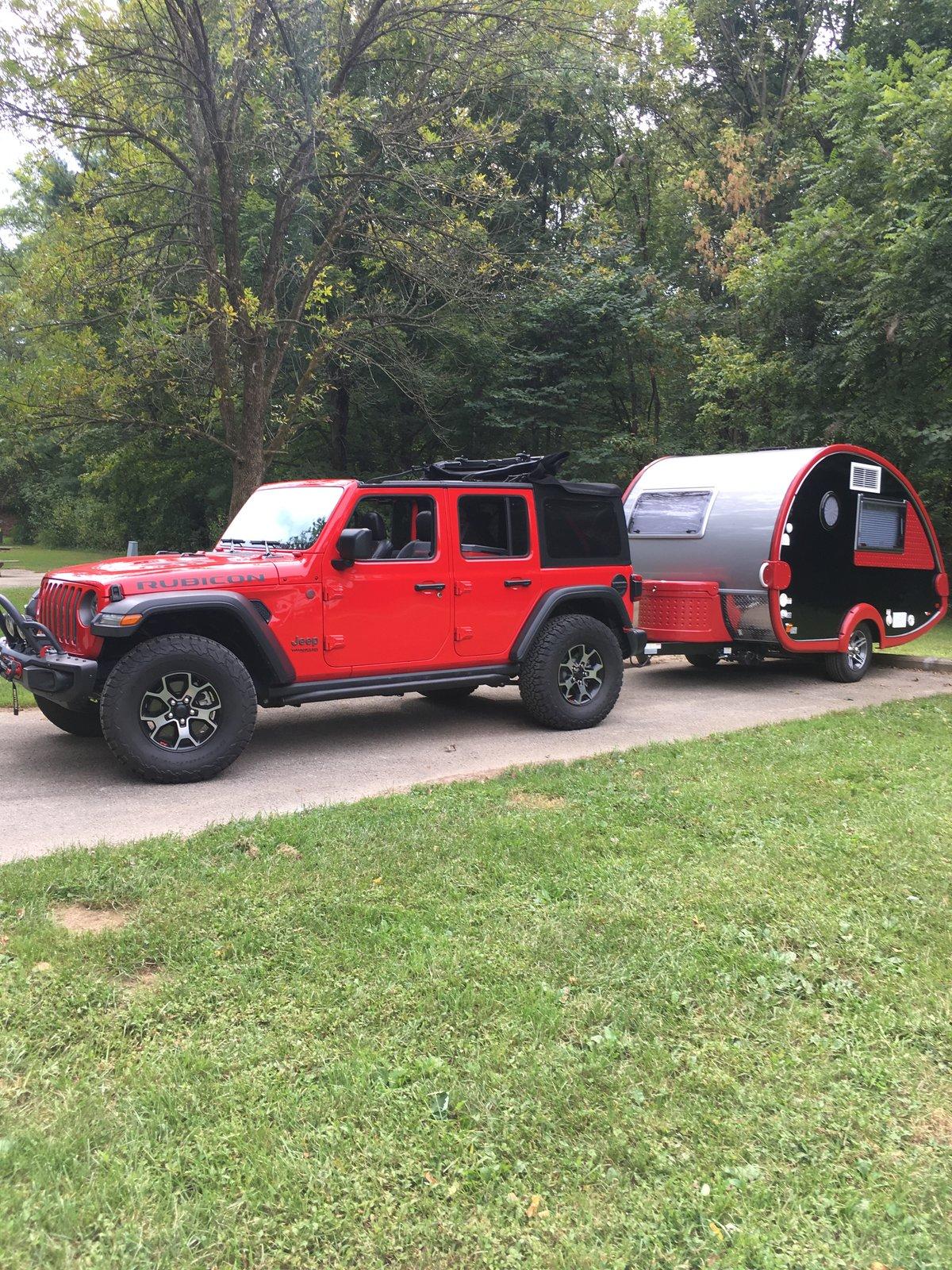

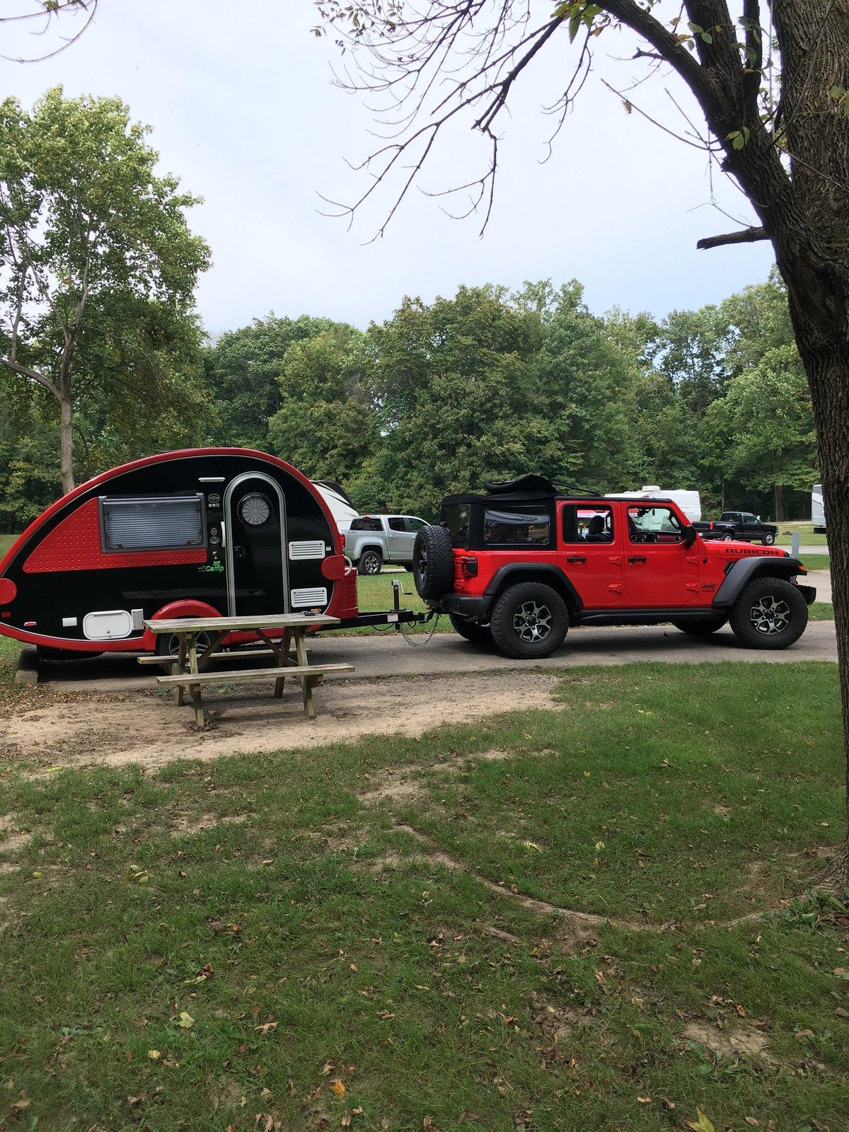

I tow a nucamp tab 320 on 35’s w/no problem. Planning on lifting this summer, and glad to see most people do not have a problem. 1,800 dry weight, 160 tongue.

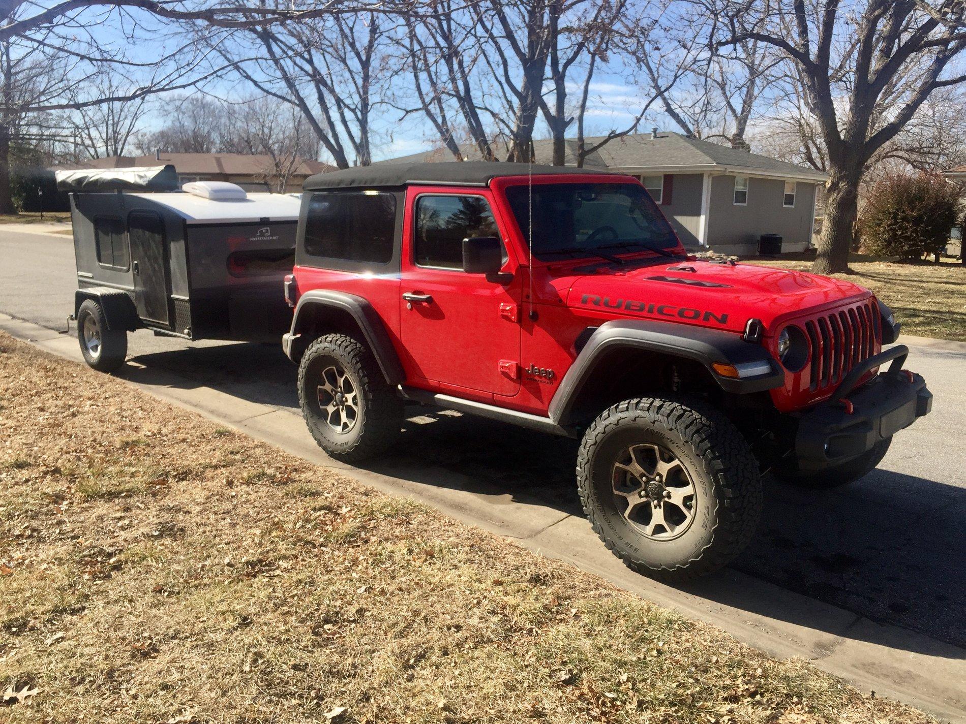

Here’s my 2.0T 2 door towing a Hiker 5x8 camper. I’m running the Mopar 2” and 315 70 17 K02’s. Depending on the type of camping we’re destined for, the loaded camper weighs in at 1500 (+/-) with a tongue weight about 180lbs. I’ve been towing this setup with an FJ Cruiser with a 2.5” lift. The camper put close to 2” squat on the Rubi, which is almost identical to the FJ. So far, I’ve only towed the camper around town a bit and for a quick jaunt on the highway to calibrate the brake controller so I am hardly in a position yet to judge how it performs, but early indications are very positive. I’ll follow up once I’ve had time to get this rig out and stretch her legs.
