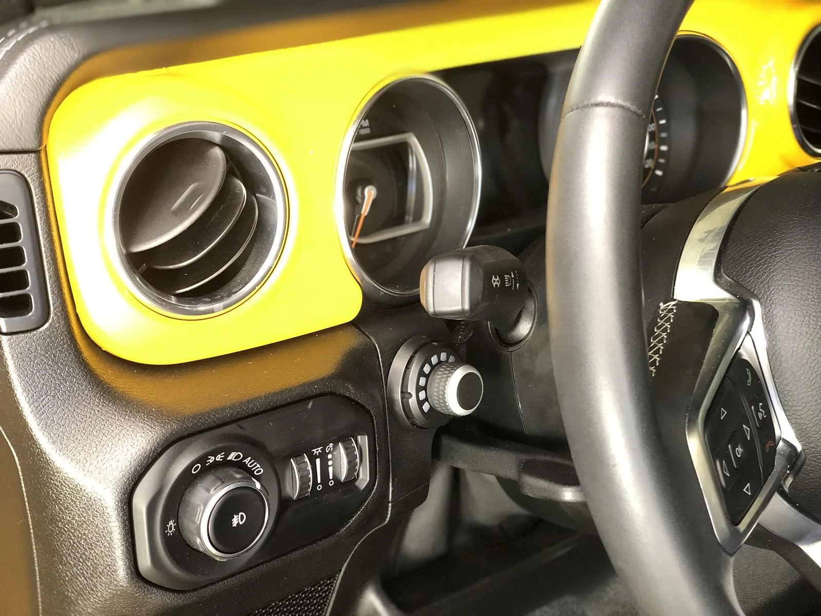

I looked at that one too but went with the Insight proportional. Seems to work fine for me
This looks interesting to me, but I'm not sure it is worth changing from my P3. I like how there is no interference with your knee.
The P3 has a lever for manual application of the brakes. I use this for helping to slow the rig going down a hill when I allow the gearing to brake the Jeep, but don't want the trailer pushing me. Can you do the same thing with the Insight controller?

I went with the Redarc Tow-Pro Elite. I wanted that clean factory look without something for my knee to bang on. It will be here today, hopefully I can get installed this weekend.

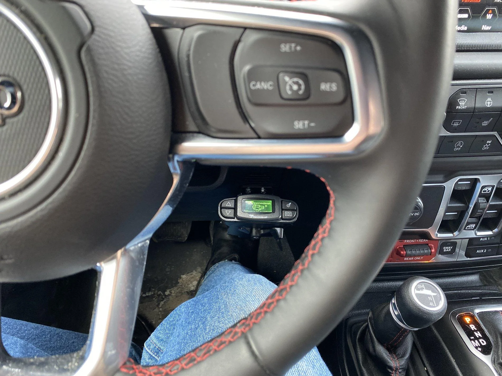

Here is a photo of the location of my Prodigy P3 controller. Still plenty of knee room (I'm 5'10"), but it would better with a small head unit like the RedArc or the Curt. I do, however, like have the lever on the P3 to be able to apply braking to the trailer alone if needed.
Was at camper dealership wrapping up some paperwork for camper.....your controller is the exact model I bought. Ordered the adapter direct from Tekonsha(be here next week).
....plenty of room where you mounted it - is where I'm going mount mine.

The RedArc can apply manual braking by pushing the rotary knob

The Insight brake controller has 3 basic components. The brain box, which I mounted on the heater enclosure forward of the glove box door, the display, which I mounted in the small cubby where the aux switches would go and a manual slider that I mounted on the right side of the steering column. The peripherals just plug into the brain using what look like phone jack/ethernet plugs. All of the parts simply stick on with 3M double sided tape. You need to be creative running the wiring, but what's new? So far, I really like it. It's perhaps not as aggressive as I'd like but that may be attributed to the angle I mounted the control module. In any case, it's working well for me and I REALLY like that it's out of the way and tidy. I also wired the trigger circuit (run from the 3rd brake light wire) through a switch on my overhead console so I can control activation when offroad. That prevents the trailer from sliding sideways down a greasy sidehill when brakes are applied. By switching the trigger wire instead of the power wire, I can still activate the trailer brakes manually with the slider. I've found that to work great in sketchy downhills.
