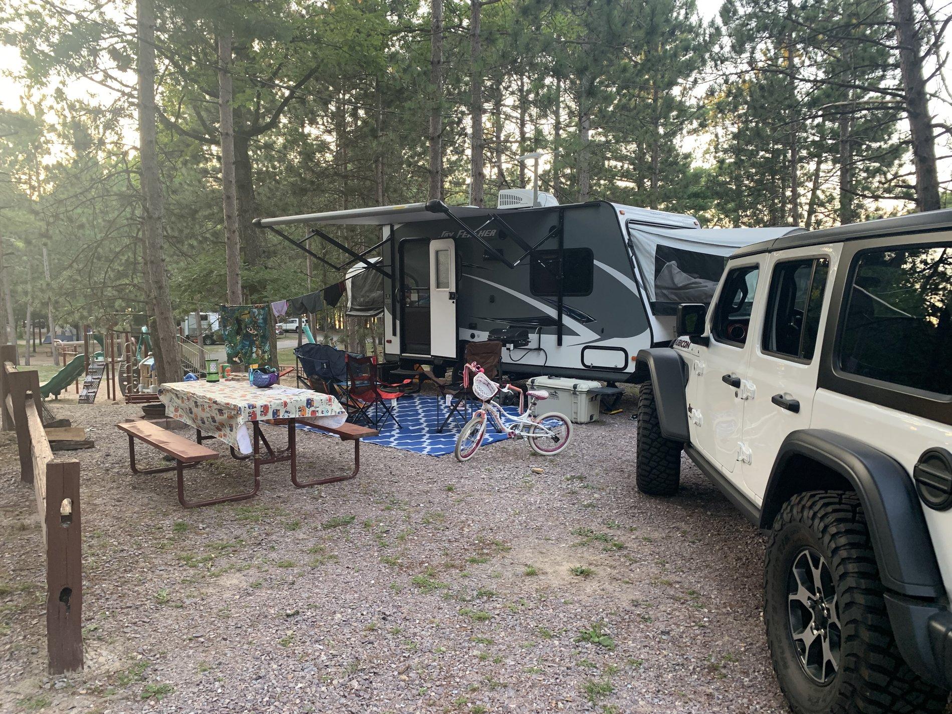

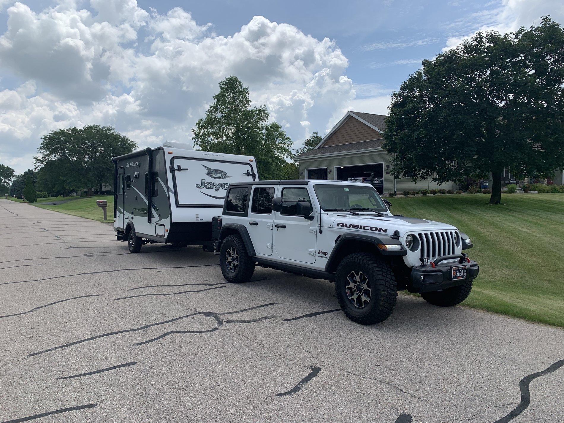

I’m pulling this on 35’s (no lift). MPG is terrible but otherwise it tows great with a brake controller and weight distribution hitch. I’m probably right at or just under 3500 when it’s loaded. 3100 dry.

What you have for tongue weight on that camper.
Tongue weight is 400. The Jeep squats bad without the distribution hitch but once it’s hooked up you can’t even tell it’s back there.
Good to know, I've been stressing a little about 300lb tongue weight on mine.

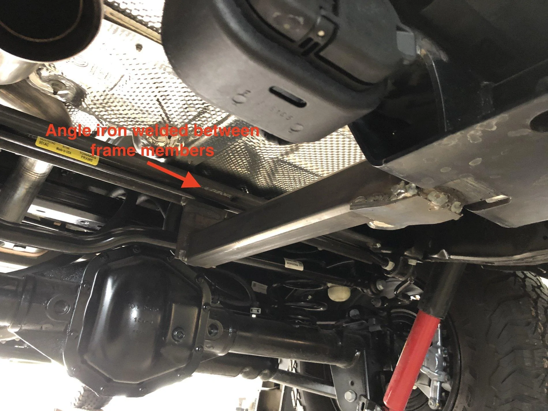

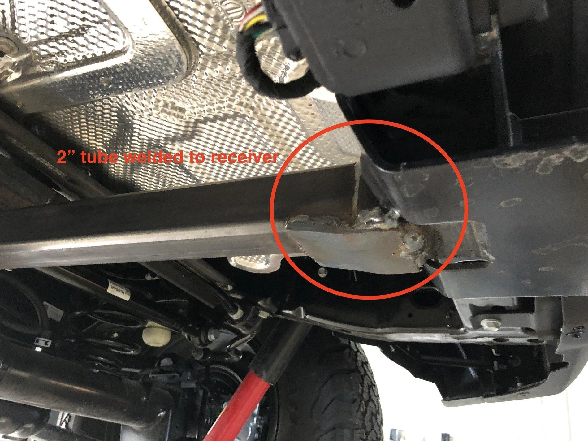

The reason that the hitch is rated at 350 lbs is because of its design. In order to go above that weight, especially with WDH the receiver should be strengthened. (The WDH puts a lot of fore/aft torque on the receiver which can bend it.) My hitch is now equivalent to a Class IV.
I removed the stock muffler and put in a Magnaflow axle back pipe and Magnaflow 40 muffler (behind the resonator) so that I the strengthening steel was easier to install than on my JK where the square tubing had to be bent to go around the muffler.

Nice job and well done. Most folks don't realize that when they add a WDH they are mostly just torquing the rear crossmember into a pretzel without adding much in the way of weight transfer.
Well played.
