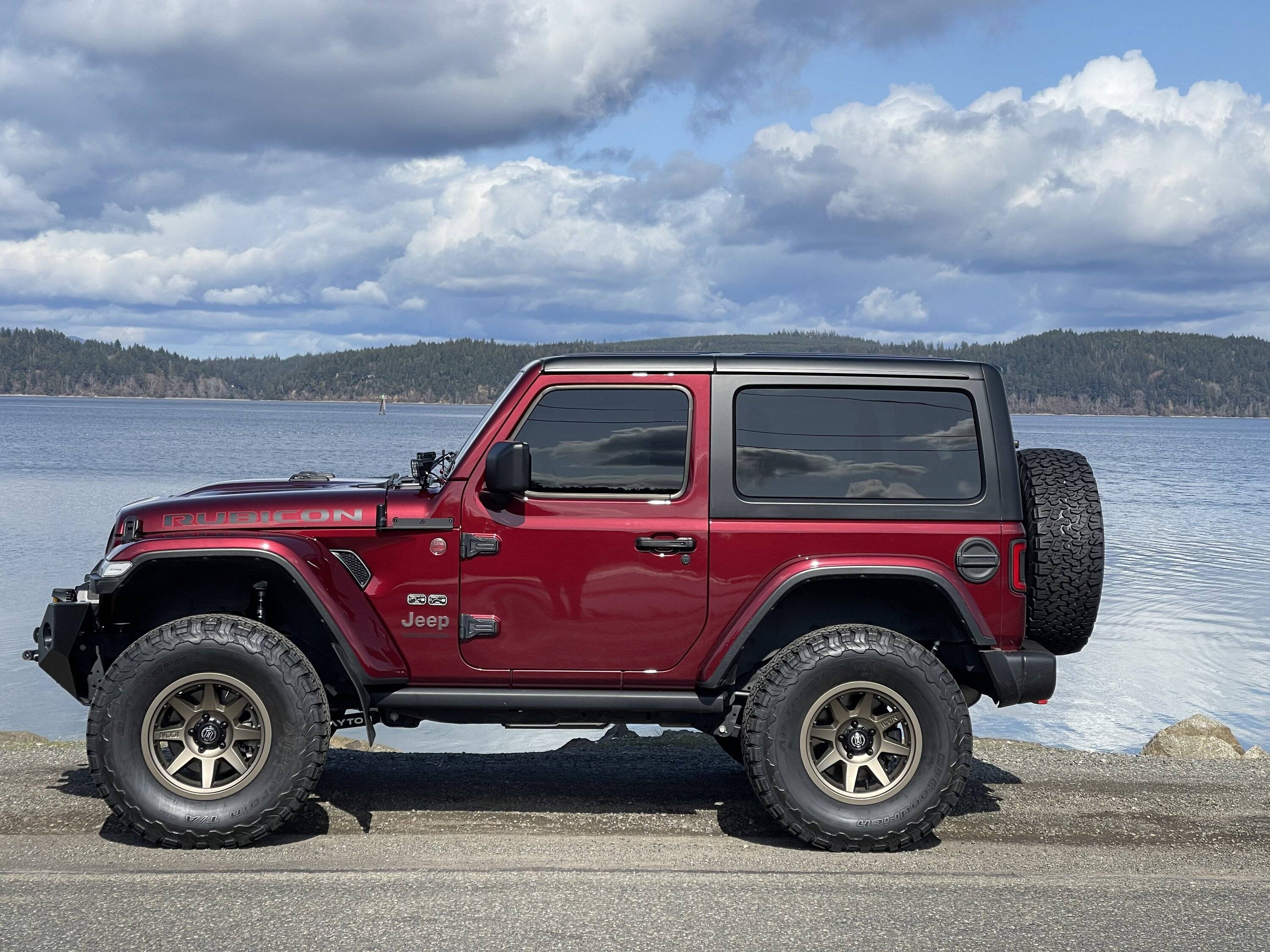

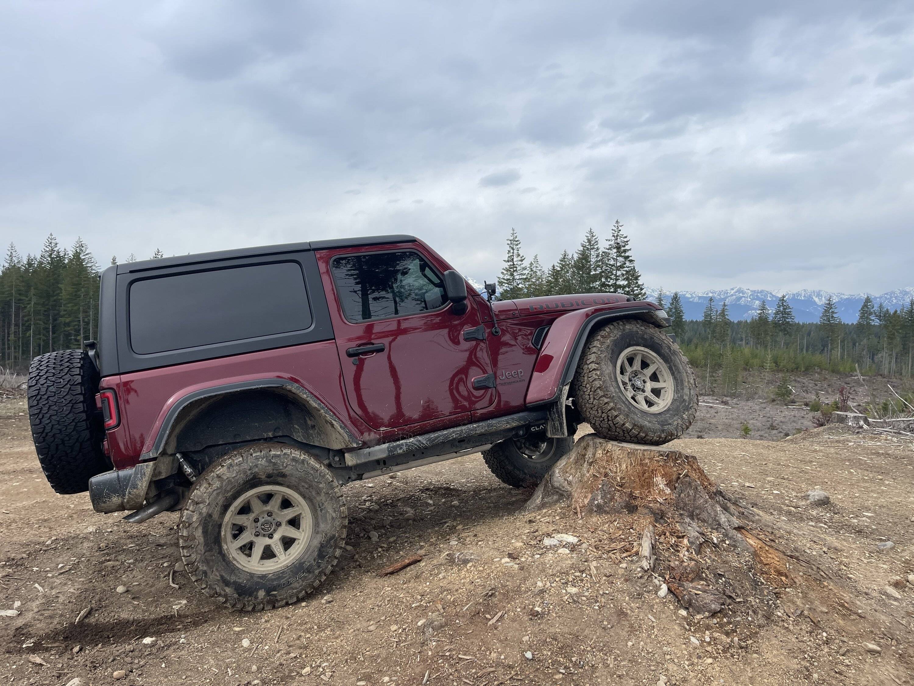

2dr JLR here. I went from stock 285s to 315s with 0 offset wheels. As mentioned above... a little less mpg, a less less braking ability, but I love the lift and poke it provided along with a 1.5in Clayton lift for trails. I do a fair amount of off-roading, and some rock crawling. For a 2dr I think this is the sweet spot.
