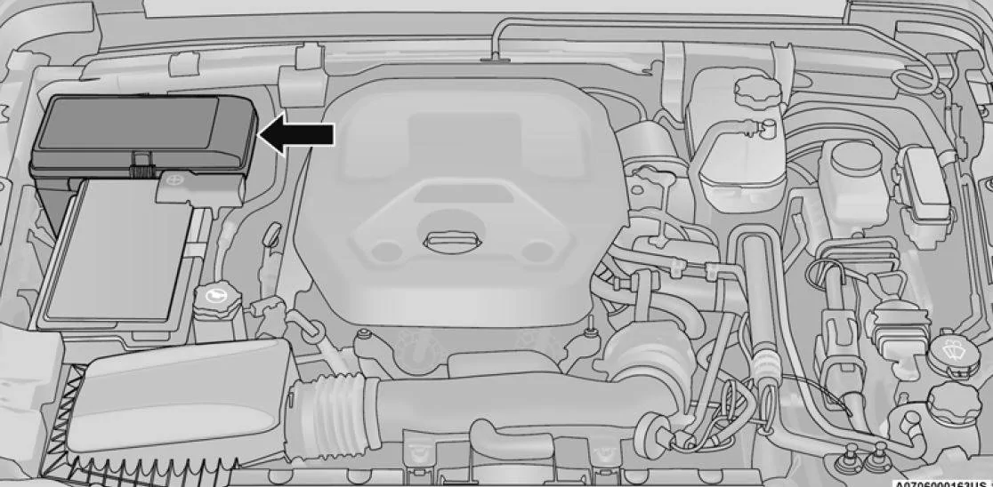

My Jeep was built 2/22/2022, and guess what? I checked the fuses to see how they were seated, and many of them I was able to compress further down, and some even compressed with a click noise.
Apparently, Jeep still cannot get this correct from the factory. So remember to check those fuses, no matter what year your JL is.

man, I swear by it! My 7" screen on my 18" was bugging out like crazy and when a member made this suggestion about seating the fuses, I laughed and thought he was nuts. I run out to the garage and a good 6-7 of them were definitely partially seated and I haven't had a bug since. that was roughly 2 years ago.:rock:

I’m late to doing this task (picked up mine December 16th) but also just found a majority of things not fully seated (with several clicks too). Thanks for the reminder.

Mine was built 2/01/22 and checked the fuses at least 6 went click after seating them again.
