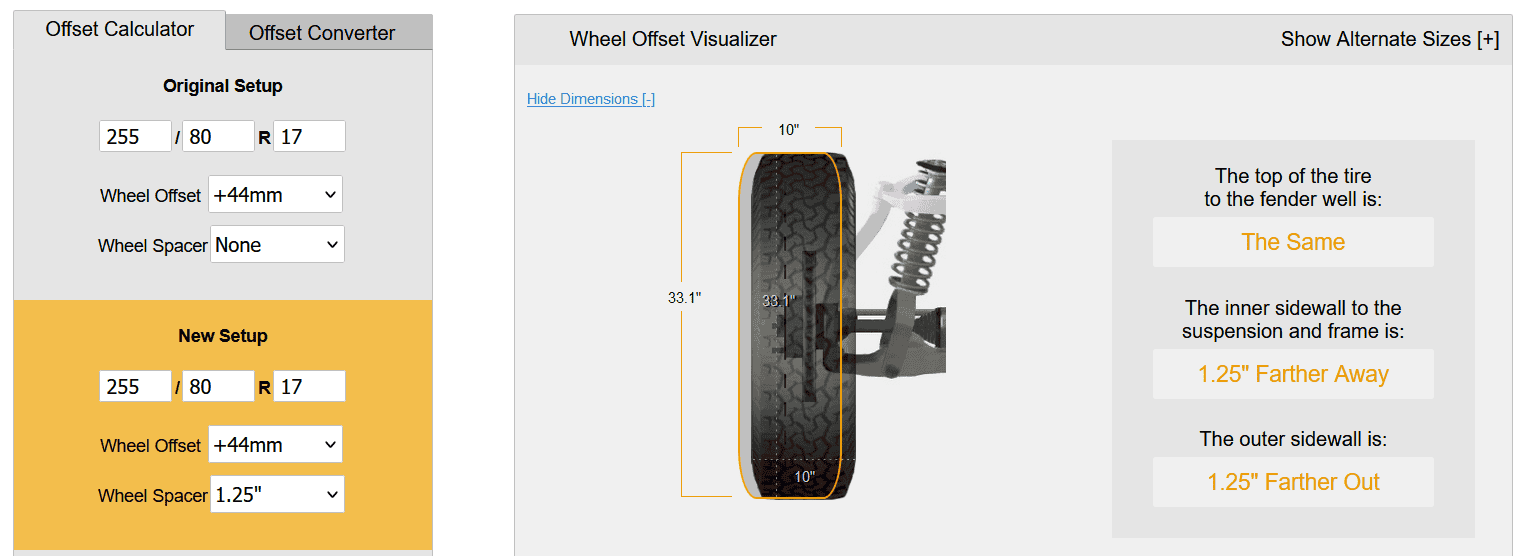

Stock (its precisely +44.5)
Jeep Wrangler JL Tire & wheel offset question. What am I doing wrong? 1694108502355
17x8.5 +10 Wheel
Jeep Wrangler JL Tire & wheel offset question. What am I doing wrong? 1694108129534

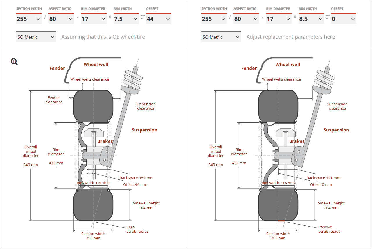

Its 6" - 5.14" --> nets you 0.86" additional clearance each side - sort of puts you at Rubicon wide-track axle's spec.
You can further this by going 17x8.5 +0 offset wheels (another commonly available spec from Method, Black rhino etc.) that would put you at 6" - 4.75" --> 1.25" of clearance (similar to what you would have achieved with the spacer)
See comparison below between stock wheel vs 17x8.5 +0 wheel. You can visualize the change
Jeep Wrangler JL Tire & wheel offset question. What am I doing wrong? 1694108786974
