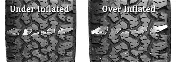

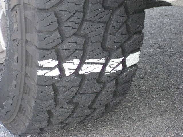

Two words: Chalk Test
The factory recommendation of 36-40 psi is absurd, and is probably the cause of a lot of premature suspension wear.
That said, I have 285/65/R17s, load range 'E' Cooper AT3 LT tires on stock wheels. All stock suspension. Close to 80% of my driving is on gravel or fire/logging roads. The chalk test indicated to me that I need to be in the 20-25 PSI range. The 20psi is what I normally air down to on the gravel, and only go to 25 if I'm planning a long stretch on the highway (20 psi is a little squishy in the turns). 20K miles later and I have no abnormal wear patterns, and I expect another 10K miles before I need to replace.
2nd 392
Jun 20, 2021
10,167
17,007
Ca
Yep- for the OP 👇

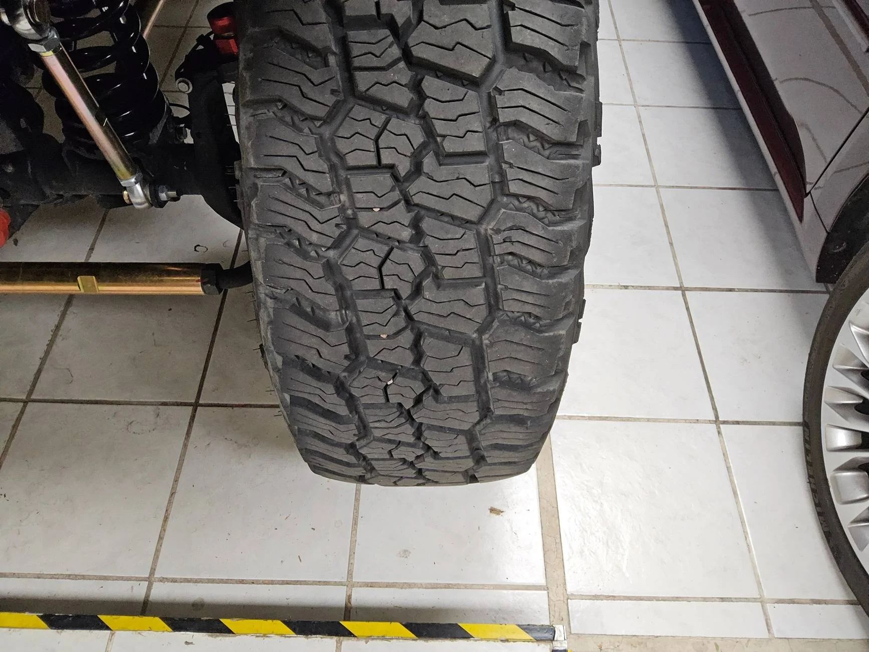

I am running Mickey Bajas LT315-70-17 Load Range E on Method 106 Beadlocks at 37 PSI and I have 6,000 miles on the tires and I have a little more rubber in the center treadblock than the outsides. I may increase to 39 PSI square.
For the trail, I air down to 10 PSI. It only takes no more than 8-10 minutes to air up all four tires back to 37 pounds.

Chalked mine by rolling over baking soda. Used my silicone water wiper and laid out a molecule layer. Very telling.
My 285's 4 ply P-rated tire on flat concrete run best at 29psi outside cold temp. Always lined up to run true. Never had anything but rail-like tracking. Not bragging cause its weekly maintenance.
