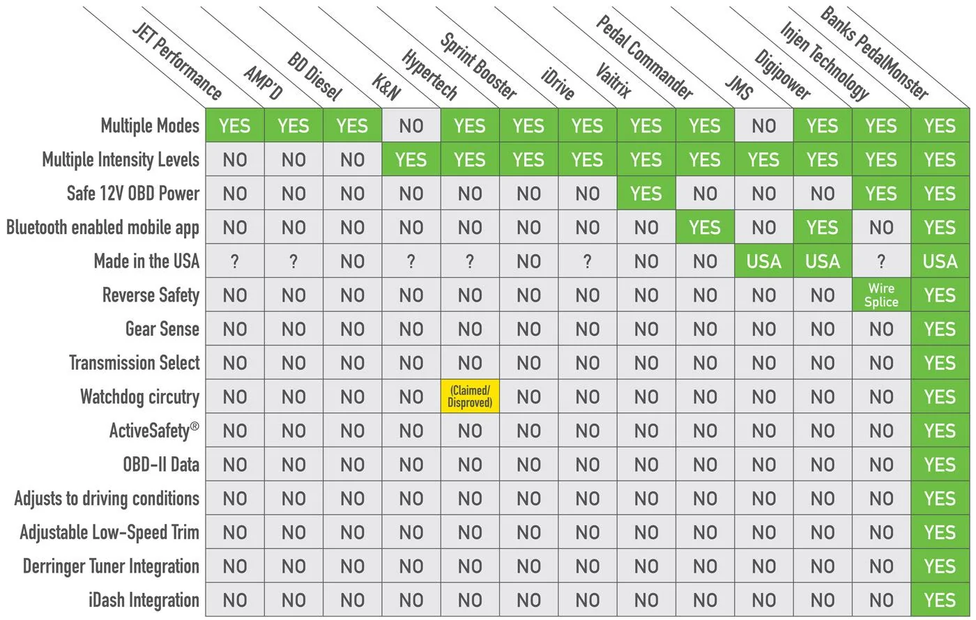

I just installed the hikeit X9 on my auto 3.6 JLU a few weeks back. Night and day difference. I set it to auto right now and just drive and it adapts to your style at that moment. I haven’t tried the hikeit mode because every thing I’ve read and heard is to do it in an empty lot. I actually see 8th gear more than I used to also which surprised me. I spent $184 with an additional faceplate with the discount code.
I wonder why Hikeit doesn't show up on the chart I posted? Are they new? Or, maybe they are known by another brand name and are on the chart under that heading? Seems like everyone, and their dog, is on that chart.
BTW, in case you didn't guess, Banks created that chart.
I think they are fairly new like within the last 2 years. When I was doing my research I couldn’t find any reviews from before 2019.
