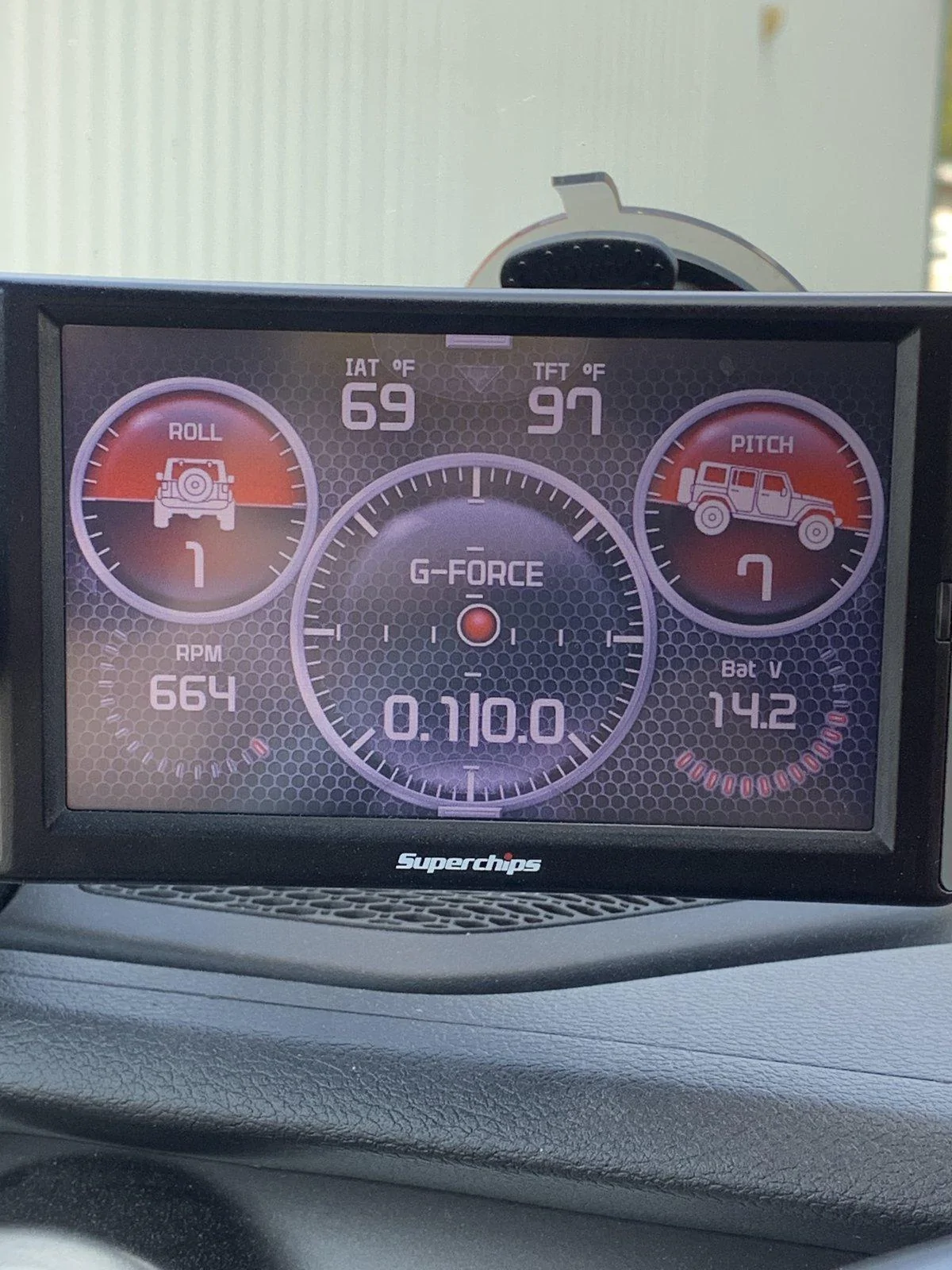

Sport S with Technology has pitch and Roll on the center cluster
