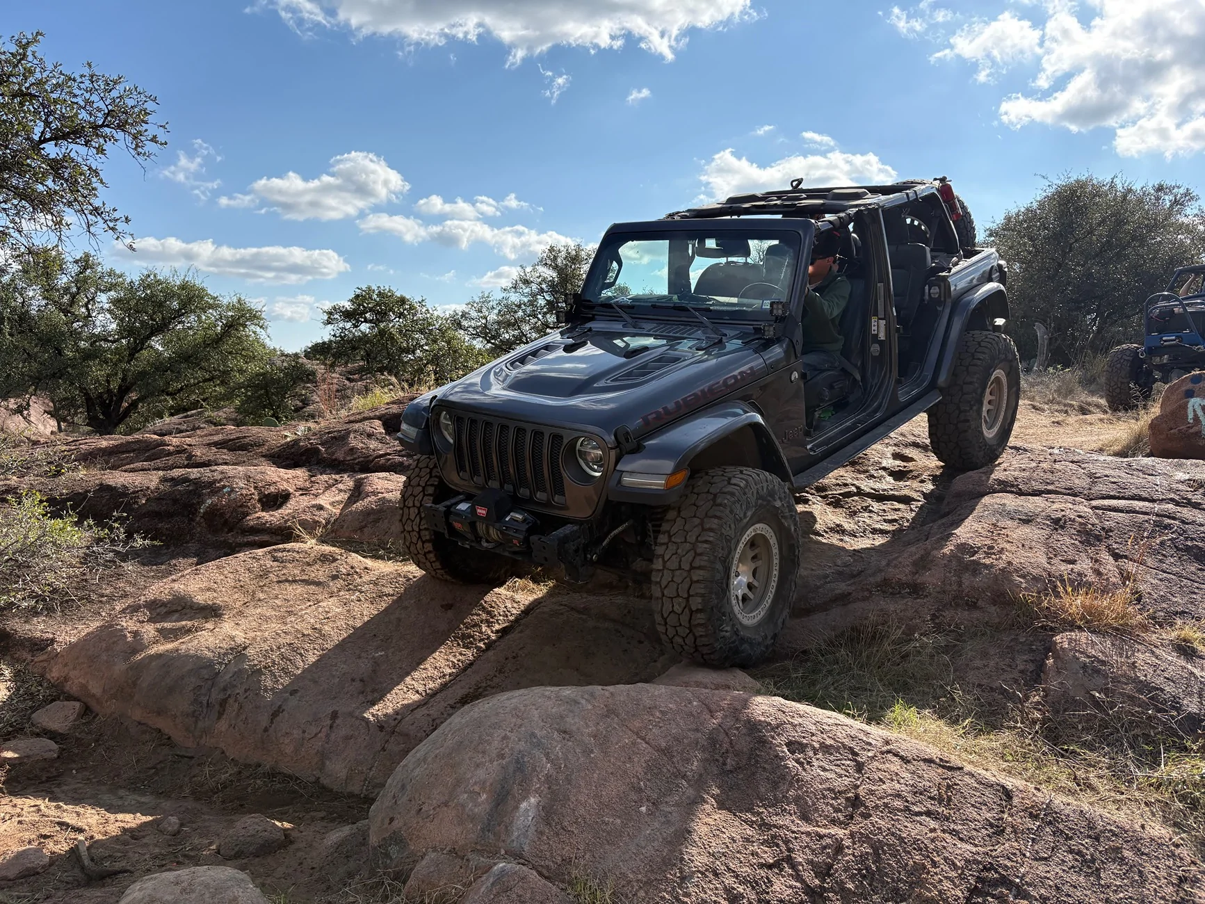

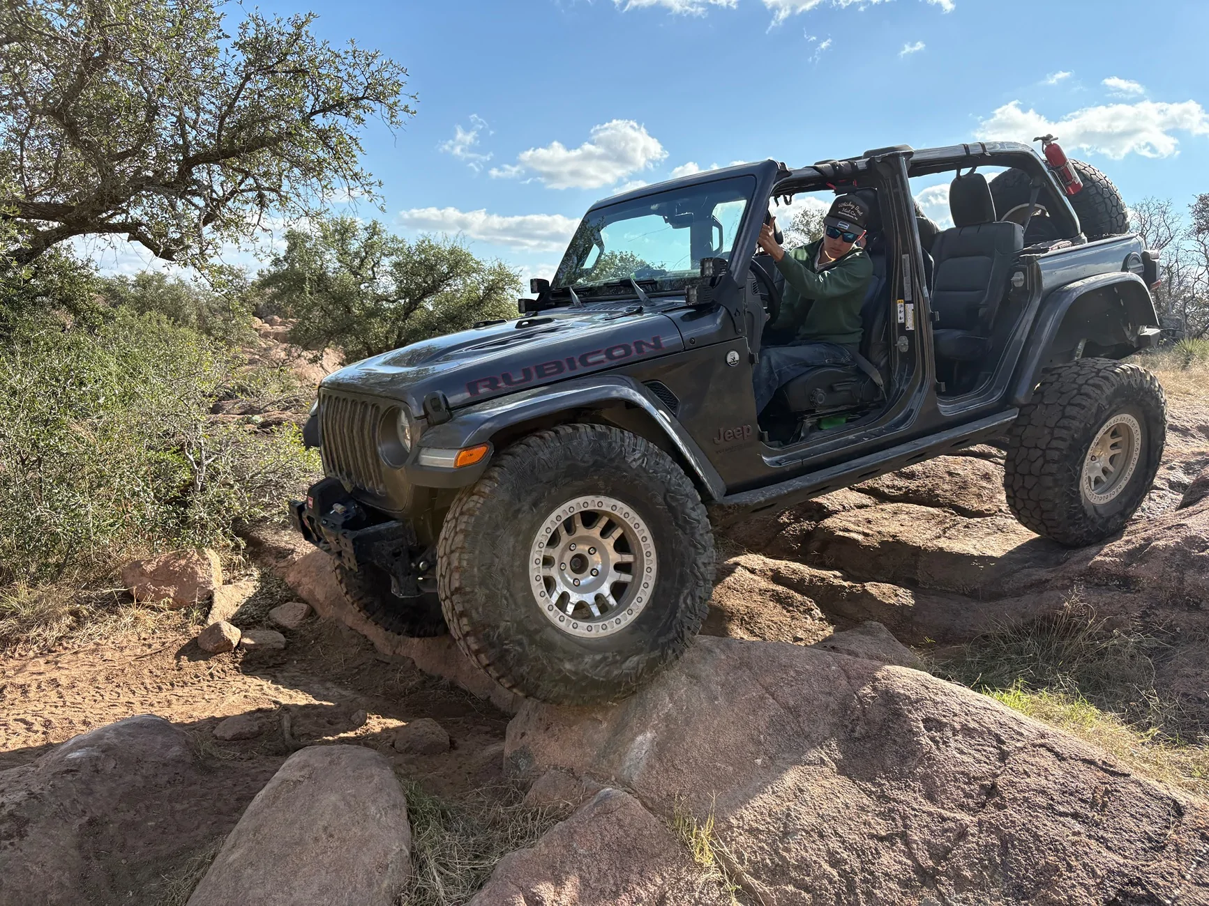

Got some good wheeling in Saturday 11/29. We were in a group of 3 as everyone bailed at the last minute. I got turtled once pretty bad. Had to use the roll cage off a buggy to lift the front end and get tugged out.

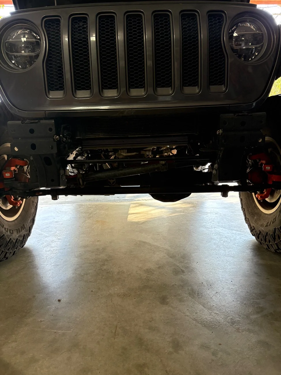

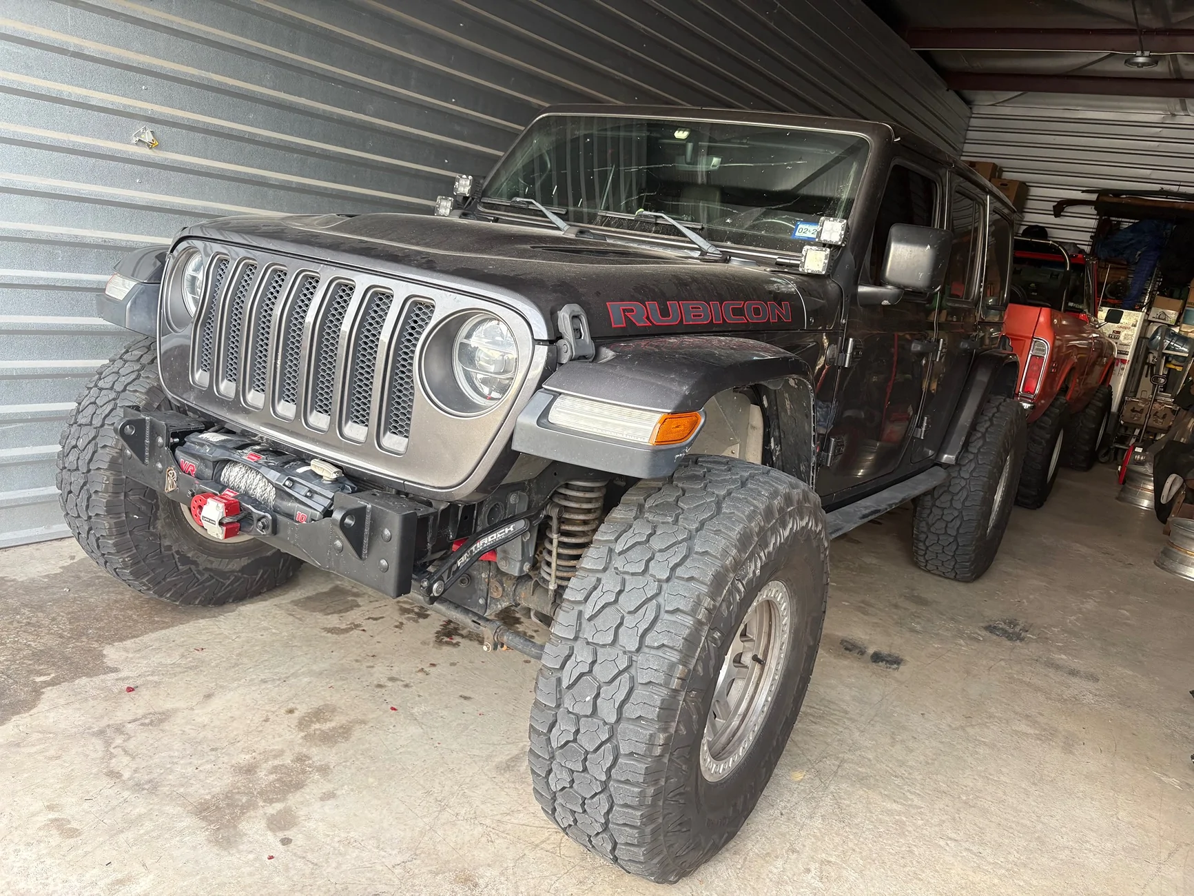

Figured my front frame chop has been sitting in the box too long so got to getting the old setup out of the way to make room for the @NextVenture frame chop. I would like to do the 5” but the 3” seems to be more realistic for my overall purpose. Cruised around over the weekend topless before tear down started.

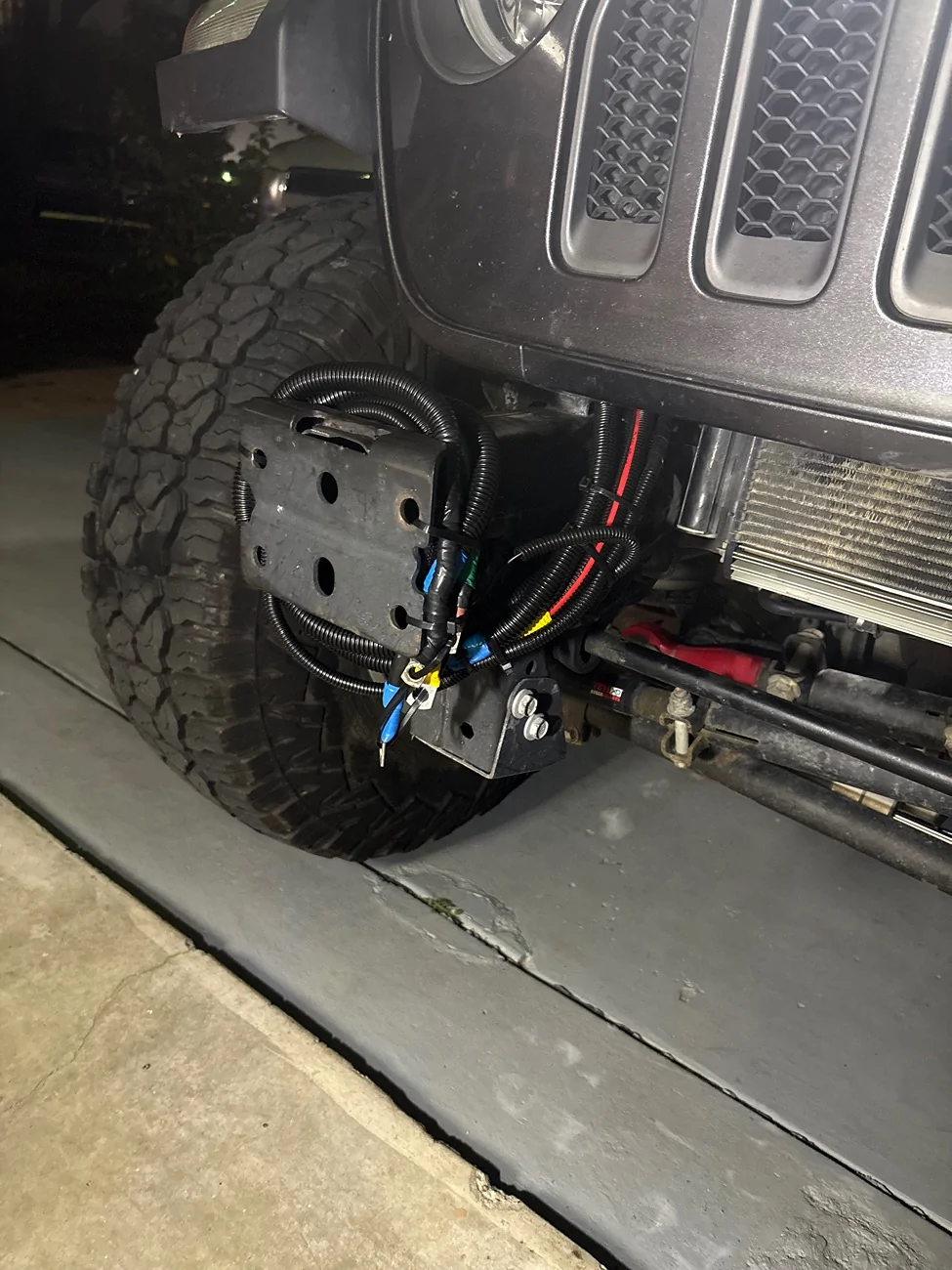

I put my steel bumper on my son’s JK so needed to remove the JCR winch plate and winch. Winch was also filthy so pulled the line. In the process, I took the solenoid control box off the winch to figure a relocation plan for it

The relocation of the solenoid took several hours. Mocked up a bracket for the driver side, FAIL. Pulled the passenger @CavFab_mfg inner fender, FAIL. Pulled the air filter box to check for clearance, FAIL. Pulled the battery to figure if I could cut the plastic box to run the battery the opposite direction, FAIL. Contacted @Kbach to see if he ever built custom boxes for the solenoid and appreciate the input he gave me. Finally, I decided to just throw the battery back in and start pulling my grille off to see if I could mount it behind there. As I put the battery back in, I realized I could push the battery over just a tad bit, clearance a bolt on the fender, and this would allow me to wedge the factory warn winch solenoid box in there. The wiring out of the solenoid will clearance just enough to slightly imprint on the hood insulation. Ran to get some wiring and within a few more hours, I had the wiring routed and ready to go once the bumper is finished up. The plan is to knock it all this weekend. The wiring worked good with no issues yet.

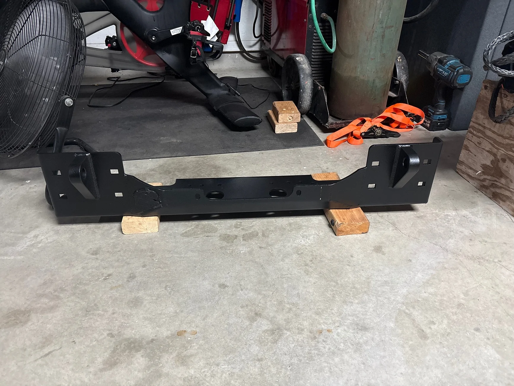

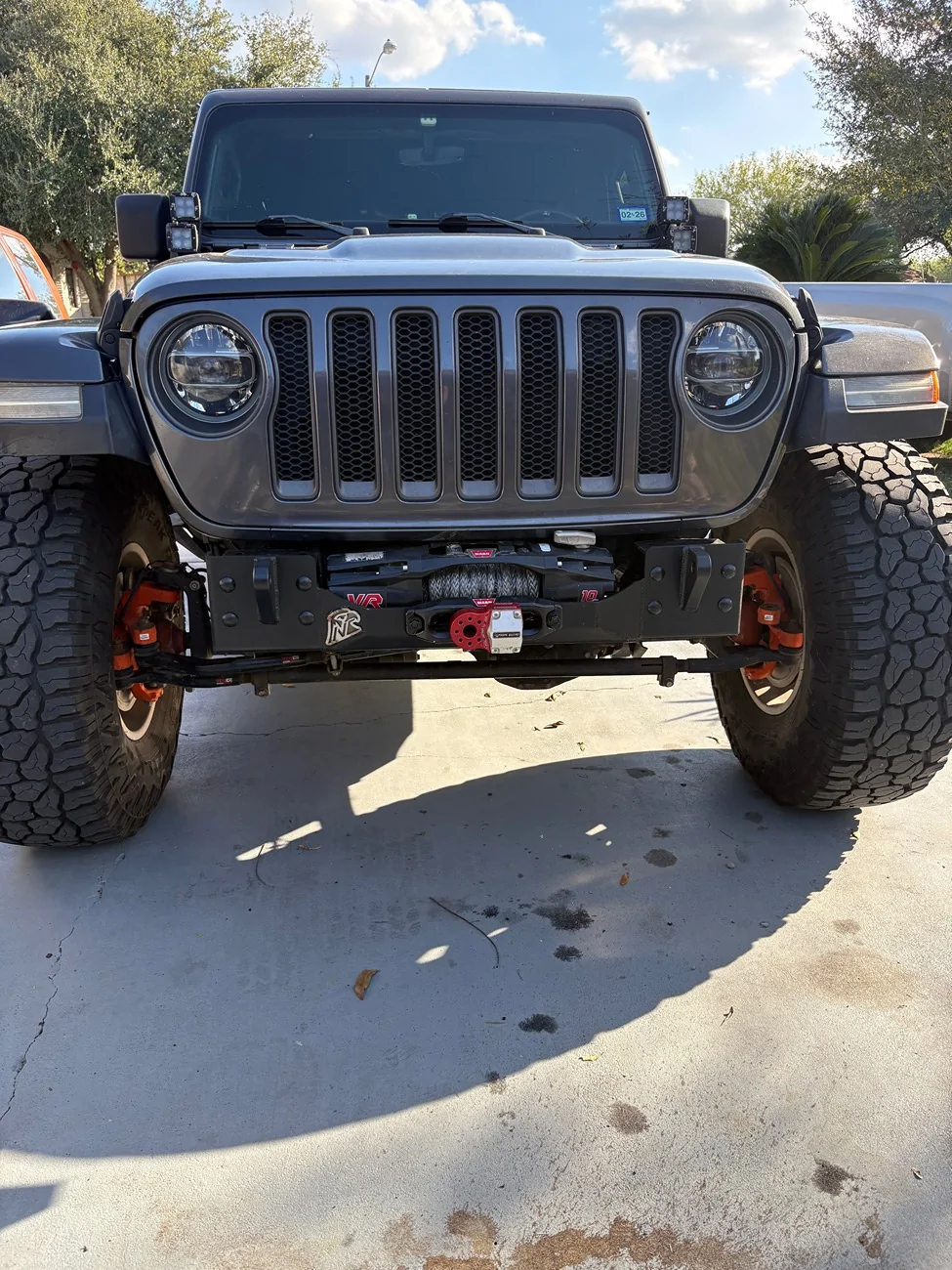

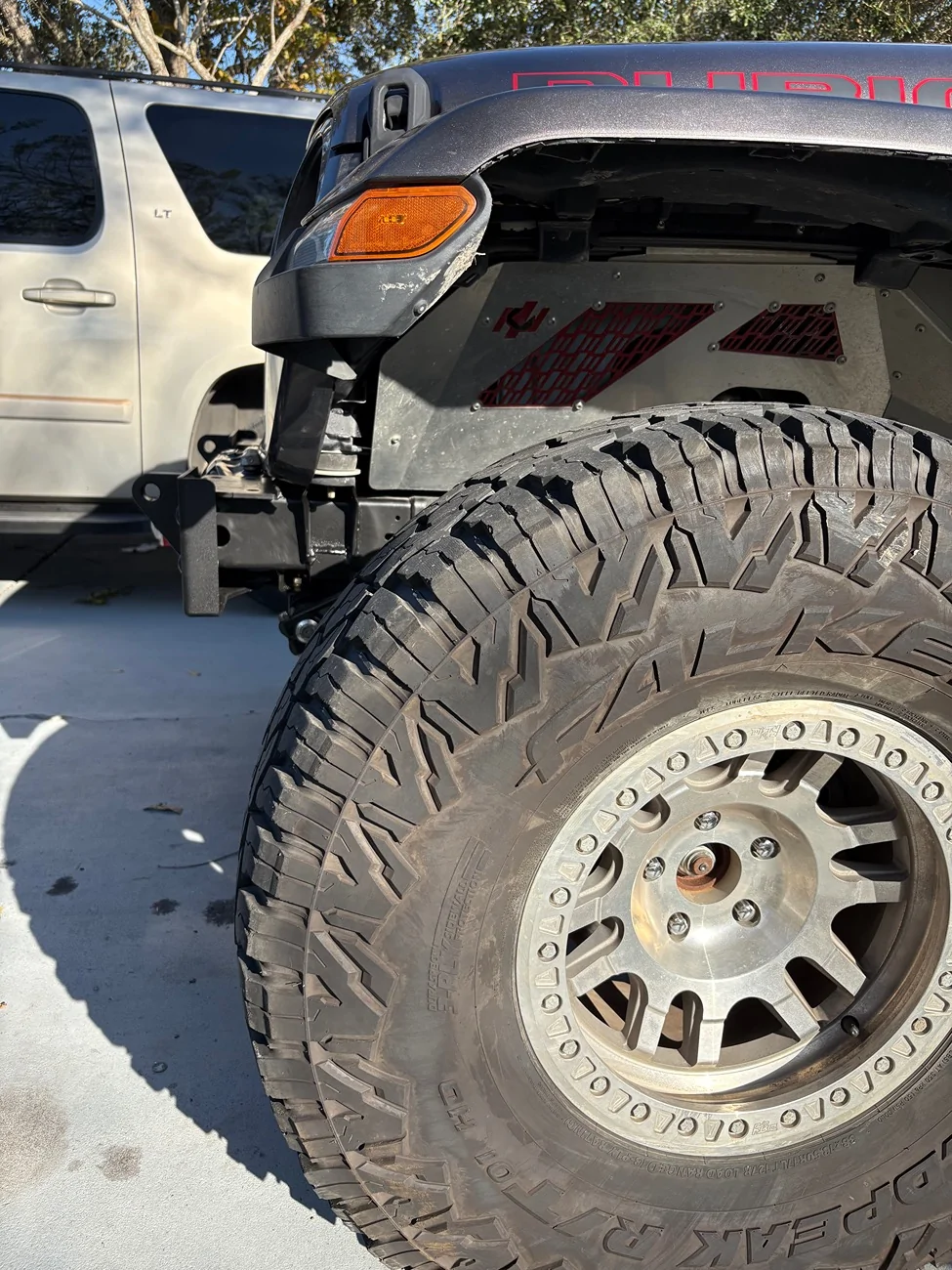

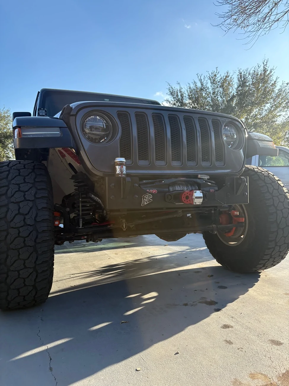

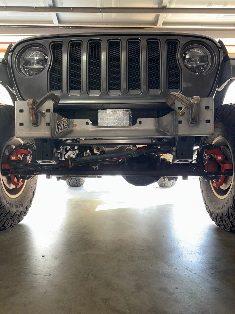

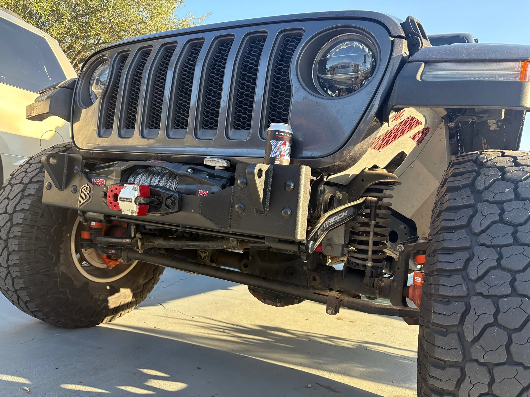

Finished up the bumper yesterday. What a pain in the ass. A lot of tedious work. Not sure I’d recommend this over the EVO front frame bumper that seems to be a bolt in. Overall I’m happy with the product and outcome, just definitely a lot more than I anticipated.
@NextVenture front frame 3” chop done. I feel it looks a little incomplete without the hoop, so planning to add it down the road.

Looks very solid, but yeah, I can see how that took time. Nice work, though!
