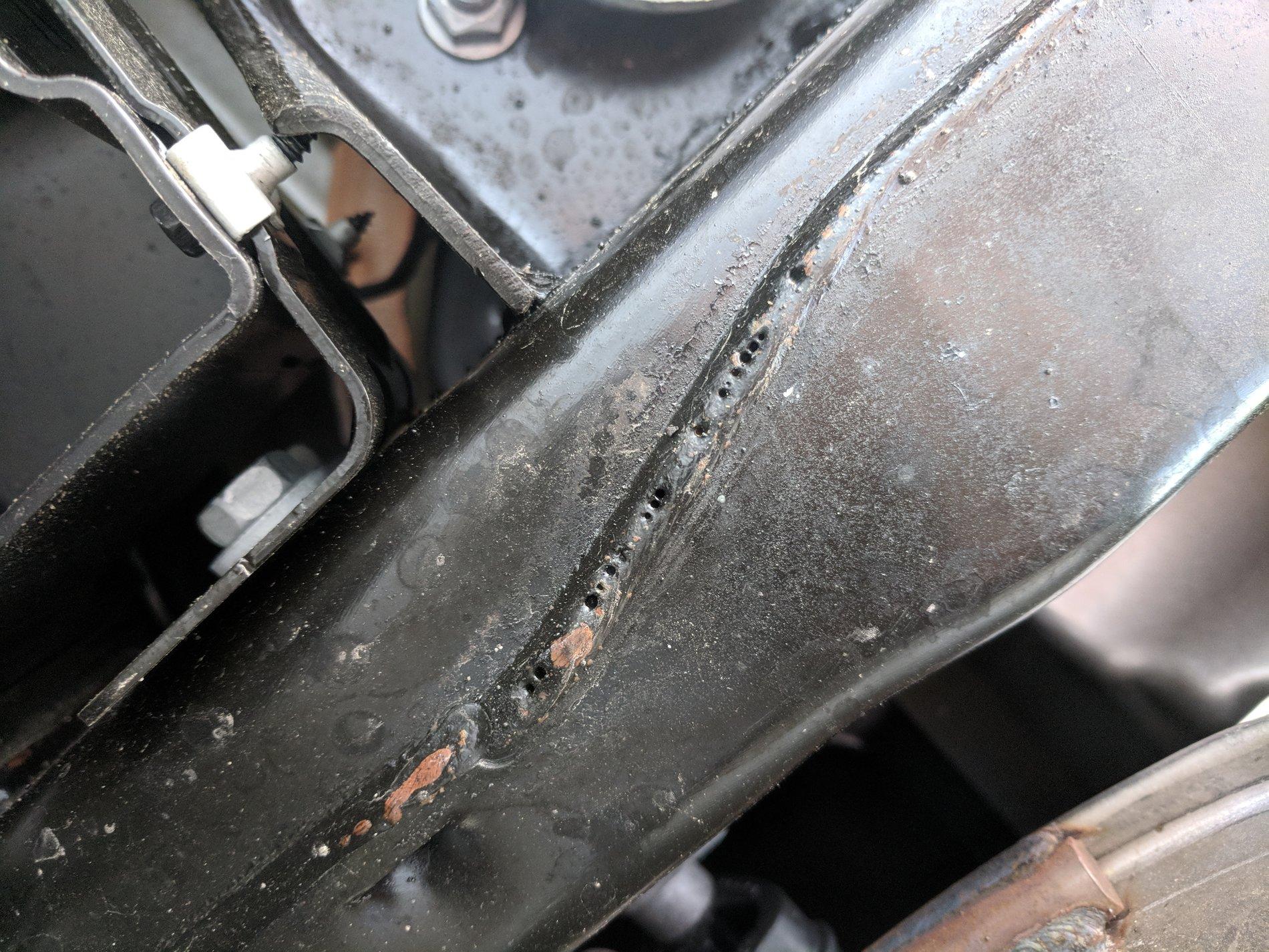

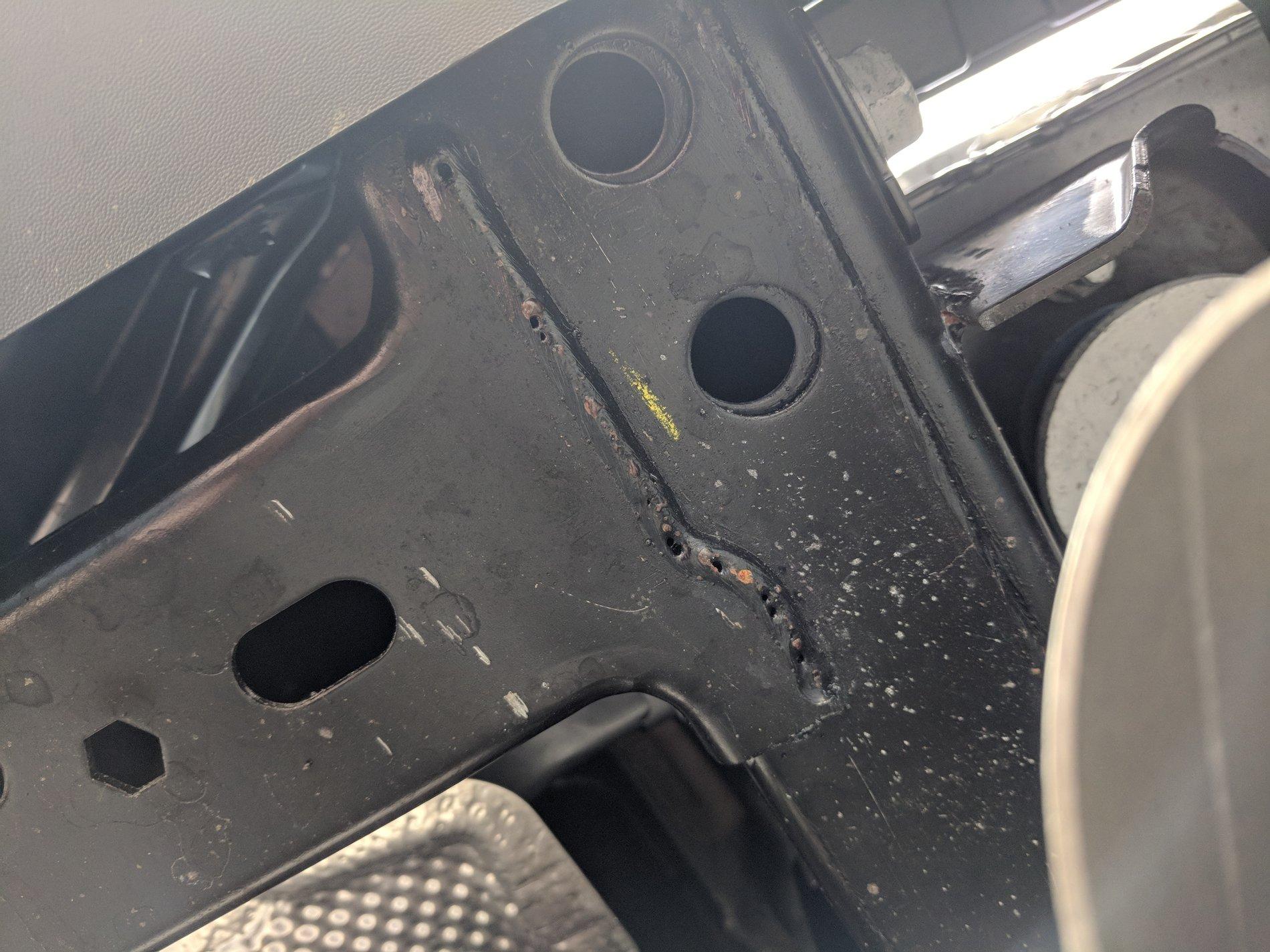

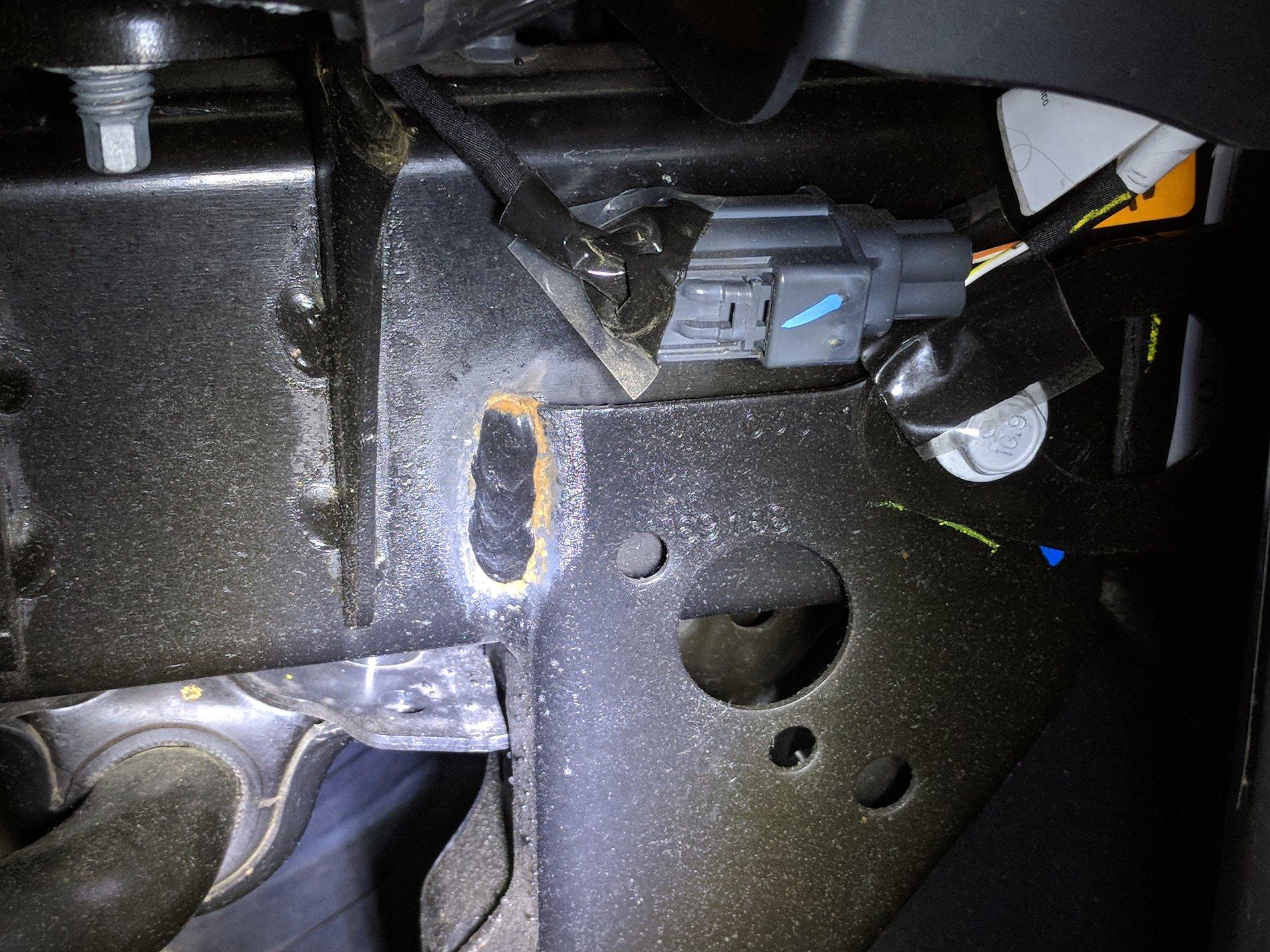

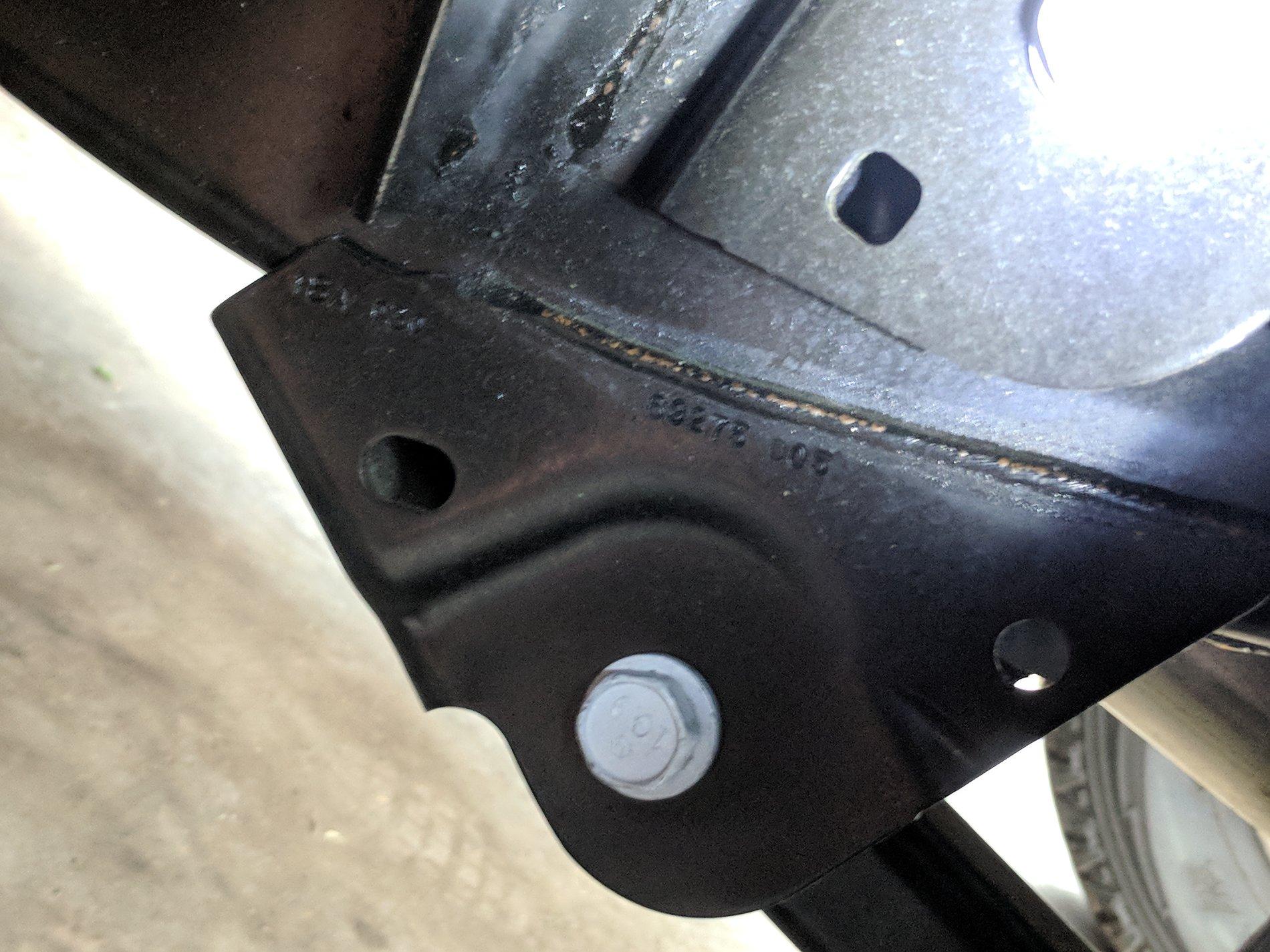

I mean wasn't terrible for the most part, but enough that I felt a brand new car shouldn't have!

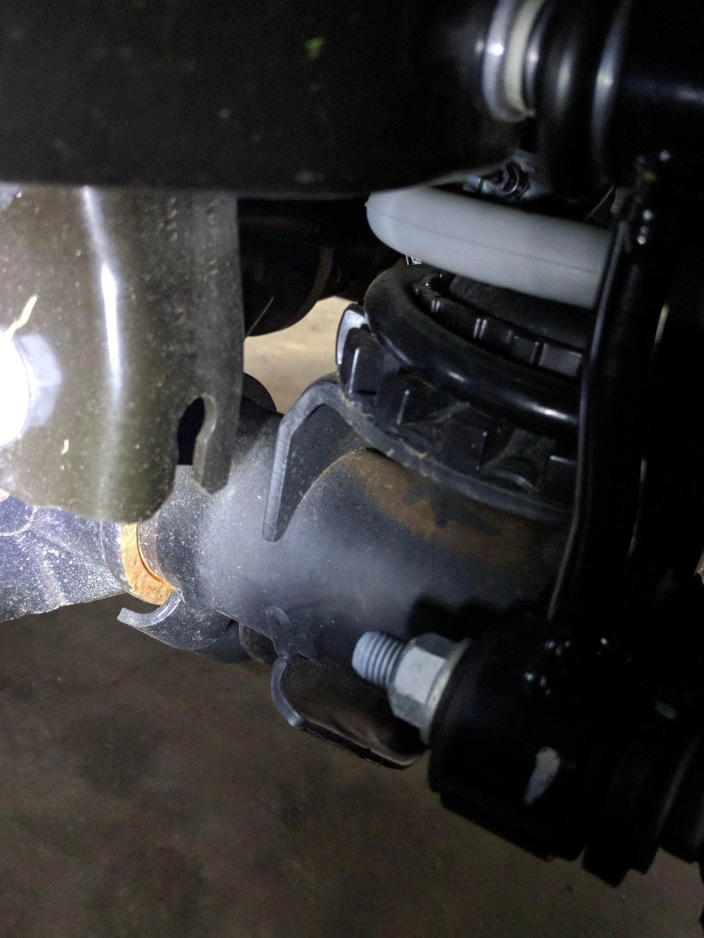

There was rust on the front axle as well, which I'm sure is inevitable, but still...
The pic with the bad porosity was on the frame close to the back bumper flanking the muffler.

OK... so the top picture, yuk. That is a problem others have seen with holes in the actual weld. I don't have that and you can see that is really rust, The second from the bottom pic is exactly what I have and it's not rust. It is a shiny orange color that looks like rust. I even sprayed it w a rust converter and it did nothing to it (should have turned it black).
Regarding the rust on the axle, I have it too. I agree, shouldn't be there but it is what it is and it's from lack of paint (prob trying to save $). At least the drive shafts aren't rusting, they coated them compared to the JKs. The JKs completely surface rusted in months.
They had a Sport S that had just come in and it seemed to have some of the on-weld orange, and also had some porosity like the last two pics. Not as bad, but it was there. Just seems odd to me!

The orange on-weld does seem odd until you research it and see it is on other brands as well. It's something to do with how the slag isn't completely removed from the weld.
