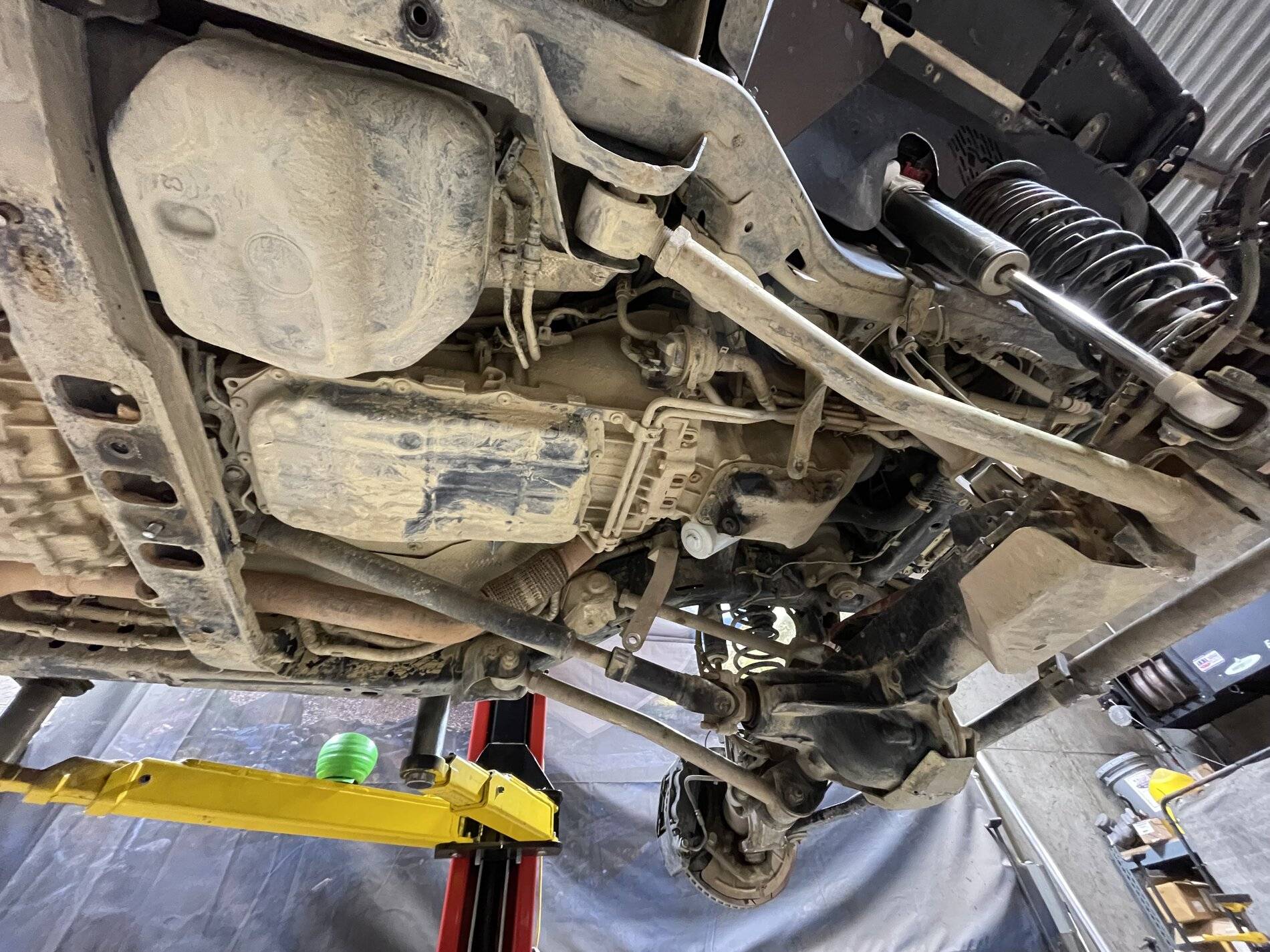

Before the fun could start the Metalcloak Undercloak skid plates needed to be removed. This exposed a couple years of grime and accumulated filth from some excellent rides. A wonderful mix of Appalachian clay and red dirt from Utah. So many good memories.
Nevermind that leaky pinion seal...these are not the droids you're looking for...

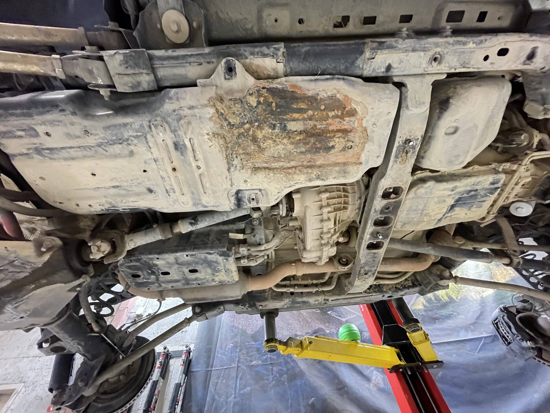

When we dropped the tank (needed for bracket removal) we found some more proof that our little Jeep has seen some trail work.

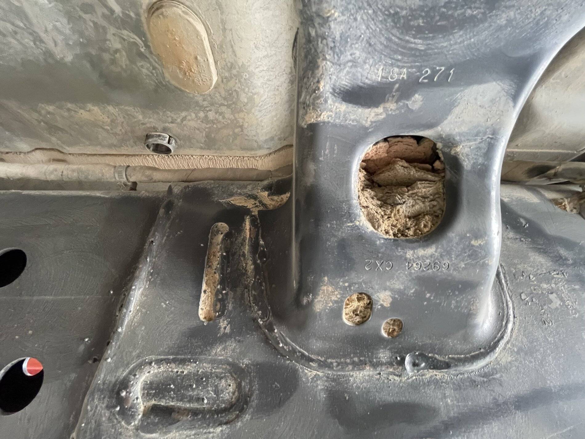

While the tank was out, I emptied the frame of some of the compacted mud and soil...There was no way to clean this with tank and skids installed.

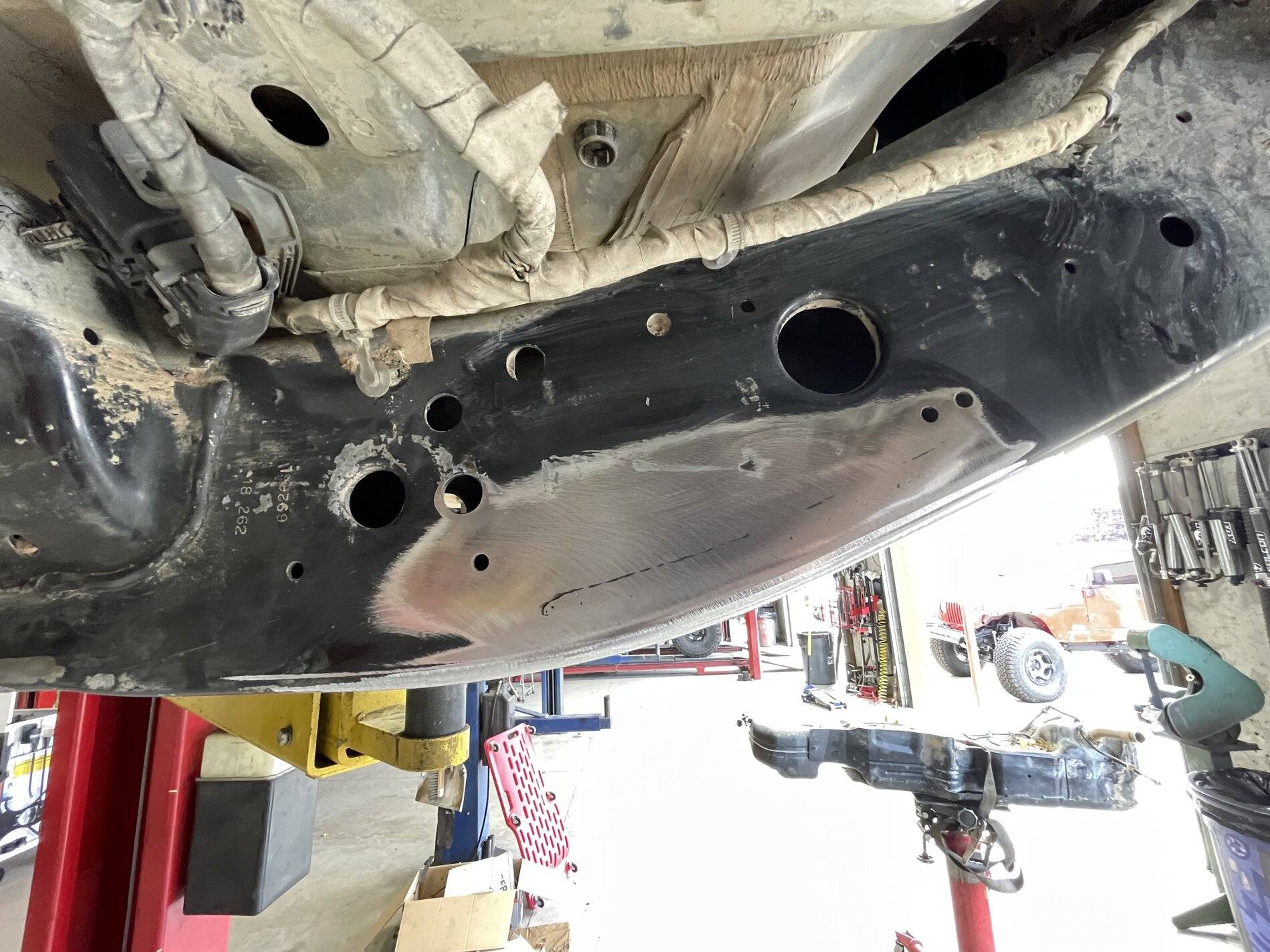

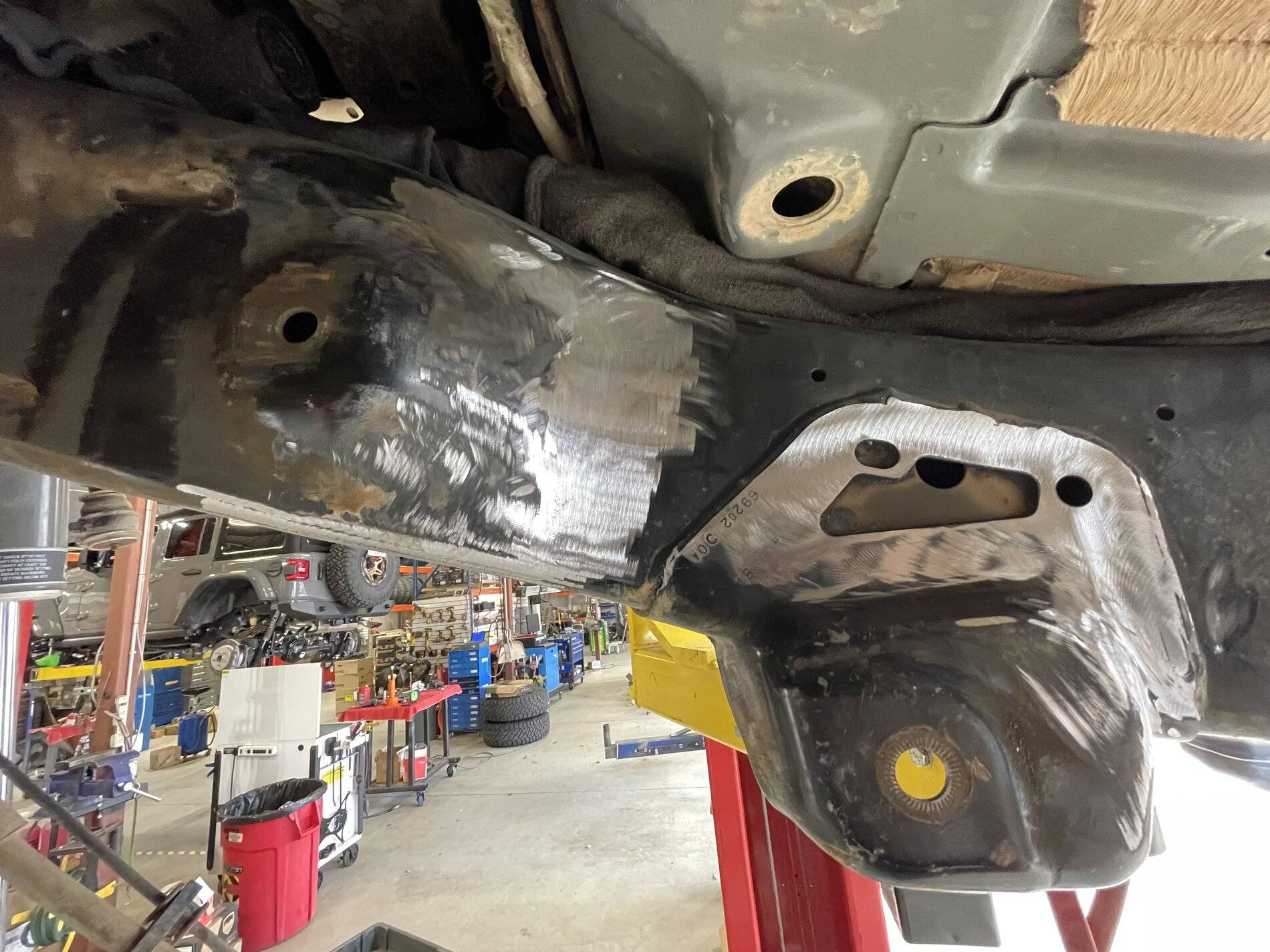

Bracket cutting
Front brackets gone and frame cleaned up
Rear brackets have left the group chat and frame is cleaned up

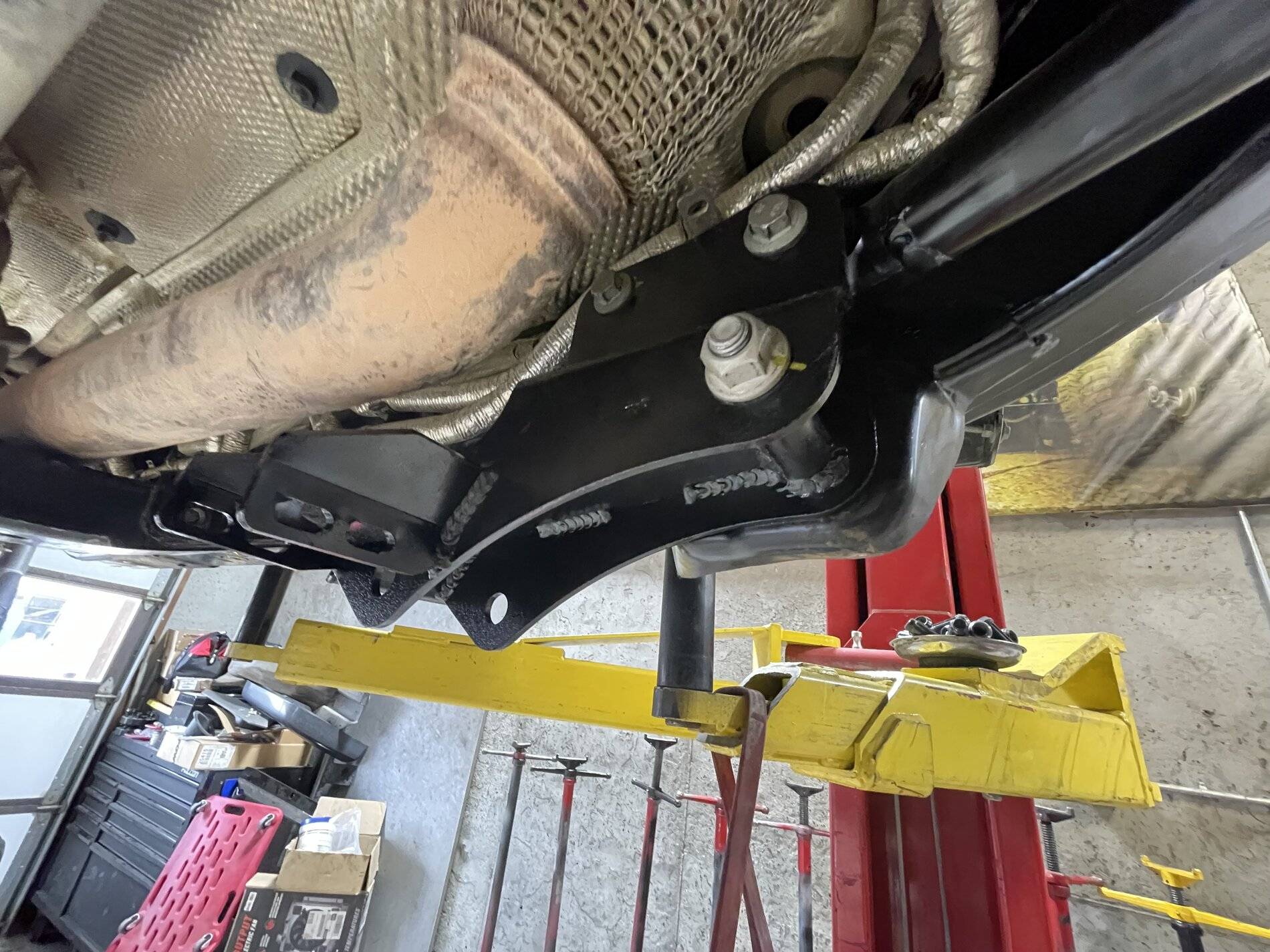

New link brackets ready for install
Front brackets installed. You can see that the outer half of the front lower link mount is retained for the new long arm brackets.

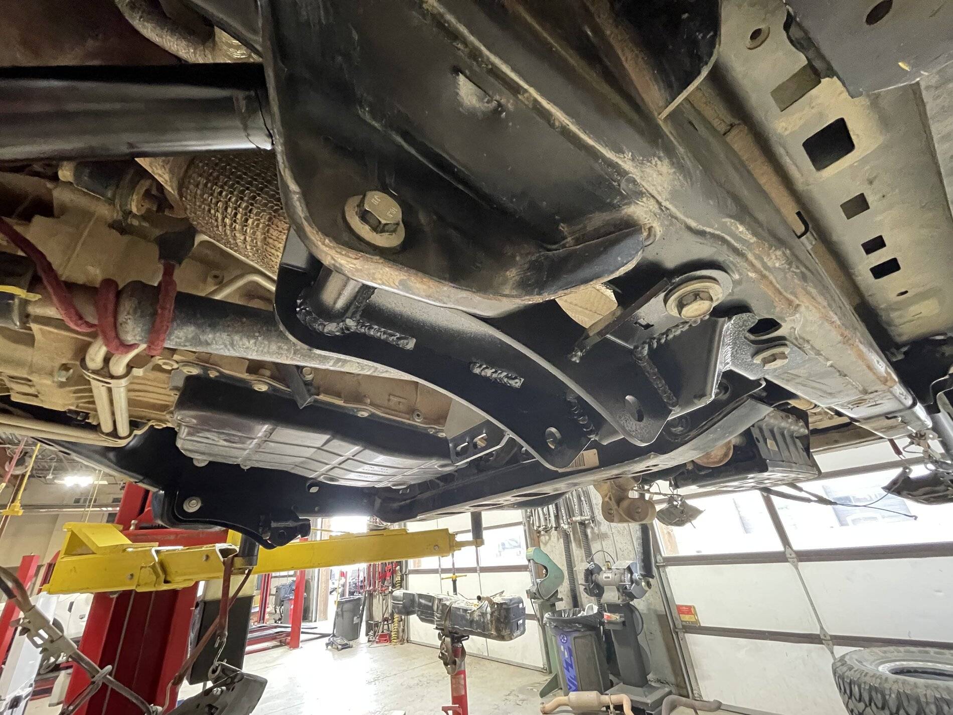

Look at how far the upper mount is pushed back
The rear upper mount is changed even more...
