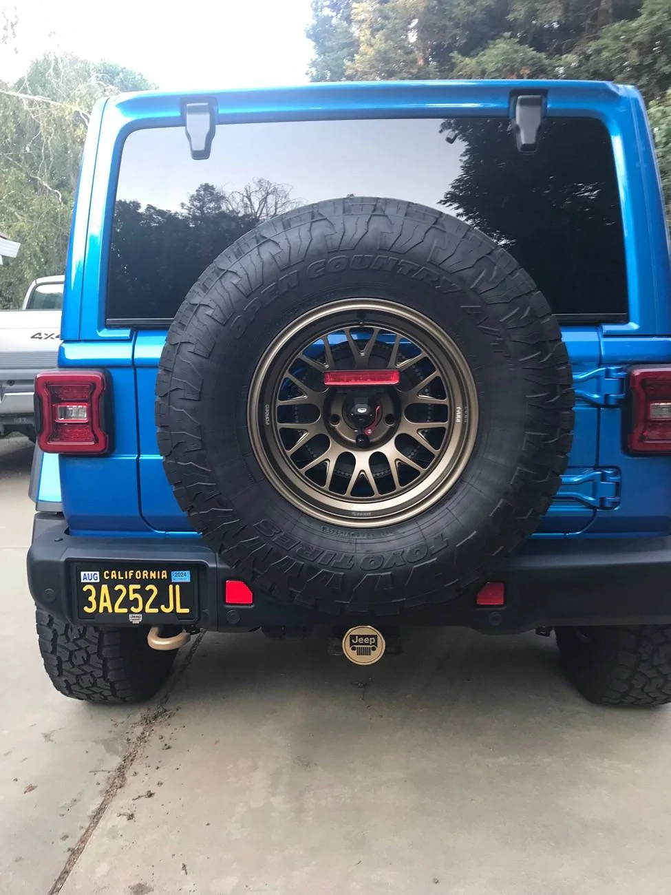

Not a fan either, but it’s a lot better than the stock one sticking up blocking the window. I had removed it and only using a QT PNP light ring before getting it. Presently running both, but looking for a way to plug the wire hole on the camera stalk to keep debris out. I ordered a 5’th center cap to drill out to fit over the stalk. If it or an alternative covers most of the stalk hole , back to just the ring.
I am getting used to it. Not bothered as much by it anymore and could live with it if no suitable stalk hole cover/plug found.

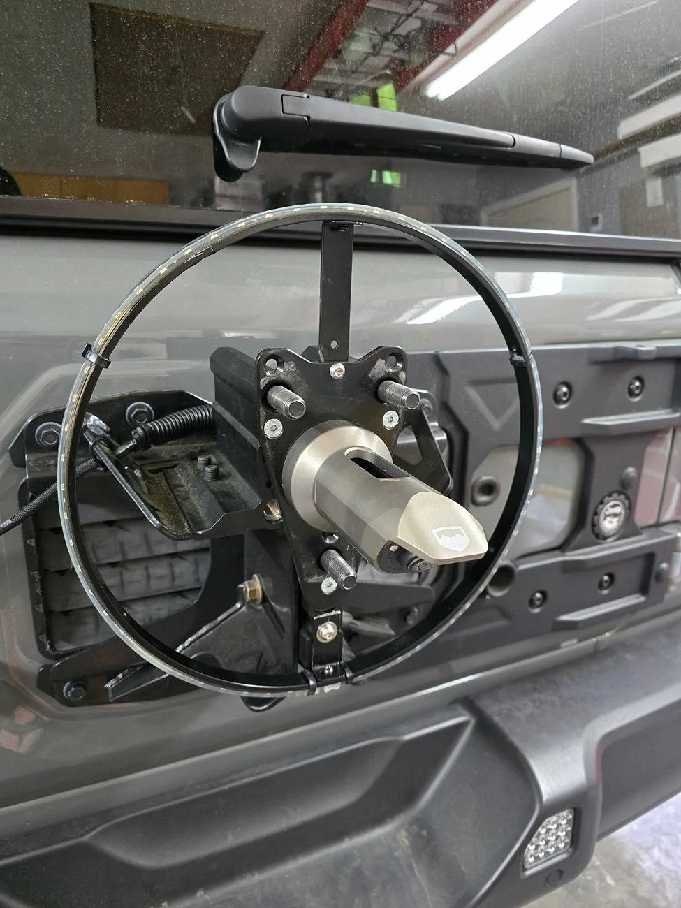

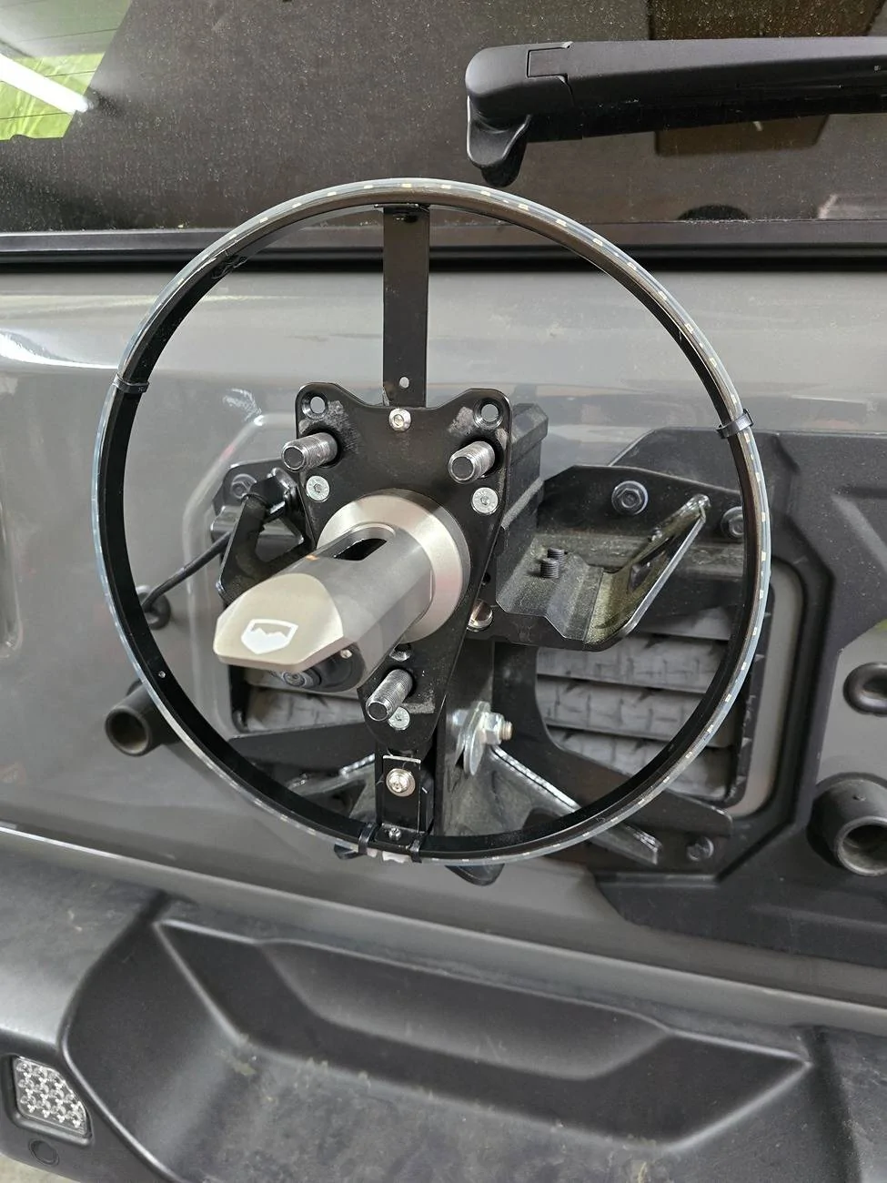

I have an Oracle light ring installed on my Teraflex. It took some modifications to mount it but it was pretty simple. I also have a Rugged Ridge ring that was on my wife's Jeep that I have listed for sale here if you're interested. You could tap it into the existing wiring and also leave the plug for the stock light to be installed just during inspections if you feel the need.

Thanks! Most of the light rings would just drop in place but the Oracle is supposed to use 3 metal brackets that get screwed into the OEM carrier. I like how open it is since my wheel is also fairly open, so I made it work by shortening two of the brackets and moving them into different positions (there are multiple threaded holes in the ring), then using an M6x1.0x20mm screw into a threaded hole in the carrier and drilling a hole in the top for a bolt/washer/nut to hold it. Looks even better that way I think!
Definitely a creative solution on your end. I'm assuming the bolt heads don't interfere with the wheel center sitting flush against the carrier? I have stock Rubicon wheels and if I did this workaround that would be my only concern. Also it seems like most of those ring lights have a section stop working but people keep driving with them, how's the oracle quality held up so far?

The lower mounting point is slightly recessed from the wheel mounting surface. The upper point I drilled pretty close to the edge of it and the wheel has recessed pockets and that clears that bolt head. You could probably use a tapered bolt and countersink it if you wanted as that plate is pretty thick, but I don't it would be necessary with most wheels.
I've had zero issues with either the Oracle or the Rugged Ridge rings, both in use for about 3 years.
