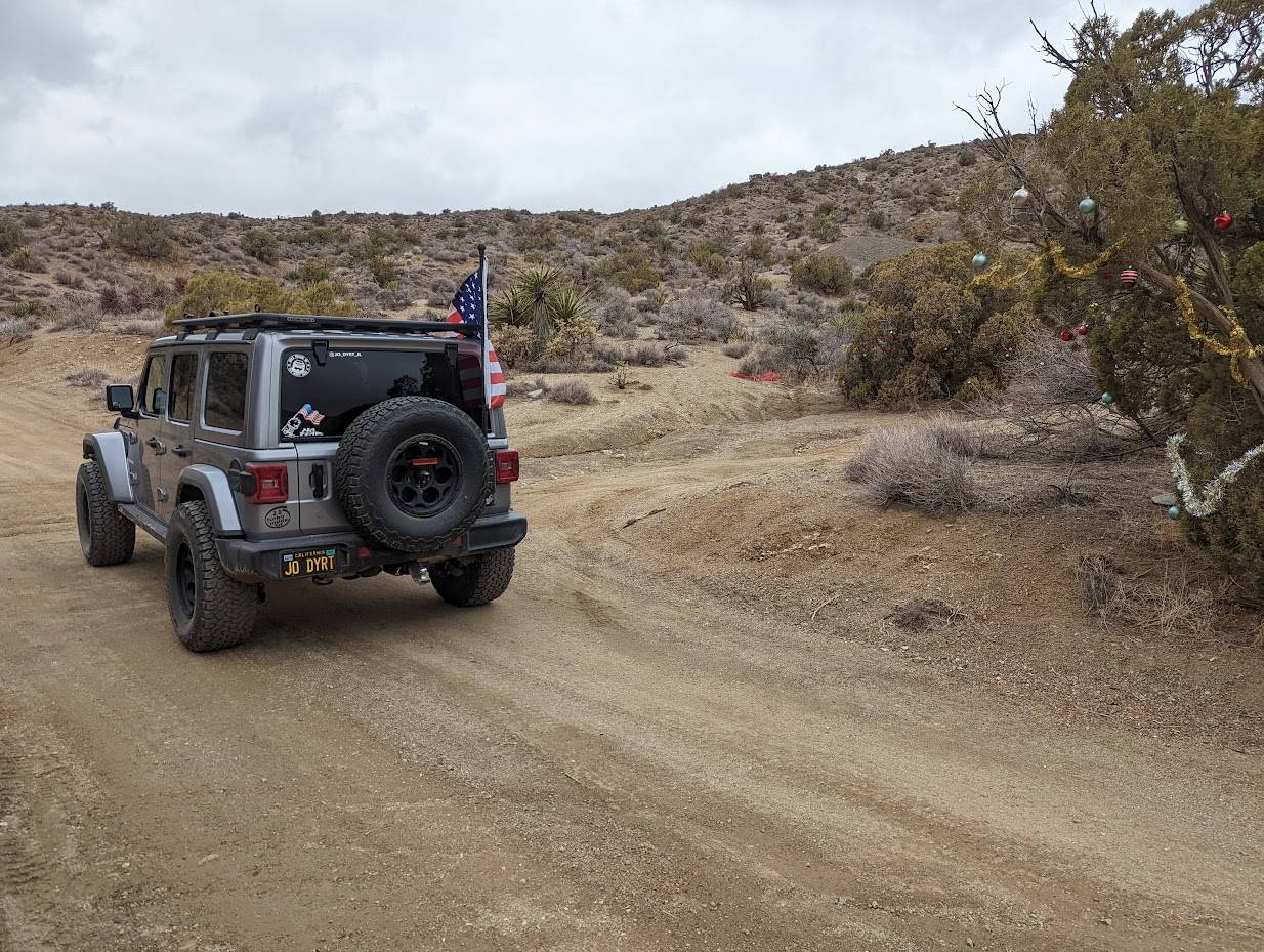

I have both Teraflex units on mine and I have the teraflex 3rd brakelight and a $60 Amazon LED brake ring behind my spare. I have had zero issues and it is not that big of deal to unplug the 3rd brake light.

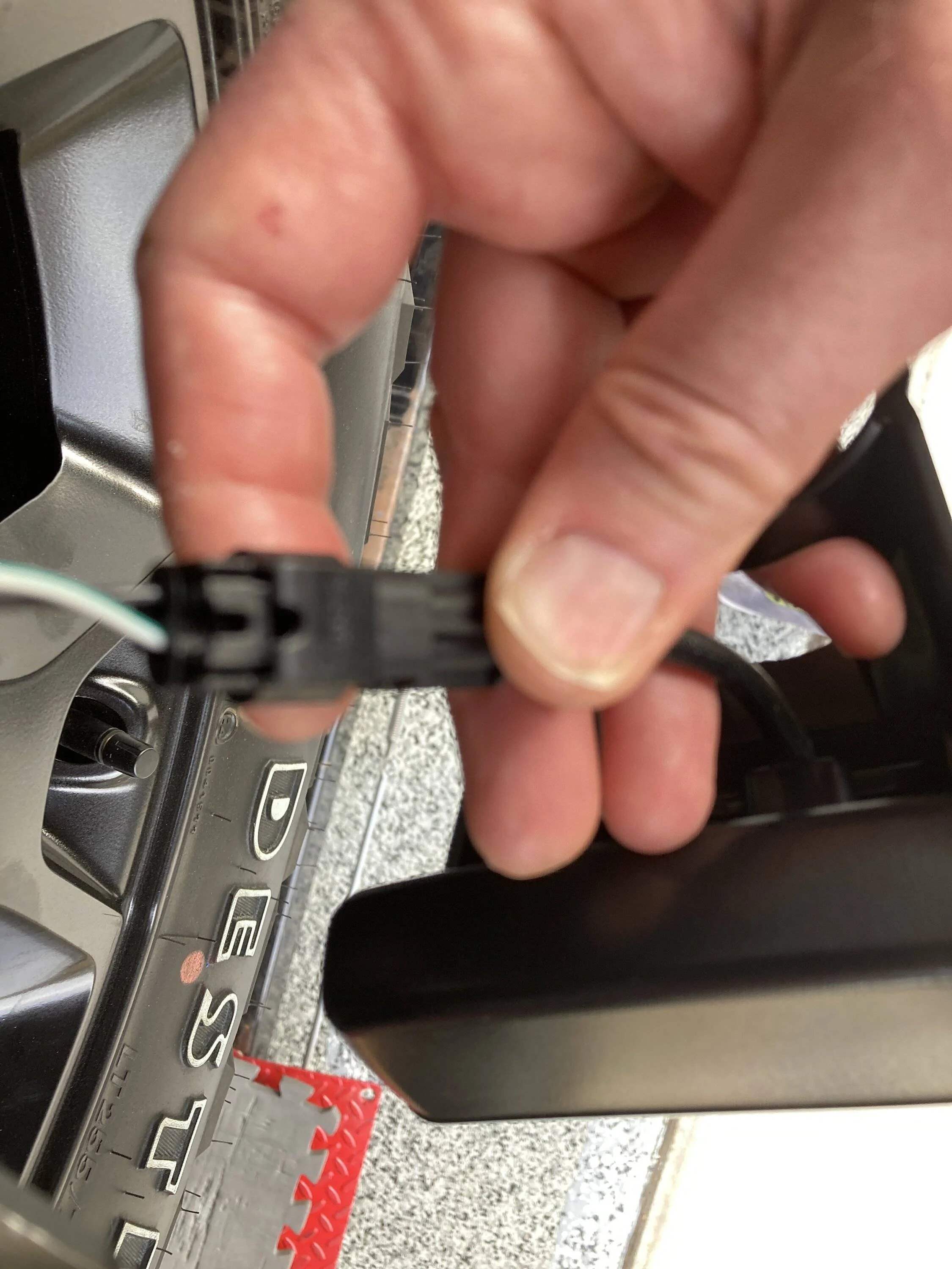

...unplugging the light it isn't a big deal for me and it is pretty quick and easy to do. ...
Can you describe how you disconnect the Teraflex third brake light set up? Mine does not seem to want to disconnect, and Teraflex's directions do not cover this well. I'm not sure if mine is stuck or I'm doing it wrong. thanks
Are you referring to unlatching the assembly or unplugging the electrical connection?

I think that may be my problem since my wires don't come out available like that. I may have routed the wires through the spare carrier wrong. Hmm. I have a new wire loom to do this again and probably need to figure out the correct wire route out to that 3rd brake light.
and thanks Scot for the photo

I pulled the high mount brake light wire through the area where the camera is mounted and then pulled it out the top gap by the camera.
