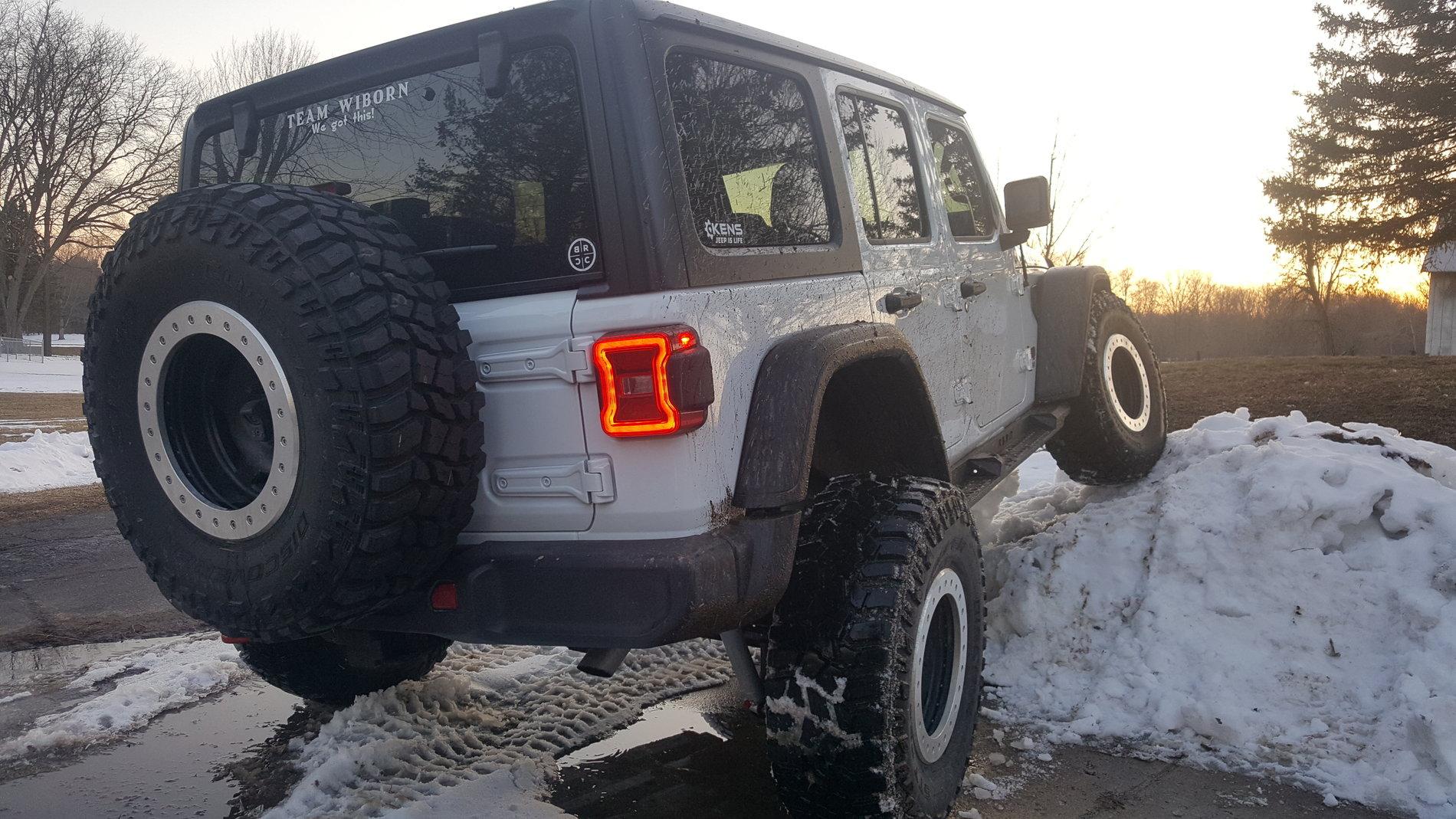

You can always buy a take off stock Rubicon tire carrier. It will fit easily hold a 35 in tire. The rubicon one is taller than the Sport and Sharra tire carrier. Here is a pic of my Rubicon using a stock Rubicon tire carrier with a 37 on it. It is tight, but it fit. You may have to extend your rubber isolators, but that is easy. I sold my rubicon tire carrier for 60 bucks when I upgraded.
