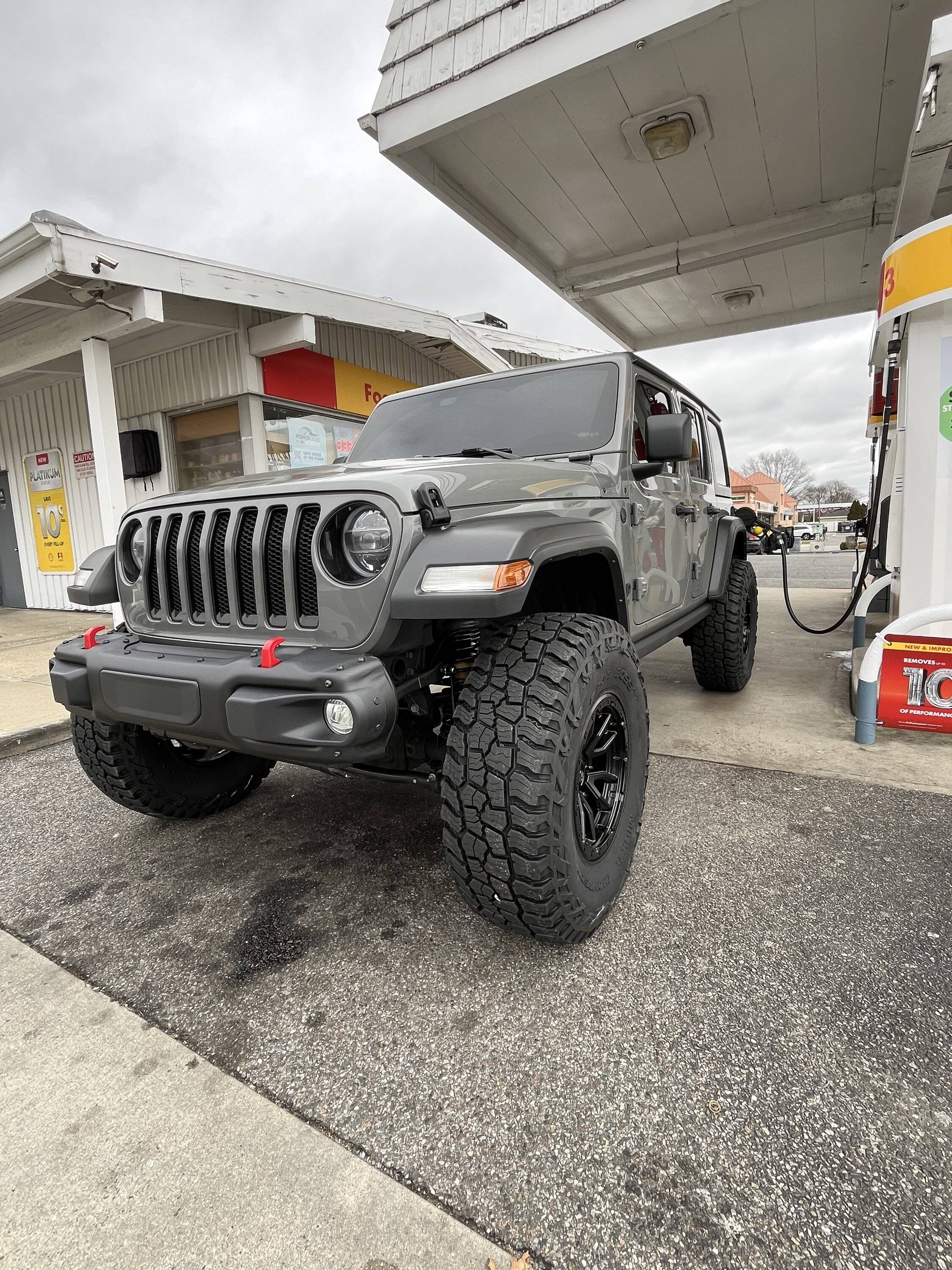

Hey everyone. Looking for knowledge from people who have the tazer in their Jeep. I have a 21 sport altitude with 3.5” lift and 37s on stock 3.45 gears (for now). Obviously my shift points are a lot higher from the tires and the vehicle won’t go into 7th or 8th gear on its own anymore so i bought a tazer to let my jeeps computer know it has 37s and could adjust its timing accordingly. After install and setting it up, i noticed at lower speeds below 50 my jeep would shift easy and feel good like it did when it was stock. But at highway speeds she still doesn’t like to go past 6th gear on her own. So i guess my question is those who have the tazer jl what’s your experience with shift points and adding bigger tires on there? Will my jeep shift like a stock wrangler if i have the tazer PLUS a regear? Or if i have a regear do i really need the tazer?
