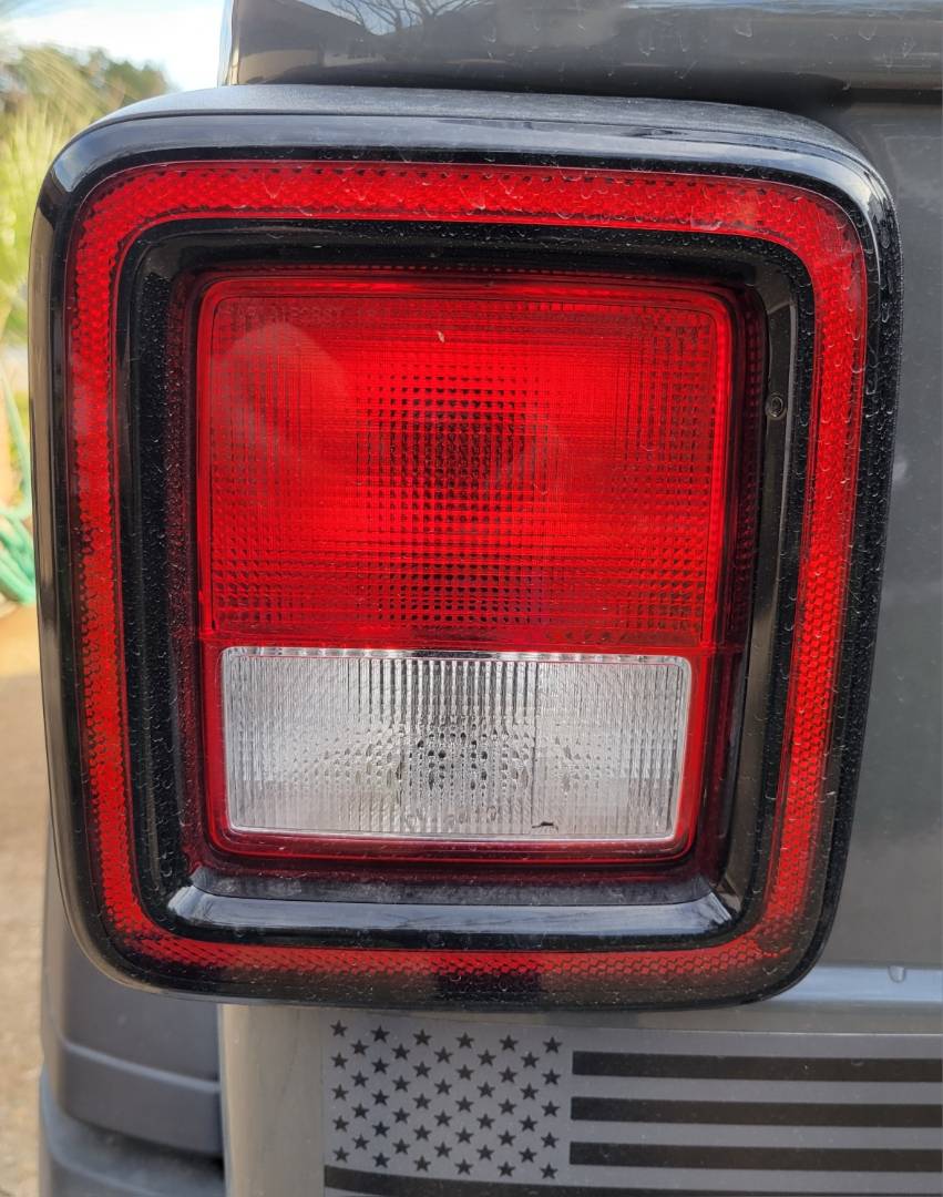

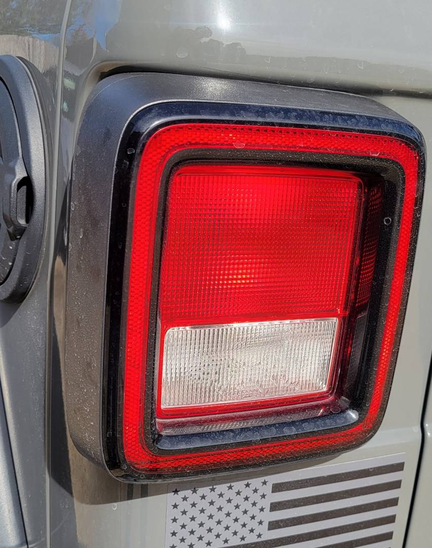

I have a 22 Jeep Wrangler. I keep getting water inside the Left Taillight Assembly. Predominantly the backup light, sometimes a little into the brake light. I have dried it out thoroughly with heat gun on low setting after disassembly. I made sure to lubricate the lightbulb seals with silicone grease. I noted this is only the Left side that has nothing to protect from water being kicked-up from Left Rear Tire around Fuel Fill Tube. There was enough water to get the lightbulbs to get a white cloudy condensation on them that would eventually get into the connections and burn-out the bulbs. I use silicone grease on bulb connections too. (Make sure to clean glass of all grease when done.)
* This is second time I had to dry the Left taillight lenses assembly out. Anyone else see this? :headbang:

Note: This is only the Left side that has nothing to protect from water being kicked-up from Left Rear Tire around Fuel Fill Tube.
I talked with a Friend, with similar Jeep, and NO PROBLEM because he has AFTER MARKET LED Taillight Assemblies that are SEALED.
Right side does NOT have the problem because not exposed like the Left.

Only thing I have found is how the Left is exposed to water kicked up off the tire around the gas tank fill neck. I used a heat gun to totally make sure light assembly, was dried out last time, and silicone grease on the lightbulb seals. After just a light rain water again in the Left taillight and getting worse quickly as we get some heavy rain here on Gulf Coast.

Yah, last time I removed the L taillight assembly to dry it out, it had a LOT of water in it too.
Other than the Left side being exposed to water kicked up off the tire around the gas tank fill neck, I don't see how just change in weather for condensation or where there is a leak in the housing somewhere? Mind you I live on the Gulf Coast and we normally have heavy rain. But this is the first year I have noticed a problem like this on my 2020 Jeep Wrangler Sport JL. :headbang:
Like I had explained, a Friend with similar Jeep has LED taillight assemblies and no problem. It is also a four door model vice two like mine.
