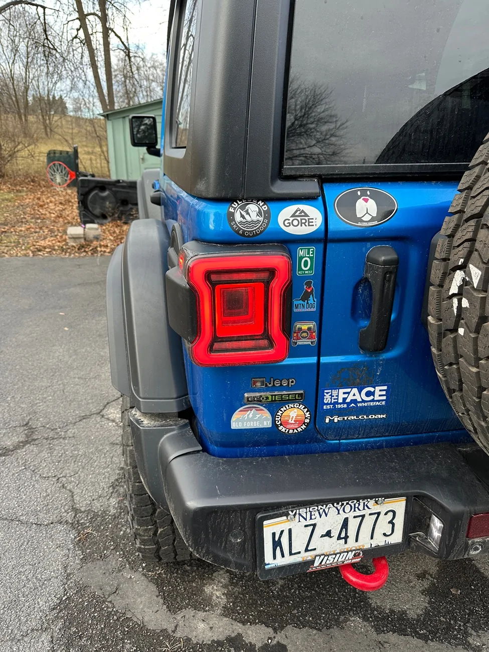

Jeep Wrangler JL OEM LED Tail Light Replacement Question IMG_8986
