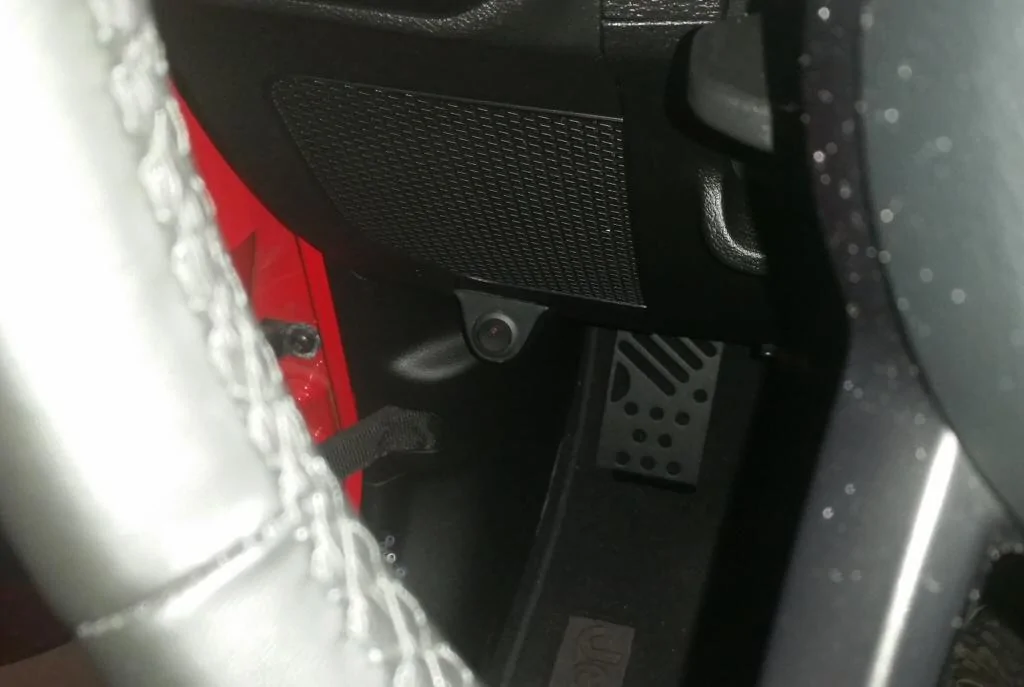

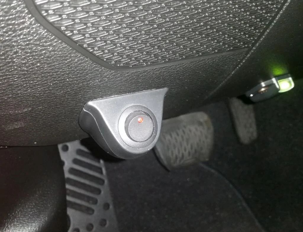

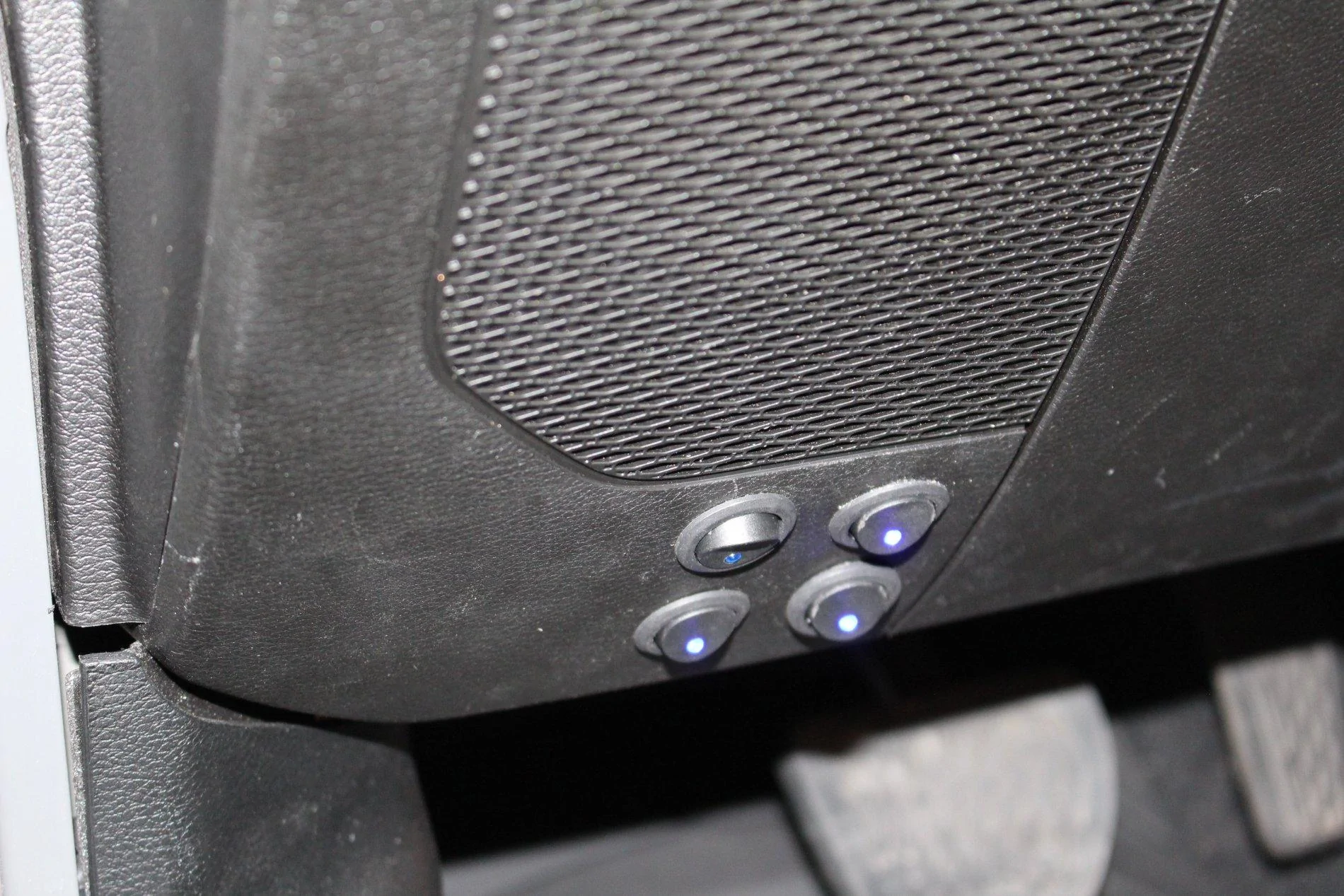

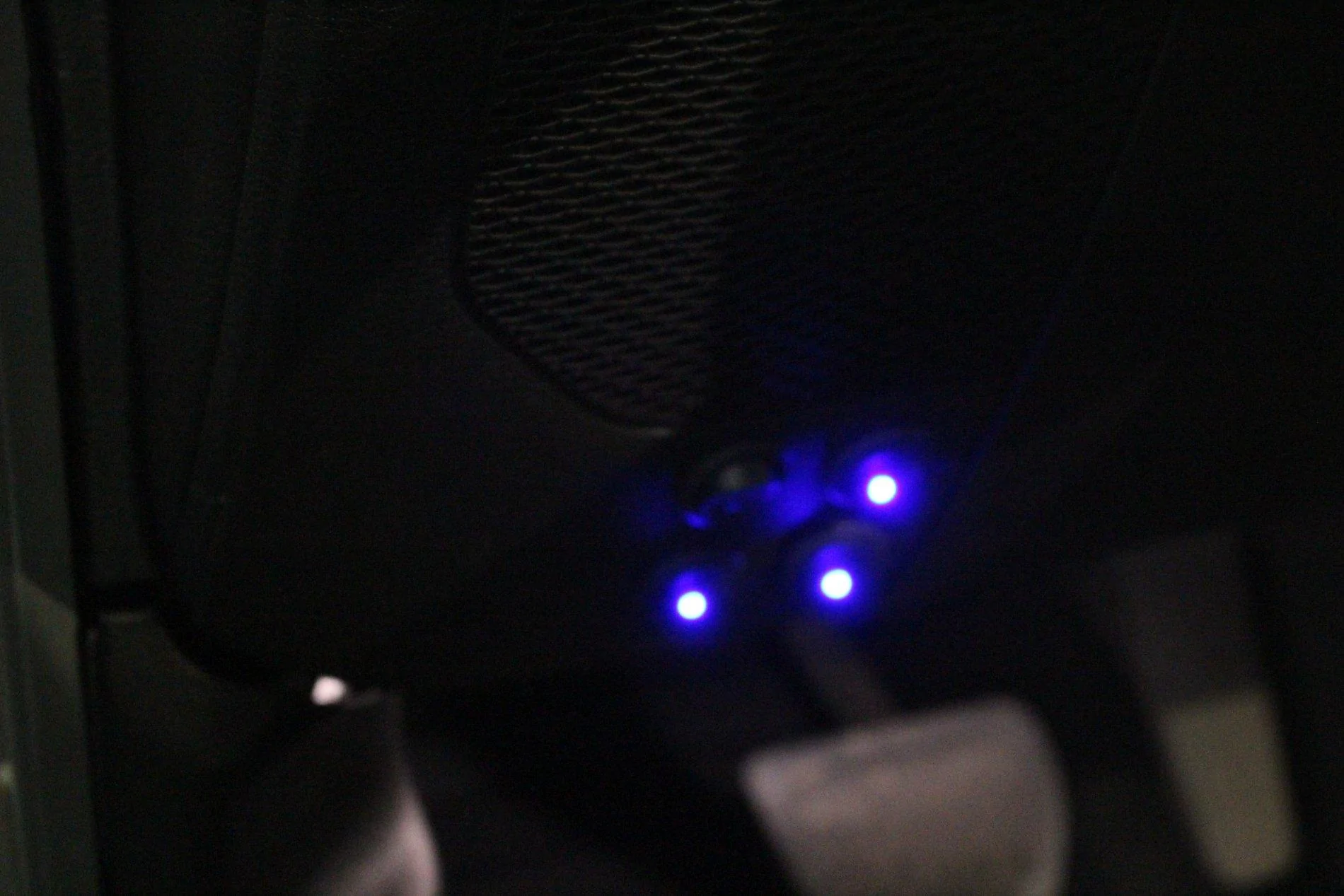

I just mounted my 4 switches here to the left lower panel, cost $10 (since I didn't have anything pulling more than 15 amps :)
Nice! Brad I appreciated your other topic post on wiring for the F57 tandem fuse; was very helpful to power an aux light relay next to battery.
Jeep Wrangler JL Switch Question Button_3
Those dash spaces seem easy to work, but are for nimble hands and patience, can't imagine
four switches, were they quick disconnects?
I pulled wire up into the engine raceway and through the manual trans firewall hole to one switch in that dash area and did solder but with wire pulled forward of dash, bit easier, and two screws behind, as the switch maker's solder needed rework.
Nice job!
Yeah, I used insulated spade connectors on those switches to make the install easy. I used a 3/4" step drill for the holes and had to really press those switches in hard to get them to set, but they did :)

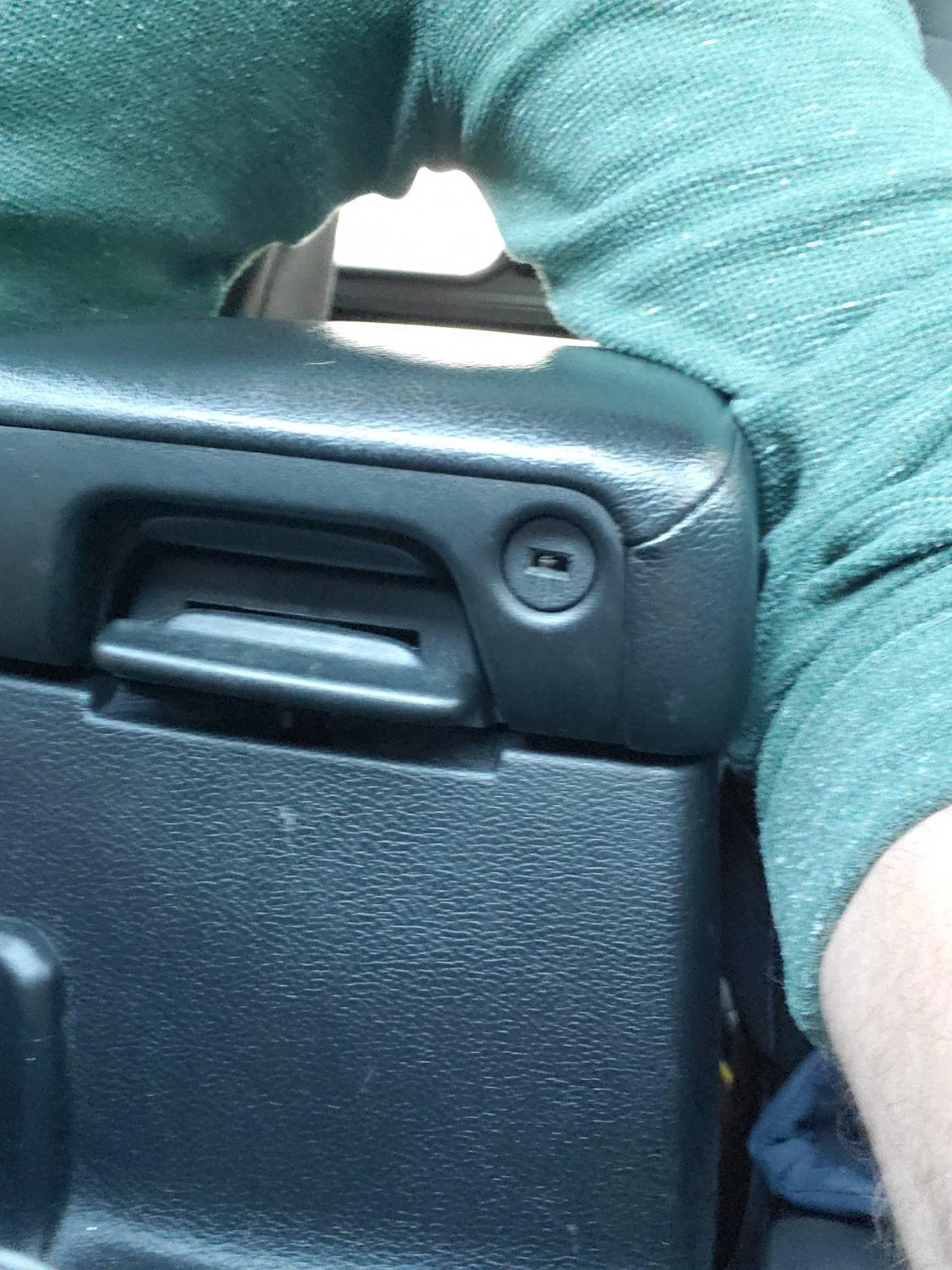

Anyone put some OTRATTW switches here?
