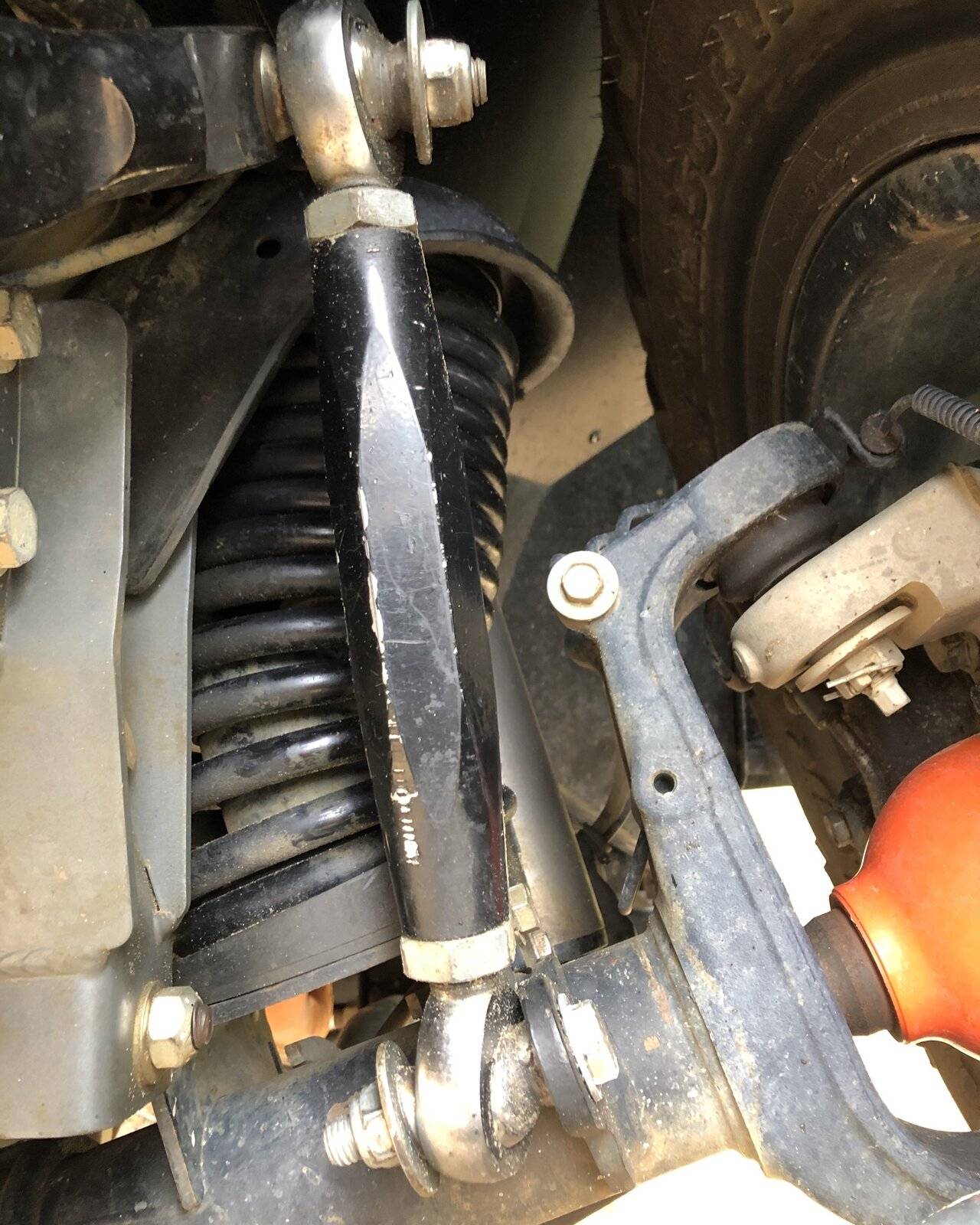

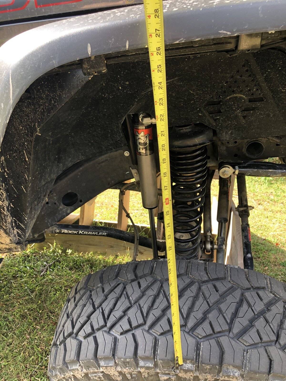

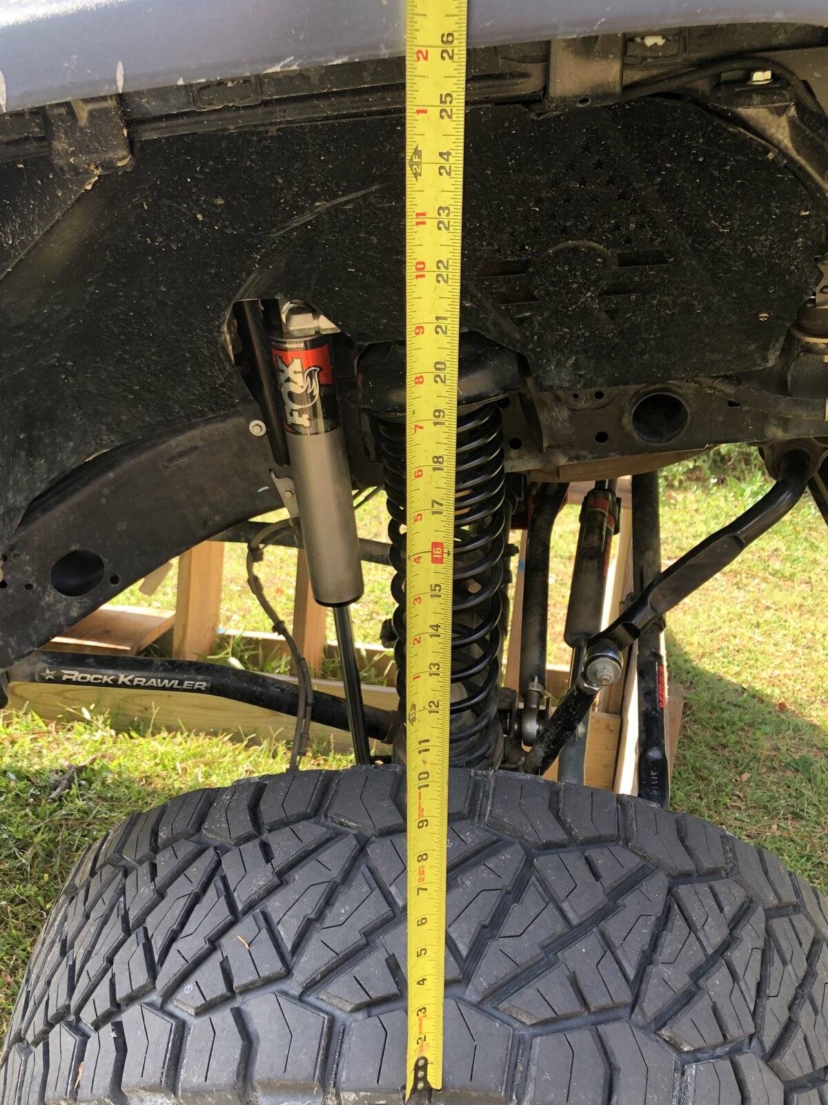

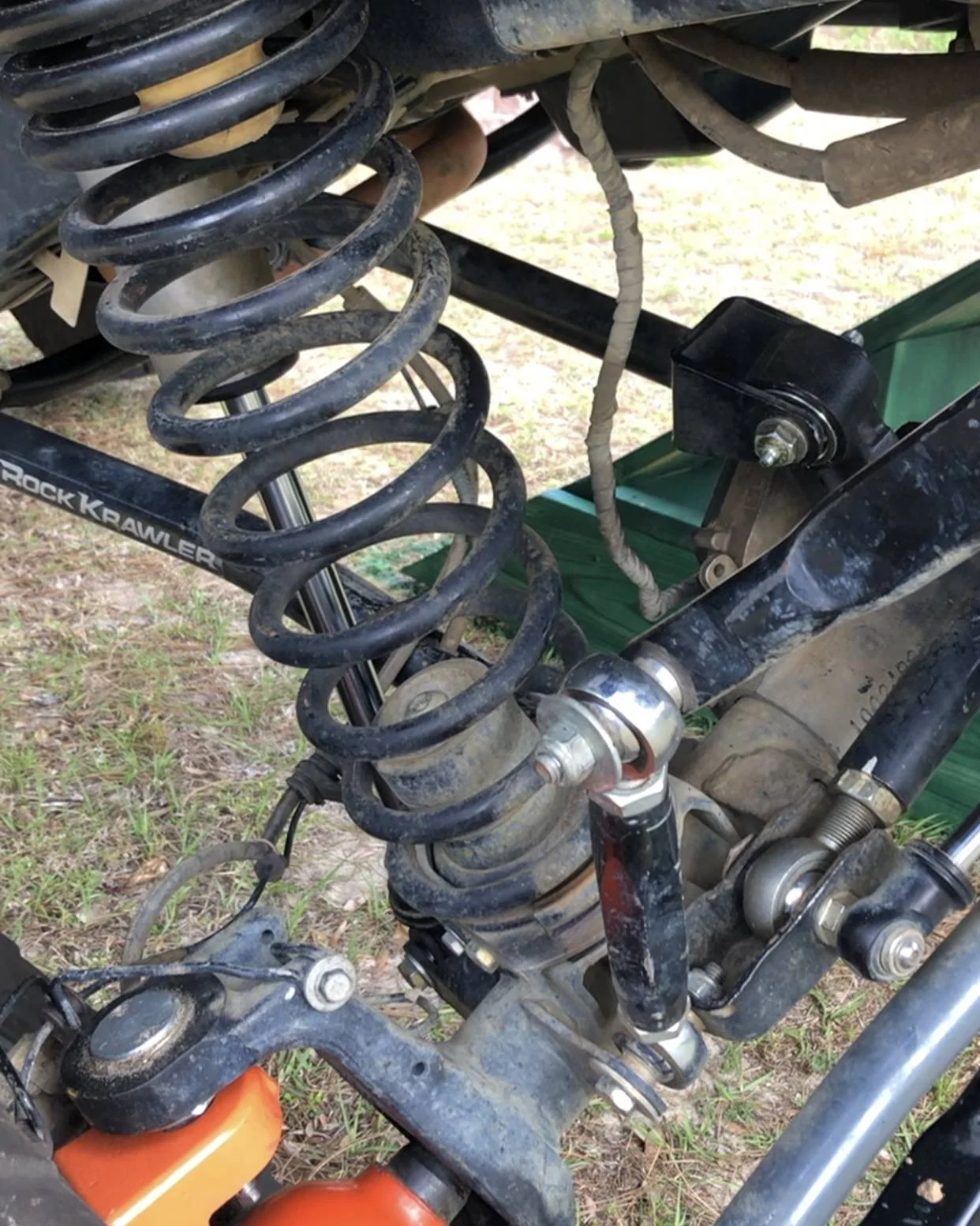

I did a comparison last year for my own curiosity…….. I know for a fact that with the heim joint links there is almost no difference, like a quarter inch, in e-discoed and un hooked. I’m not sure how much difference there is in say MC links, you know the 3 footers that come with the 3.5”GC, lol. I’d like to see a MC dude do a comparison. I can tell you that there’s a ton of misalignment when at max flex………
obligatory pics……..
e-disco
Jeep Wrangler JL Sway bar will not reconnect 3F077EEC-7370-42C8-92D7-8DB8A30B85D2
unhooked
Jeep Wrangler JL Sway bar will not reconnect 947D0A18-8262-487E-9531-3FF70F93FB3F
Misalignment
Jeep Wrangler JL Sway bar will not reconnect 6CAD93F1-A4A7-4746-A6AC-1A59702F563D
Jeep Wrangler JL Sway bar will not reconnect DD05BE94-BA5D-4482-9B22-4C25A800EDE9
