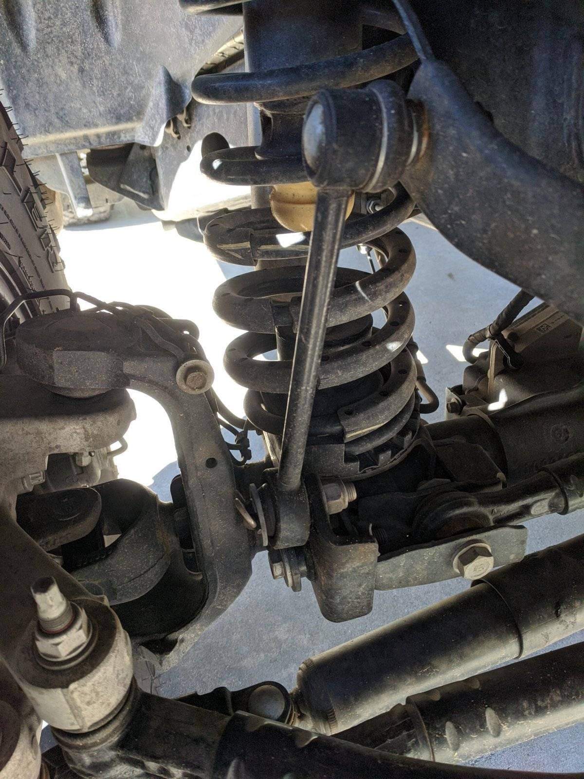

Not the parking brake, the Teraflex Quick Disconnect Kit Parking stud. The stud thad holds the link out of the way so that you don't have to Zip Tie anything. I grease both the top (parking) stud (for when the link is disconnected) and the lower Sway-Bar Link stud (for when it is connected).
I grease both when I do my oil changes and before any planned off-road adventure.
Sorry I wasn't clear. Nothing intended for the parking brake. I never grease my parking brake either. As long as you use it regularly, I don't believe you ever should.
My question was specifically pointed at greasing just the Teraflex Disconnect components?
It sounds like your answer is no. This makes me feel even better about the Teraflex kit. Perhaps I was masking the noise issue by greasing my Disconnect's Studs at all.
Parking Stud:
Jeep Wrangler JL Sway Bar Quick Disconnect Recommendations? IMG_20210221_103321_1
Sway-Bar Link Stud:
Jeep Wrangler JL Sway Bar Quick Disconnect Recommendations? IMG_20210221_103444_1

Mike,
Parking Stud:
Sway-Bar Link Stud:
Jay
My bad. I'm running regular Teraflex links on my Jeep and Metal Cloak discos ones (like yours) on my wife's Jeep. They have a poly bushing in the disco end and I use silicon spray on it and the post to make it easy off and on. The silicon dries and does not attract dirt like grease does.
