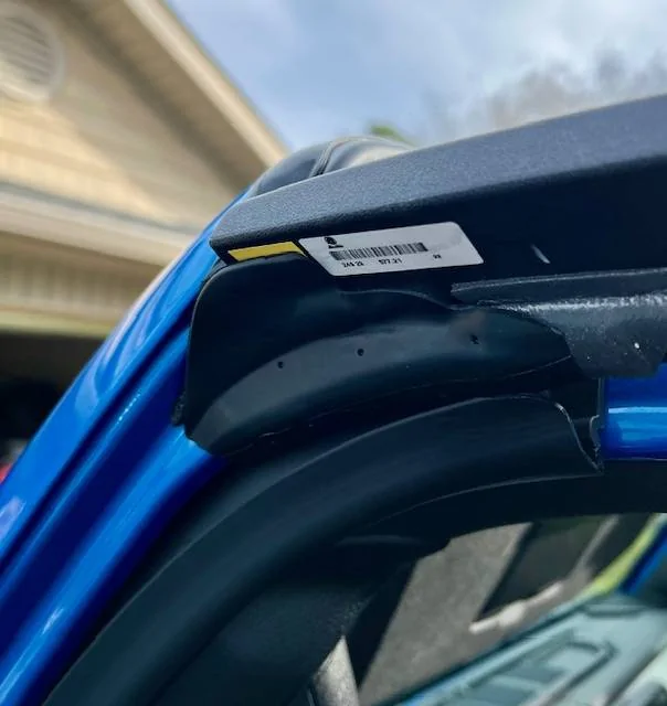

That picture looks like it doesn't have the flap that's on the 2024 (since you can see what appears to be a sticker on the Sunrider mount in this picture). It almost looks like it would be better to have it tucked under the Sunrider mount, the pressure being put on the untucked flap could cause it to tear over time or become deformed to a point it might not seal correctly when the Freedom Panels are reinstalled.

A dead giveaway that the JL used in the video is not a 2024 is the fact that it still has an antenna as opposed to the 2024 which has an antenna built into the windshield if you look at the opening and throughout the video, the mast antenna is clearly visible. So it seems that even @Bestop’s people don’t even know what they’re talking about by showing us a frame from a video of a vehicle, which is clearly not a 2024.

When my Sunrider arrives I'm going to take a couple pictures of the Sunrider part that fits against that flap before I put it together. Will take a picture of it next to the same section of the Freedom Panel to see the difference between the two. I'm betting the front of the Sunrider mount needs to be modified slightly to fit the 2024 the way it should.

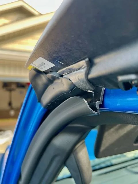

My Sunrider arrived today and I just installed it on my 2024 JL. I am beyond excited that is went on perfect and I don't have any flaps sticking out!
Now, I did do some test fitting first. I just set the two side arms in place before I attached them to the Sunrider top. In doing so, the flaps were sticking out at first, but after closer inspection, I discovered why...
Jeep Wrangler JL Sunrider install IMG_3863
My first attampt before assembling everything.
I noticed there is a knob that needs to pop into the hole on the roll bar. After ensureing that was popped into place and the support arm was flush to the roll bar, the flap laid much flatter...

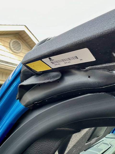

Jeep Wrangler JL Sunrider install IMG_3864
This is with the knob fully seated into the hole in the roll bar.
Here are a couple pictures of the knob and the hole it goes into as well as one showing it sitting flush against the roll bar...
Jeep Wrangler JL Sunrider install IMG_3865
Jeep Wrangler JL Sunrider install IMG_3866
Once I figured this out, I assembled the Sunrider and had my wife assist with placing it on top of the Jeep. I then was careful to ensure those knobs were fully seated on both sides before tightening the 4 bolts that attach it to the roll bar.
Here are some pictures of the flap with the door open and closed after installation on my Jeep:
Jeep Wrangler JL Sunrider install IMG_3867
Jeep Wrangler JL Sunrider install IMG_3868
And finally, here it is on my Jeep!
Jeep Wrangler JL Sunrider install IMG_3869
I have to say, I am very satisfied with the Sunrider and how well it fits on my Jeep. If your flap is sticking out, the first thing I recommend checking is to ensure that knob is fully seated into the hole in the roll bar! Hopefully, that's all it is and this will fix your issue as well.
