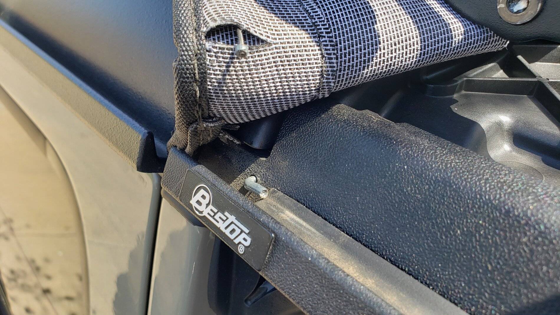

Here is a picture I swiped of the Gladiator forum.

Are they prone to failure, as pictured above?

Never had any problems with the one we had, but there are reports of it happening.

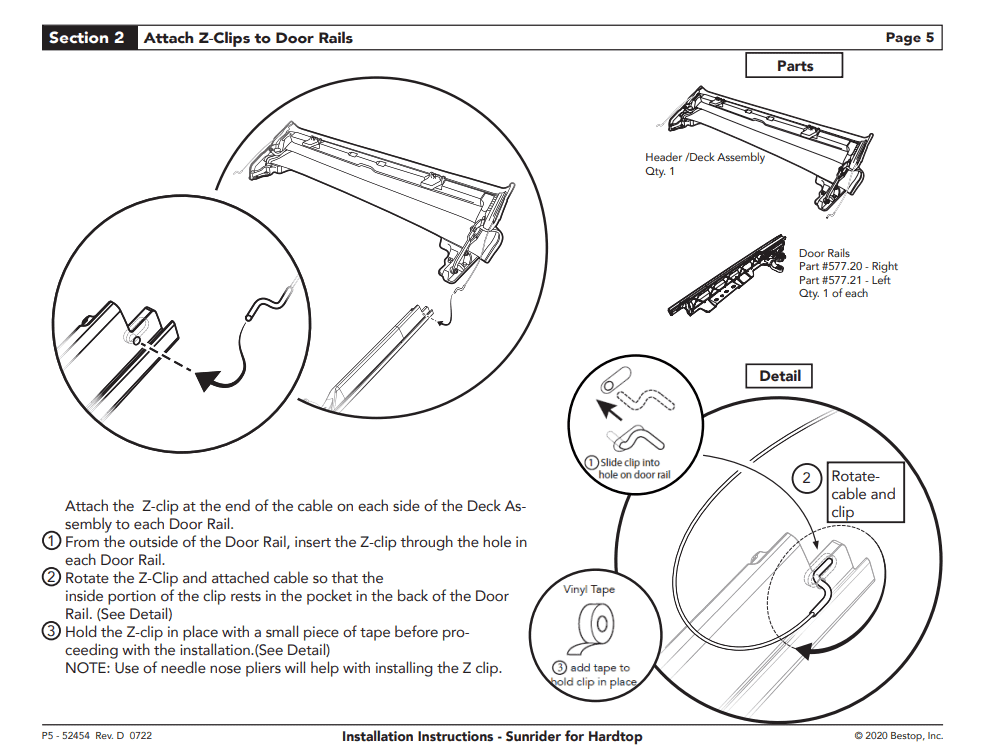

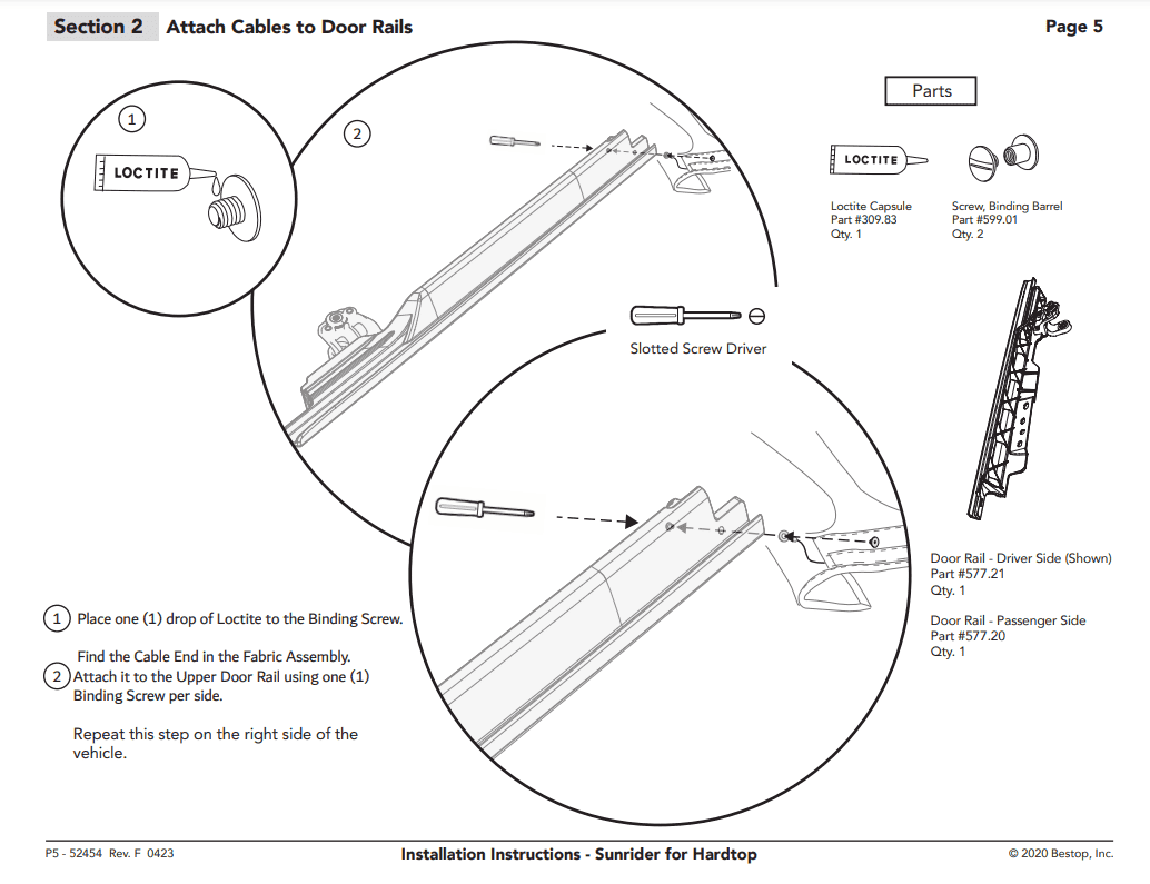

so, they finally did away with those damn z-clips.
The tension cable is still there but now mounts with a small screw type-ish thingy...
I hated those damn z-clips...
Old z-clips:

NEW Screw/Binding Barrels:
