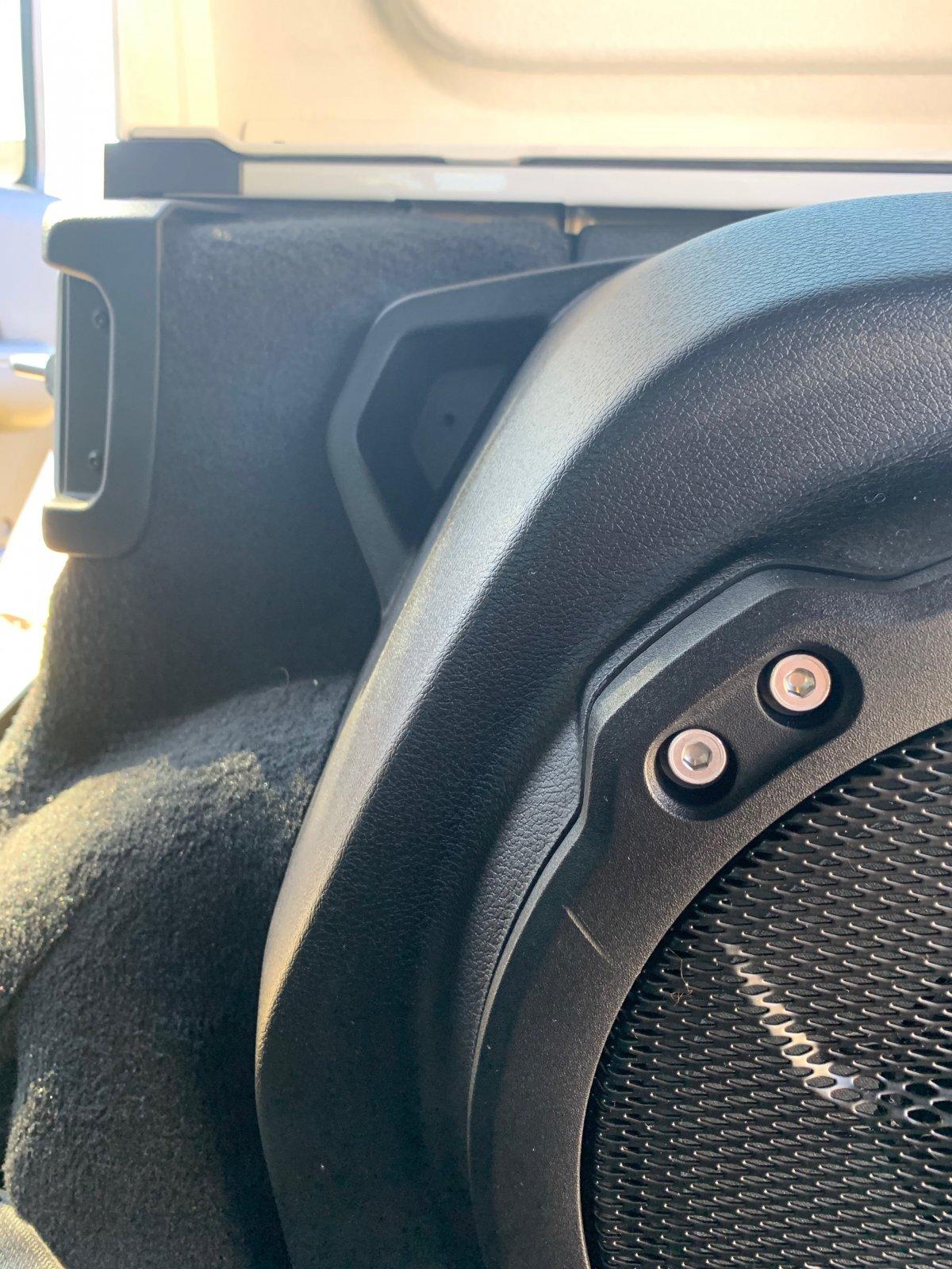

Is is this bolt that you're asking bout? (See photo)

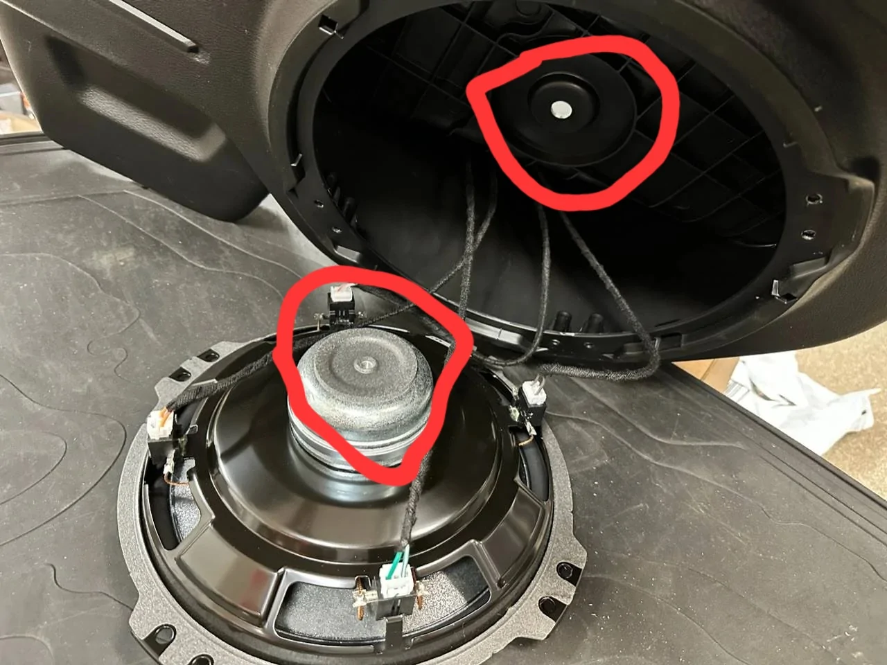

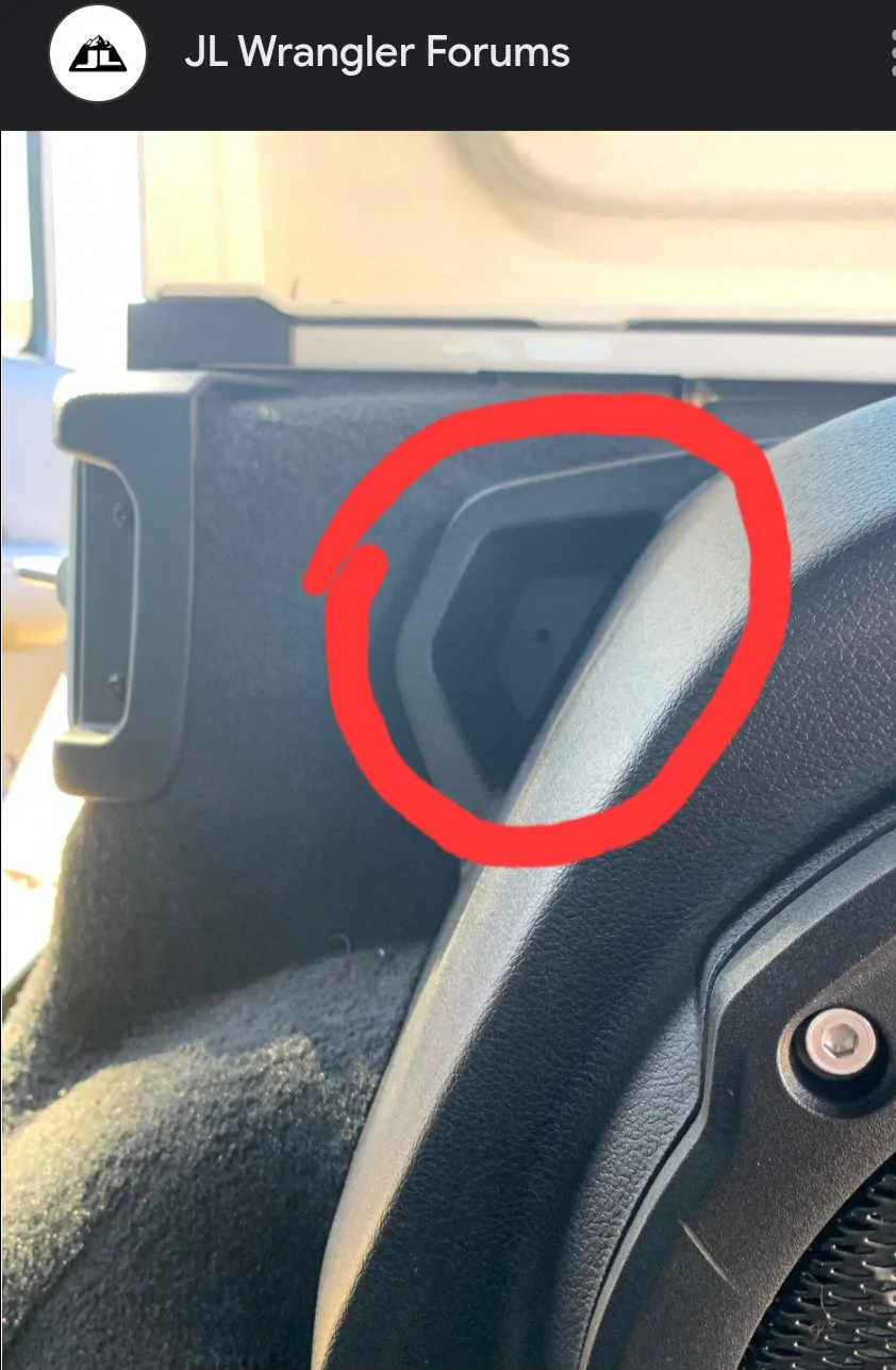

I know this is an old post, but wondering if anyone knows the thread and size of the two subwoofer bolts?
I had the subwoofer out while I was doing some work on my wife's 2024 wranger and misplaced the bolt that holds the enclosure to the wall of the jeep and the bolt that threads into the back of the subwoofer.
I called jeep and they said both bolts cannot be ordered as they are part of the subwoofer which is sold as a unit.
They couldn't tell me the size either, they recomended I go to a hardware store and try and size it...
Figured I would ask here first in case anyone knows..
Thanks

I pretty sure that those are 7mm head screws that are found everywhere on the Jeep. Been awhile since I took it apart to replace the sub.

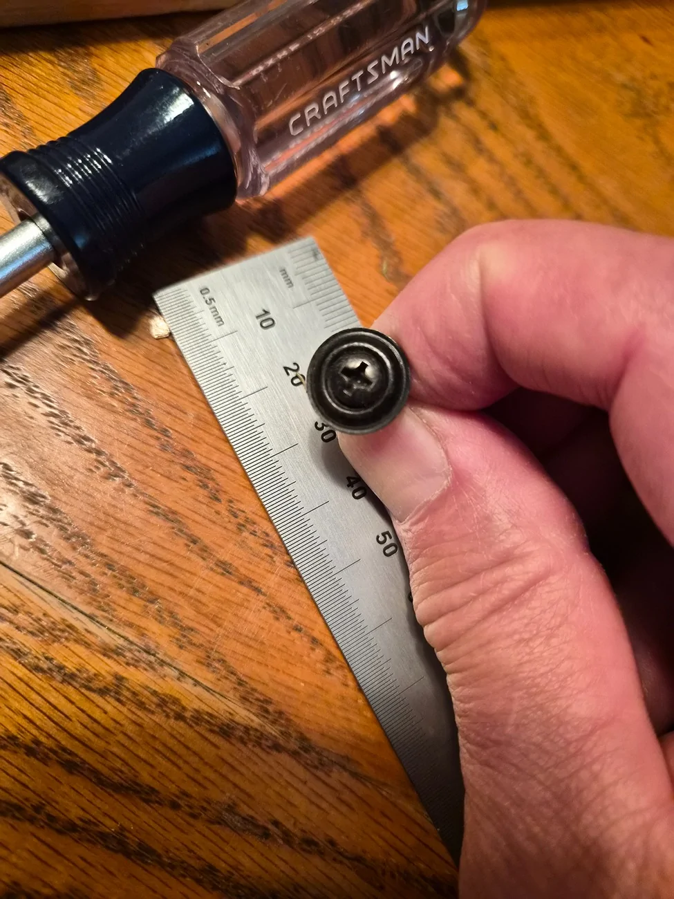

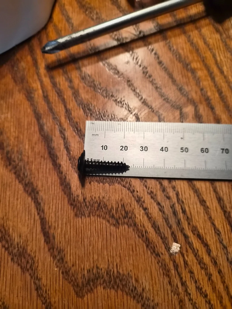

If you need the screw that holds the plastic interior panel to the side of the quarter panel, its a black hex Phillips head sheetmetal screw of maybe 4mm thread. Mopar online parts sellers don't show it separately. Maybe Bennie can help
I pulled mine. It's a phillips head 4.7mm dia sheetmetal screw, 23mm long.

Here's pix

For any one wondering I ordered Mopar part# 6101946 and it fits the side panel.
Now I just need to figure out the subwoofer bolt, right now I am too lazy to take it out lol... when I figure it out I will post here... I think it may be m6 bolt
