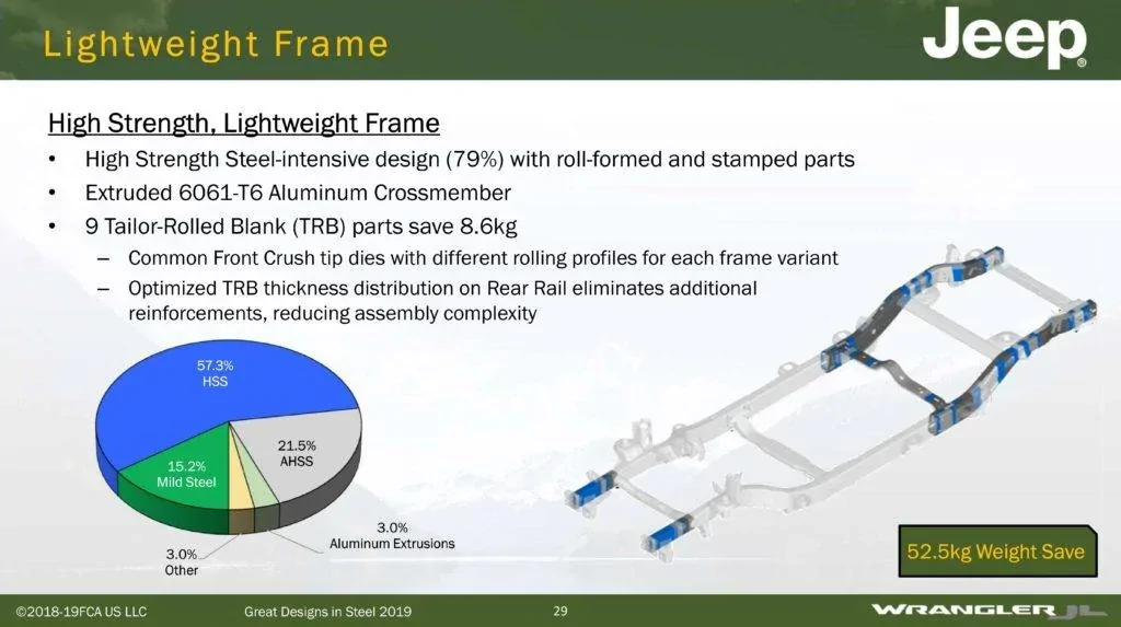

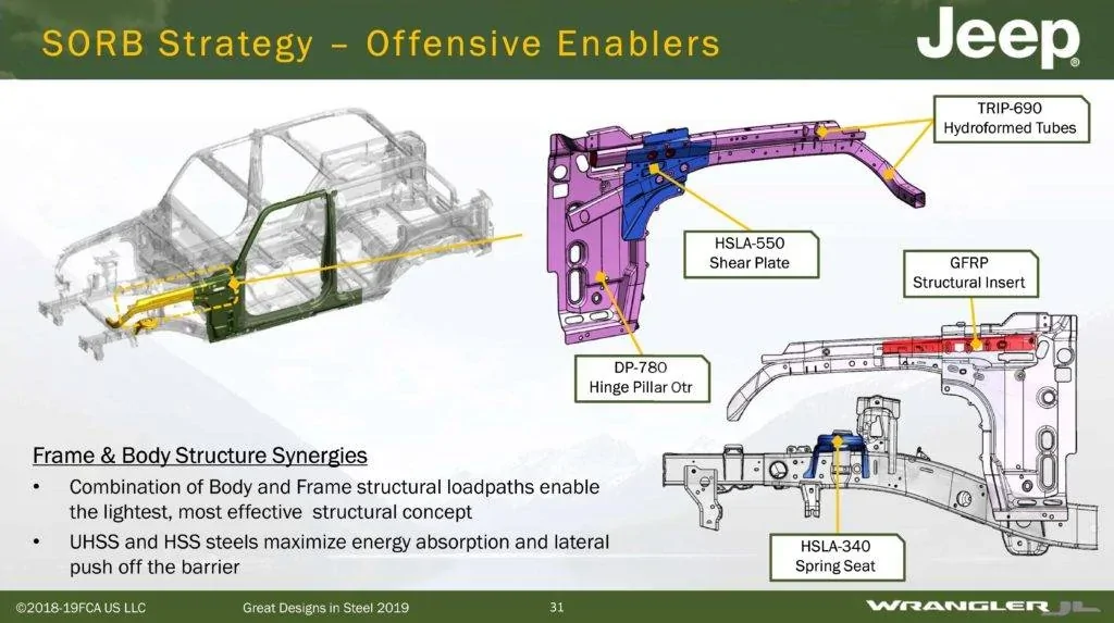

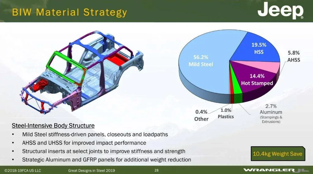

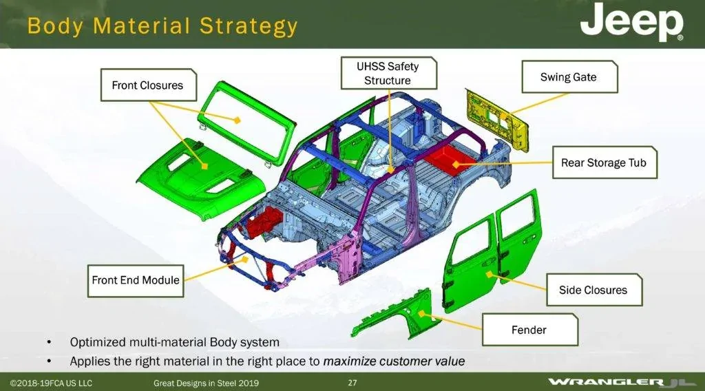

I'm not exactly sure what the OP is trying to get at. In general every generation of a vehicle has gotten much safer, and the structure much stiffer - which also helps with suspension/steering effectiveness.
The JL specifically has a lot more high strength and ultra high strength steel in key parts of the vehicle structure. It also has a fully boxed frame. (see pictures below).
So, yes, the JL is immensely safer than 1990s Jeeps. And that is before all the advances in traction control, ABS, blind spot monitoring, curtain/seat airbags, front collision detection, etc.
If you care about safety, don't mess with the safety structure or gear of the JL - I.e. keep the sawzall away from the Jeep.
Jeep Wrangler JL Structural quality question 1764910511393-t4
Great explanation, this is the kinda thing I was looking for.
