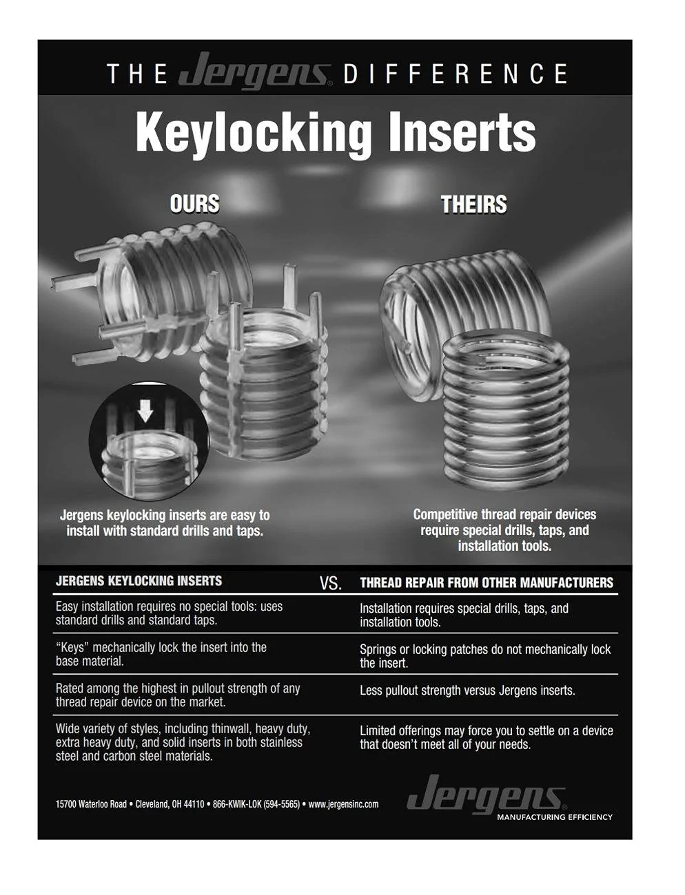

There are a few types of thread inserts for this issue.
Jeep Wrangler JL Stripped Steering Gear Box Threads inserts 1
Jeep Wrangler JL Stripped Steering Gear Box Threads inserts 2

The helicoil will be at least as strong as the original.
