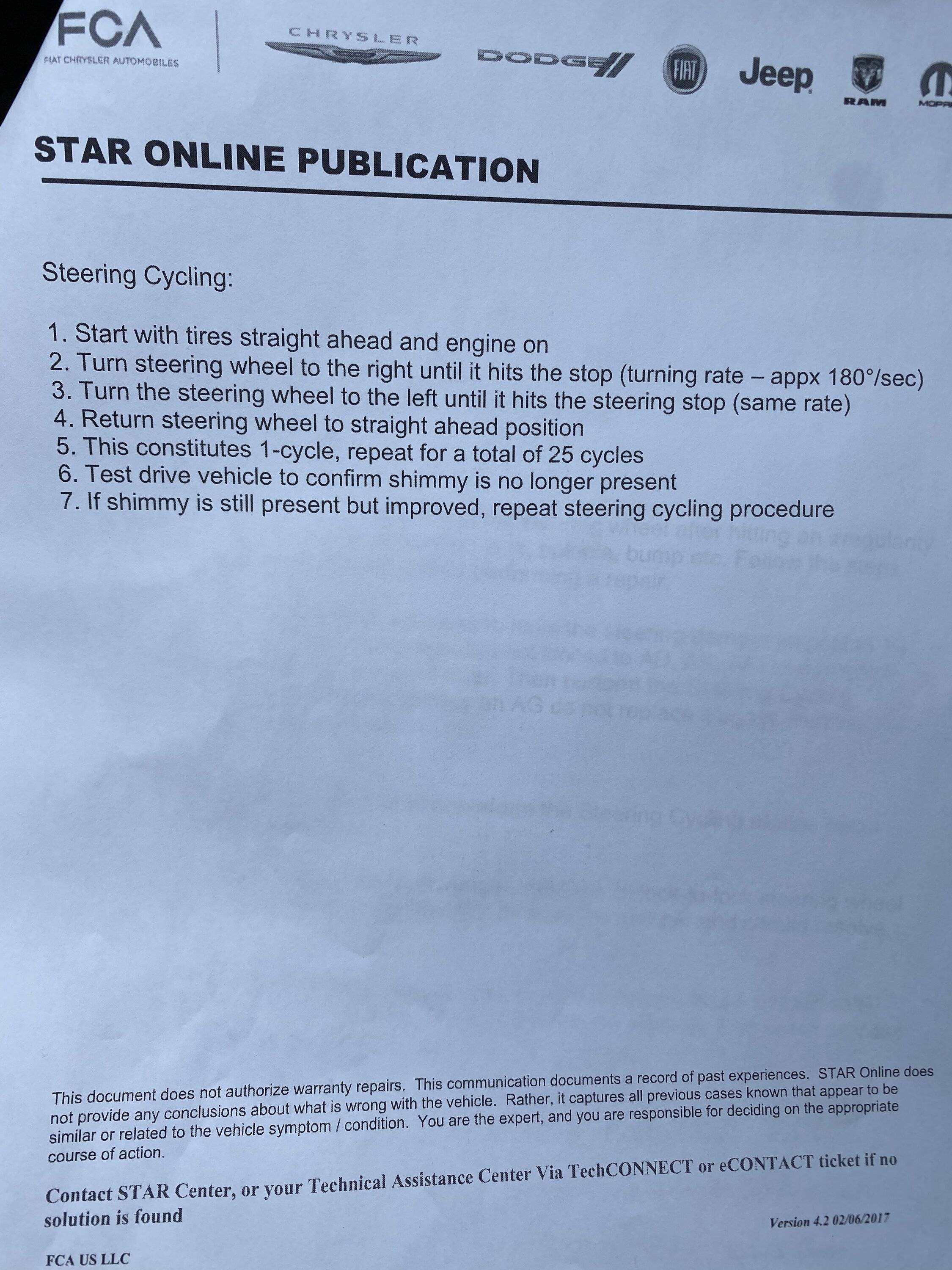

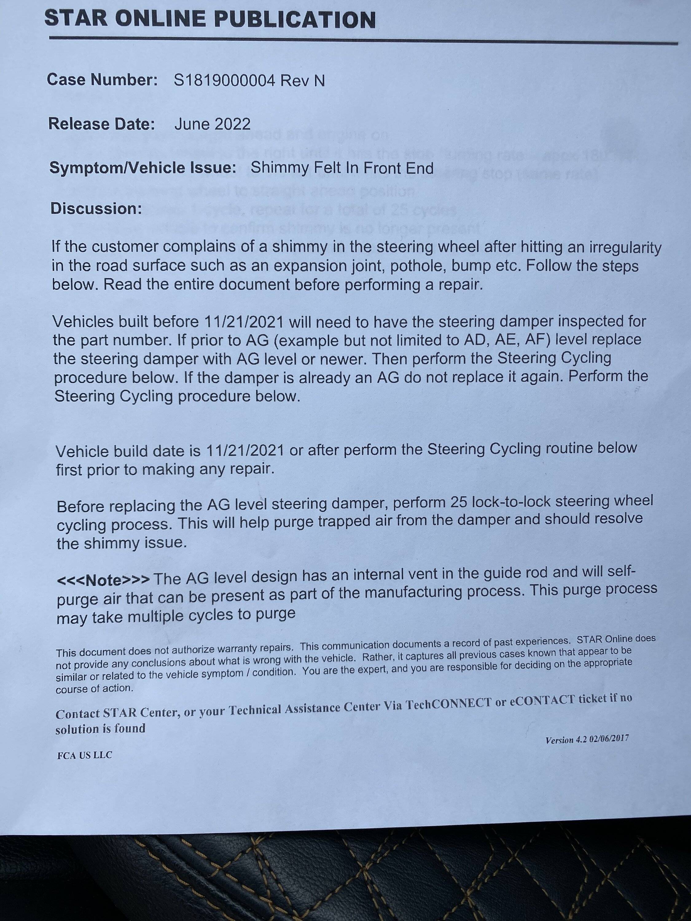

This is where the “25” cycles comes from.
They did this on mine, fixed it for a week, then back to its old self.
It has now been replaced with a Teraflex Falcon Nexus fast adjust and it nice on med and firm settings.
