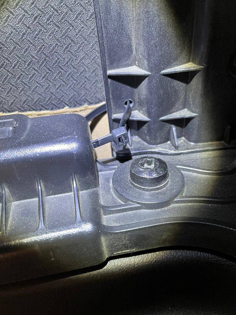

Drill a hole at the base of each vertical stiffener used by the side windows. Do the same in the adjacent plastic trim that is attached to the body. Run a zip tie through both holes.
That is the same M.O. used by those soft top owners that want to prevent [recurrent] loss of the side window panels while driving in high winds.
This subject recurringly makes the rounds on the forum. Here are the pics I've saved from the related threads.
Jeep Wrangler JL Stolen Soft Top Windows Soft top window retention A
Jeep Wrangler JL Stolen Soft Top Windows Soft top window retention B
Jeep Wrangler JL Stolen Soft Top Windows Soft top window retention C
To be fair if they have your tailgate open to be able to steal your side windows none of that is going to help.
