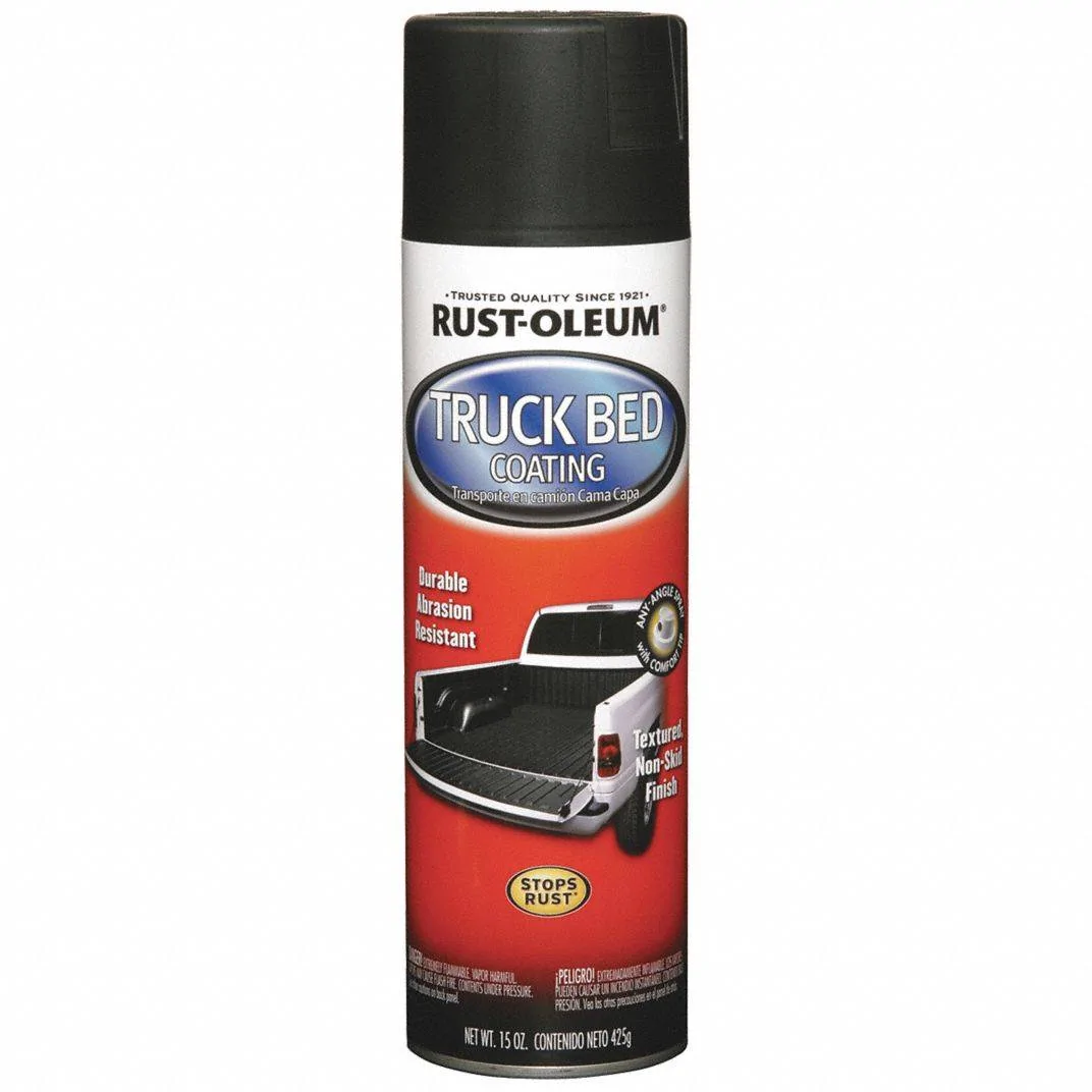

I ended up buying some rustoleum 'clean metal' primer yesterday and rustoleum's black semi-glass paint. I sprayed it down last night and I'm pretty happy with the way it turned out. I also discovered that my power washer nozzle on wheels didn't clean as good as I hoped, as there was still clumps of mud stuck on the cross bar.
Is semi-glass correct to use for the stock bumpers too? I touched a little up as well and it looks like semi-gloss may be a bit too glossy for those.
EDIT: Should had searched before I did anything. Apparently people suggest using the Rustoleum Truck Bed Spray instead.
@nU7OuxIx
Jeep Wrangler JL Stock Skid Plates Touch-Up 000

Yup, that's what I ordered. I'm going to go out there tonight and see if I can't sand down my touchup a bit so it's not so obvious.
Do you mask it off or just spray and go?
@nU7OuxIx
I hold a piece of cardboard alongside of what I'm painting so as not to get over spray on anything along side. At times I take cardboard or paper and surround what I am painting.
Always clean area well.... I use some steel wool after cleaning and then wipe the area to be painted with alcohol, paint thinner, etc. to get all oil and such off... THEN, I spray multiple light coats of the bedliner spray .. pausing for a couple of minutes in between the coats.
Also, if you are spraying in your garage or over a nice concrete driveway, etc., do lay an old sheet, or old blanket, etc., under where you are painting or you will be painting the floor. Do not sprayt on a windy day...

If I understand you correctly, you are blending the spray with the existing finish and not using tape or cardboard to make a hard line, right?
I just finished scraping off my semi-gloss paint job and cleaned it all up. My bedliner should be here in a couple of days so I still have some time.
Thanks for your help with this! It's in a weird area where not many people are going to see it but me, but I still want to do a good job and take care of my Jeep!!

More often then not, I try to blend it in. To me that is easier on my eyes so to speak.
The Rustoleum Bedliner Spray is easy to deal with...
You can spray it on or even spread in on with a clean lint free piece of cloth.... or apply with a sponge on a stick, etc...
I myself use it on Ace Sliders, Rubi rails and such...
Just don't apply heavily.... light coats or it will, though pretty thick, will run.
This Bedliner Spray is also something that you can go back and easily touch up after say an off road excursion... the reapplication blends right in...

Thank you so much for the information!! I didn't know about the sponge application....I have about a half gallon of the bedliner paint sitting in my garage that I used for another project.
I'm going to end up using the spray because I think that it will look better. We'll see how it turns out!! Thank you again!!
