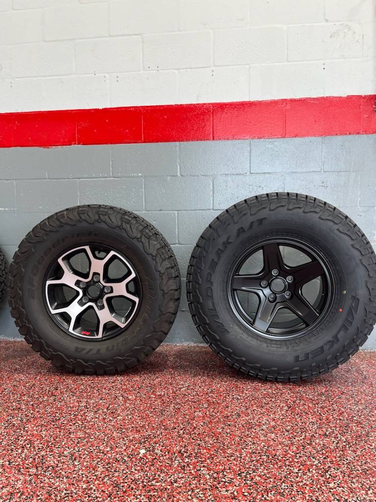

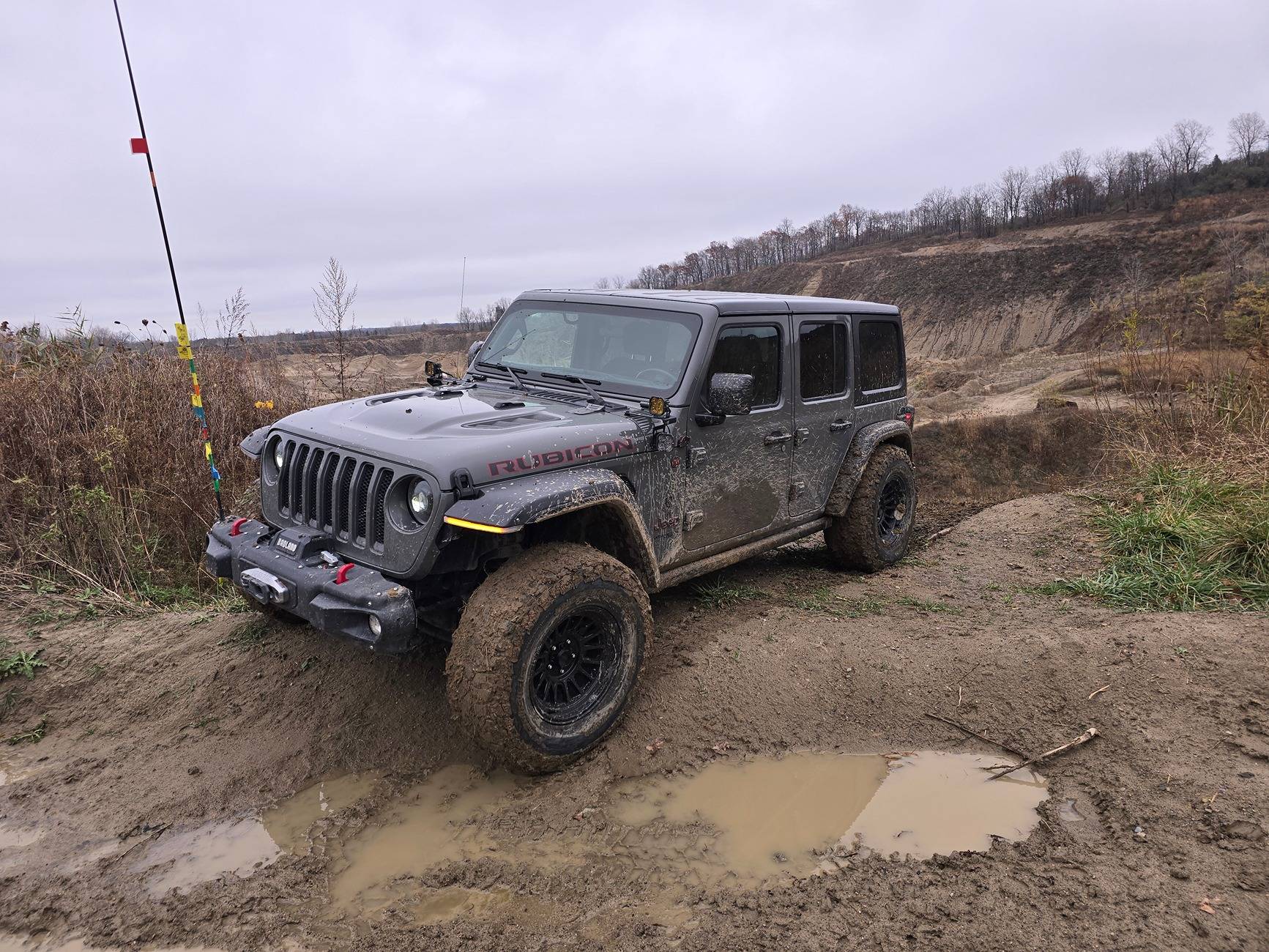

Hey 👋
2022 JLURD upgraded to 35's no lift
No rubbing, although I don't do much Offroading
Here's images below difference between factory 33 & new 35
Hope this helps

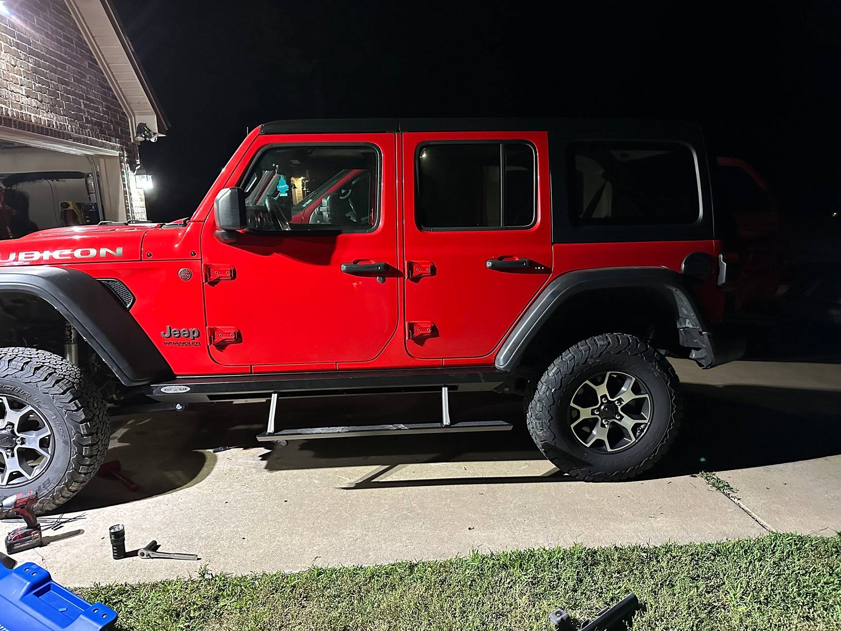

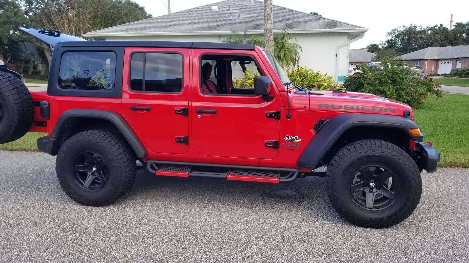

Andrew
Mar 14, 2022
Little Rock
(on order) 2022 Wrangler Rubicon Unlimited
Orange one isn't mine, I found the picture when deciding to upgrade to 35s.
First picture (day) is with the lift just on the front
Second is the 2 inch mopar lift installed with 33 inch tires
last red picture is the final outcome
Longer mopar LCAs
Rock Krawler spring correction pads
Rock Krawler rear track bar relocation bracket
Rancho front geometry brackets
Rancho front track bar (got a good clearance deal on it)
315/70r17 k02 tires from DiscountTire (they had them for $270 a piece)
Rock Slide engineering side steps
dynatrac ball joints
Stock brake lines are borderline not long enough and either need longer ones or a different bracket, at full droop the front brake lines are taught.
Also the 305 size tires fit great on the stock rubicon rims

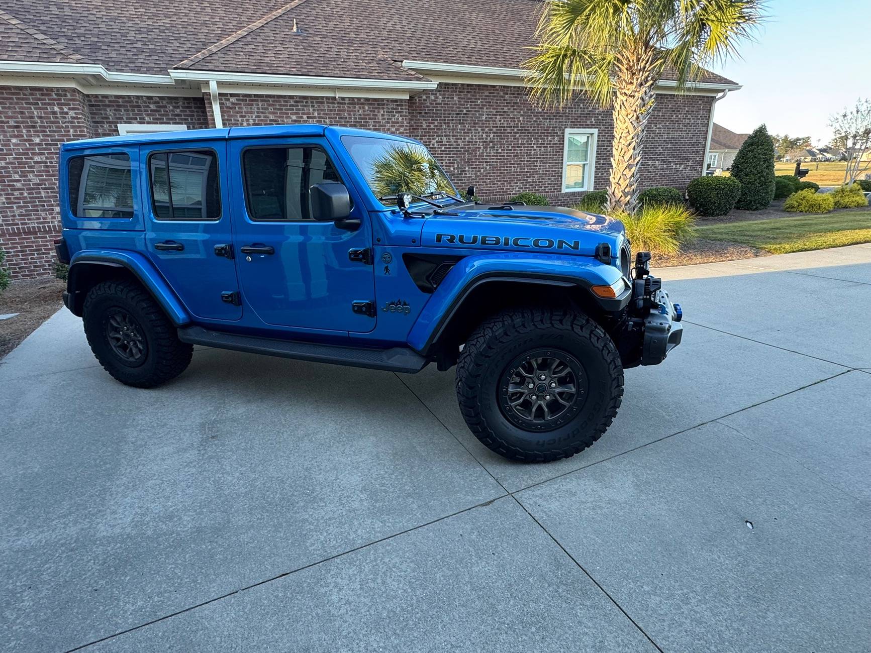

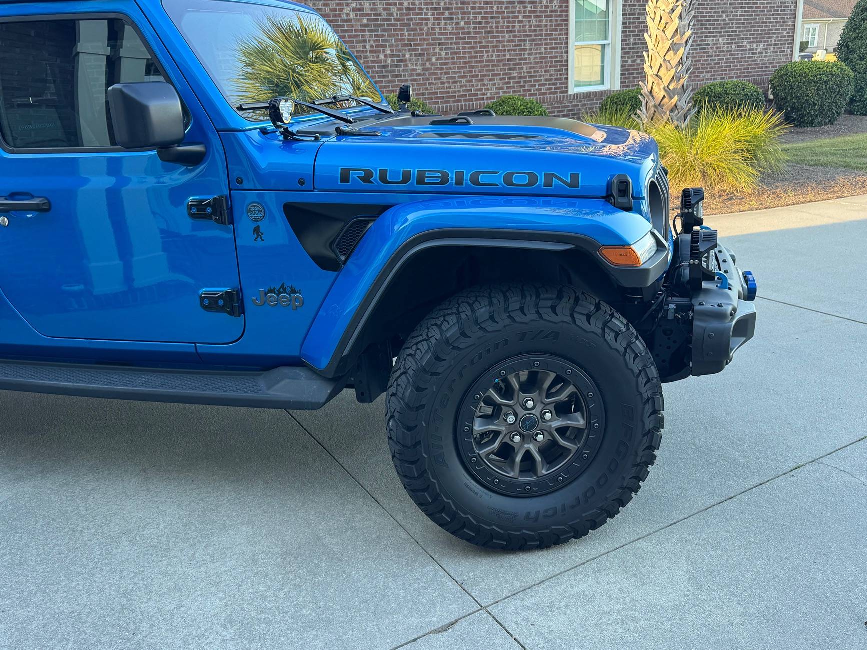

wreck99
Matthew
Mar 26, 2023
680
756
SC
2024 JLU Rubicon, 2019 RAM 1500 Bighorn
I've recently upgraded to 35's., stock Rubicon no lift yet. I do plan to get a lift next year but I've had no issues so far off-road flexing on the rocks. I've not noticed any rubbing or any real issues with these 35's Falken Wildpeak AT4W.

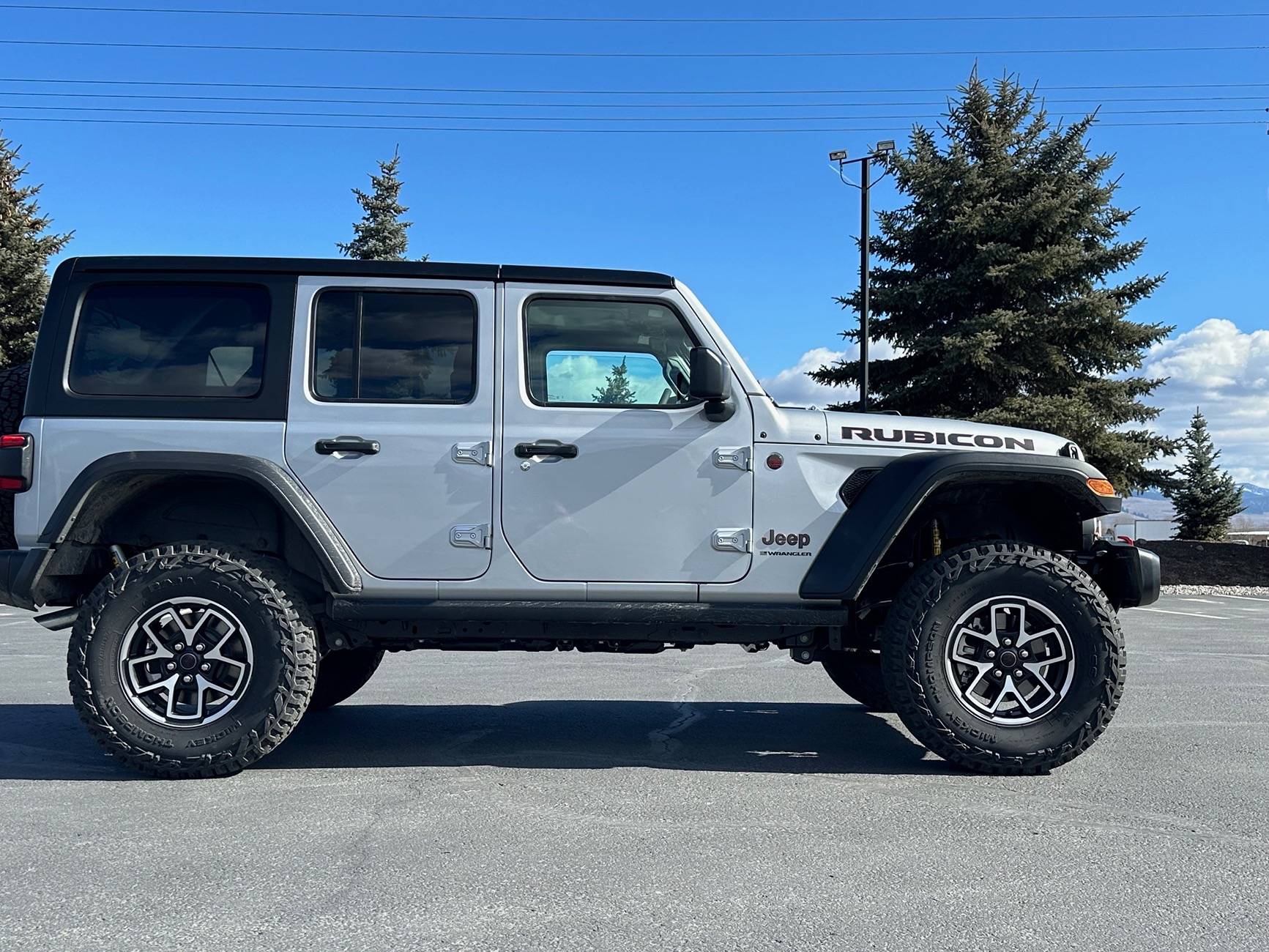

montana
If you don't mind skinny tires you could do 255/85-17 on stock wheels. they are actually just a little taller than 35's but only 10" wide so less rubbing. they are not for everyone tho.
Jeep Wrangler JL Stock Rubicon JLU on 35s? IMG_5787
