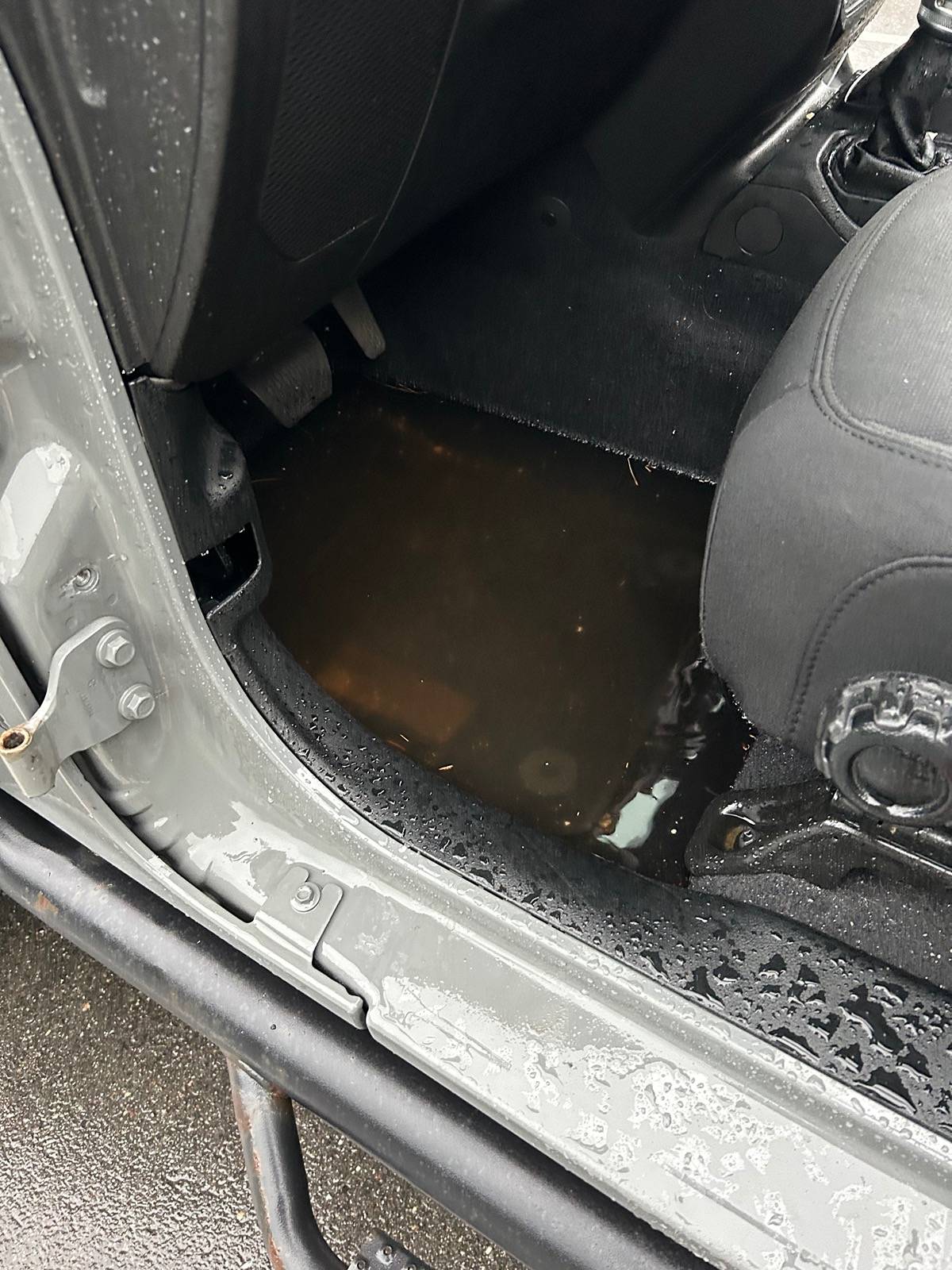

Soooo I have a bit of an issue… had the top and doors off the other day when a HUGE storm came through and filled the jeep. Got all the water wet vaced out and now it smells like old dirty shoes! What are thoughts on getting the stink out!
The ozone generator is a great idea. You can get one from Amazon that plugs into a 12v power port, damn I'm old enough that it's hard not to call it a cigarette lighter. Another option is to fill up 2, preferably clean, socks with ground coffee and put them under your seats. Good luck.
I have used a concoction of 50% rubbing alcohol and 50% vinegar. Alcohol will evaporate the water and vinegar will prevent mold. Shop vac as much of water as possible and spray the alcohol /vinegar mix on everything you can. The dehumidifier will also help . I've used that approach on several different types of water intrusion. Good luck.
