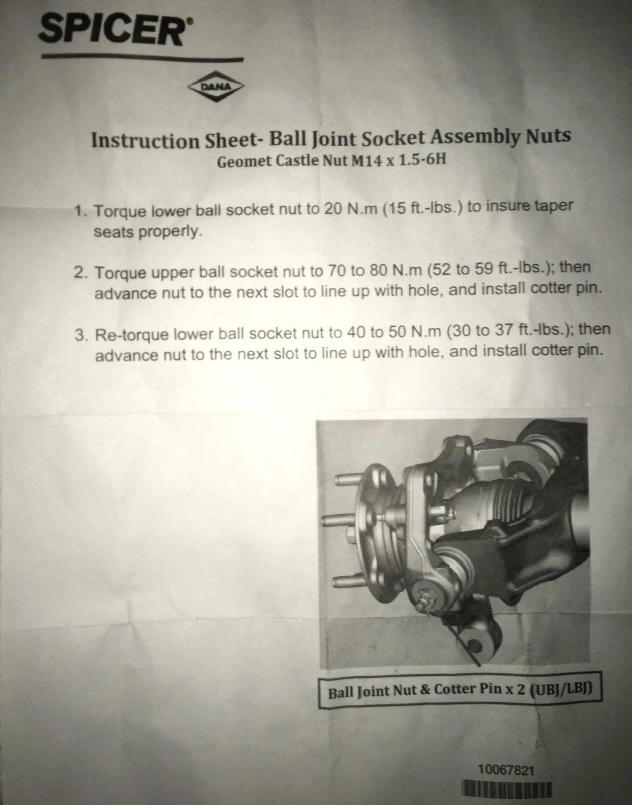

The ball joints are a trq spec of 37ftlbs. Unless they are loose to the point you can spin them with your finger you should be fine.
A little more complicated than that ... pic compliments of another forum member.
Jeep Wrangler JL Steering wheel wobble? Ball Joint Torques

the better question is how are you torquing this? My torque wrench is certainly not fitting in there
My torque wrench wouldn't fit either. But, since it's not as critical as say a head bolt or rod bolt, I used a combination wrench and a digital luggage scale. The application of the luggage scale on the wrench provided the "foot" part and the luggage scale provided the "pounds" part of the "foot-pounds" of torque. My combination wrench had a moment arm of 9.5" ... not a full foot, so some math was involved.
Because the ball joint uses a torque turn method of tightening, it's really not critical to obtain accuracy to three decimal points ... thus, this is an acceptable method.
