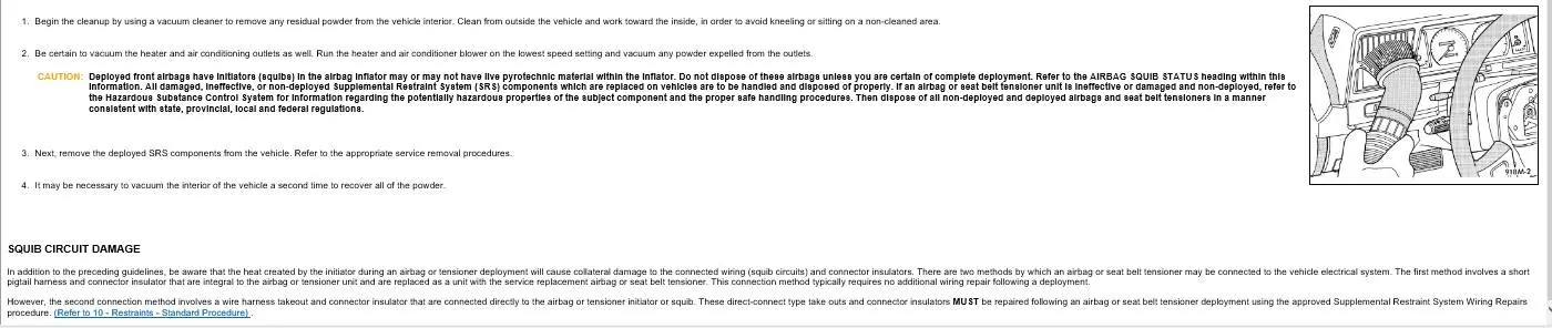

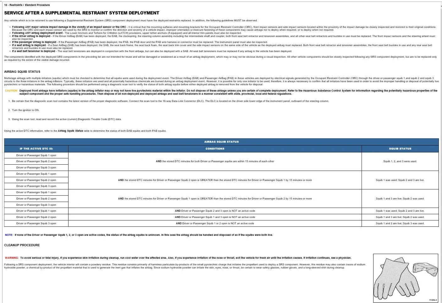

I don't see any upside to DIY working on an airbag system. Lots of possibilities for bad things for everyone involved, including subsequent owners and your personal financial health.
But, here's what I can dig up in my manual.
Jeep Wrangler JL Steering wheel air bag replacement service after SRS deployment 1
Jeep Wrangler JL Steering wheel air bag replacement service after SRS deployment 2
