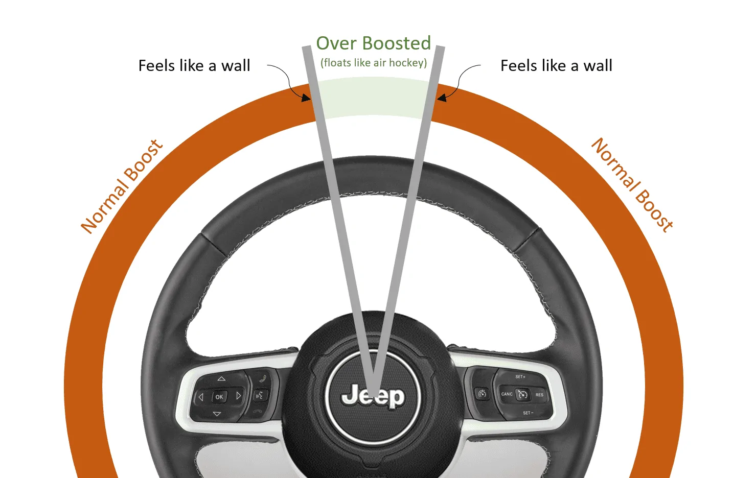

Two weeks ago my 2018 two door Rubicon was in the shop to get TSB 08-003-21 done. After getting it back I can tell it's slightly worse. I can confirm the steering box is replaced (visible after popping the hood) though they missed the track bar replacement (only applicable to early model). I did not get print out of steering software update (see this post) nor an alignment printout. I called the dealership soon after and found out the service advisor literally stopped working there an hour after I picked up my Jeep. So had to start appointment process again.
Fast forward to today. They replaced my track bar that was missed the first time, made sure the steering software was updated, and did alignment with printout. I picked it up and was excited for it to be better or at least on par with the original feel of the aluminum steering box. Boy was I disappointed... At least the manager had a good attitude to make it right. Hemade sure to hook up to their DealerConnect system and I can see indeed on 70FA (and not the old software 5SY). Although now I think about it I'm not sure why there's an extra 'A' in 70FA. @THEREED I see you're in the same boat as me! Let me know if you observe what I describe below.
Why do I say the steering is worse?
Not only does it have the wander on the highway, now even on city streets the center dead-spot feel is amplified! The way the power steering kicks in (or holds back the assist) really emphasizes the center dead-spot way more. If I were the programmer and my goal was to make the dead-spot the most pronounced, that's exactly the code I would write. It's hard to imagine Jeep intended this. Could the culprit be the extra 'A' in 70FA?
See my diagram. The center feels like it's gliding on air - like power steering is jacked up on caffeine. It coincides roughly with the dead zone. Then it abruptly stops the over boost. You really feel it, so much so I can hear a "tick" and sense a pulse when I hit that wall. Like the electric system suddenly cut power or changed voltage. It's fairly consistent but every now and then the tick isn't there, which makes me feel like this version of software screams Beta software.
So when I'm driving along in the green zone I make micro adjustments and the steering floats about doing zero steering. Then I make slightly more adjustment and it hits the wall with sudden jump in effort required (along with the tick). Instead of working cohesively with the mechanical system, it feels like the software has gone rogue and drawing more attention to its flaw.

From a steering feel perspective I regret doing this TSB. Overall it's a wash because I eventually want to go to larger tires and feel the cast iron steering box provides some additional peace of mind.
Yes!!!! I was wondering why mine had 70FA and disappointed with the result. Mine feels very similar to yours where the boost seems inconsistent throughout a steering cycle and my dead zone is worse than the last aluminum version. I find that at slow speeds the feel is better and the faster I go the more dead spot increases and steering has a lighter feel. I have not heard the tick nor any whine but as you describe the feel and response seems different throughout a full rotation of the steering wheel.
I ended up adding a Falcon 2.1 TS stabilizer which helps immensely adding a consistent heavier feel with better tracking but obviously doesn’t help my biggest pet peeve, the dead spot play. This is a band aid not a solution.
the big unanswered question for me is the difference between sales code 70F and 70FA and if that is the culprit. Is there some documentation from Jeep that has all of the sales codes listed? Is it possible the “A” has something to do with an error or incorrectly applied flash? I am hopeful that this is the issue as we have the correct hardware but not sure what to make of the software applied
