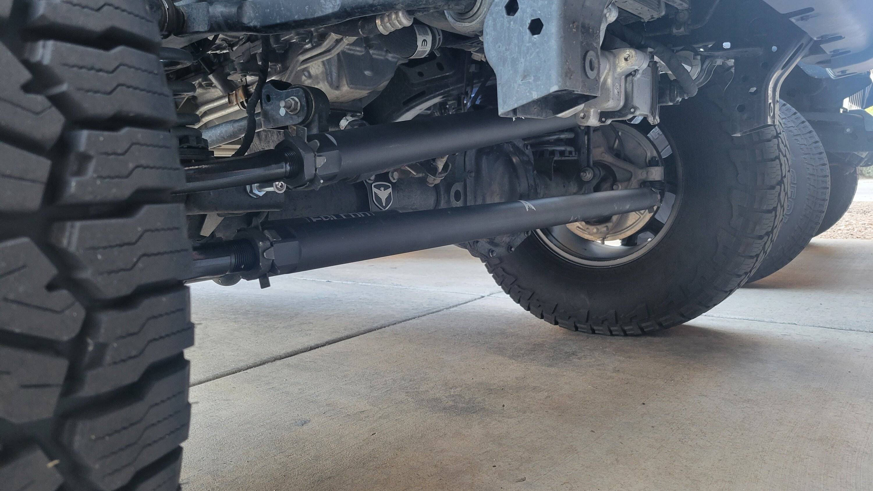

What track bar did you get? I did steersmarts yeti hd with pro bushing. And if you want zero shimmy go big or go home- apex or rpm 2.5ton tie rod and drag link.
No more shimmy. Awesome steering.
Did you get a through shaft stabilizer? You may want to. I had bad luck with standard ones causing a right pull

Well for around 1200 bucks, maybe a little less when on sale, you can get rid of any shimmy with the apex or rpm 2.5 ton aluminum tie rod and drag link. I think there is another company that recently makes one for around 800 (edit Cavfab 2.5ton steering $750). It sucks having to spend 2 or 3 grand to get good steering, but i will say it's been really nice not thinking about it anymore.
Jeep Wrangler JL Steering Shimmy 20221223_161744

Those are beefy! It is attempting to do it, just so I don’t think about the shimmy on every upcoming bump :)
