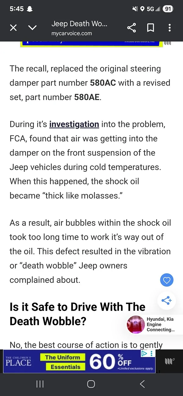

The only thing I could think of would be trying a new/upgraded steering stabilizer. I've seen hundreds of opinions on doing a stabilizer or not, how it can never be a root cause and only ever a band aide fix for the real issue, but I can't find an issue otherwise, and neither can the alignment shop. My Jeep doesn't qualify for it being at 112k miles, but I also found a lawsuit for 2018/19 Wranglers with almost an exact description of what is happening to mine (not horrible or uncontrollable, and worse in colder temps). Lawsuit says air gets in the stabilizer, and at colder temps it can't be worked out as the oil in the shock thickens, and you get the little wobble/shimmy in the wheel.
Planning to do brakes/rotors and a new stabilizer this weekend with my buddy who's a mechanic. There's a lawsuit over it that's basically describing my issue and naming the stabilizer, so I figure it's a good place to start. And I don't want to start putting money into a new track bar/tie rod/control arm(s) when I'm being told by a mechanic that they're good. More just looking to see if anyone else has some more advice, if anyone has experienced the same issue?
