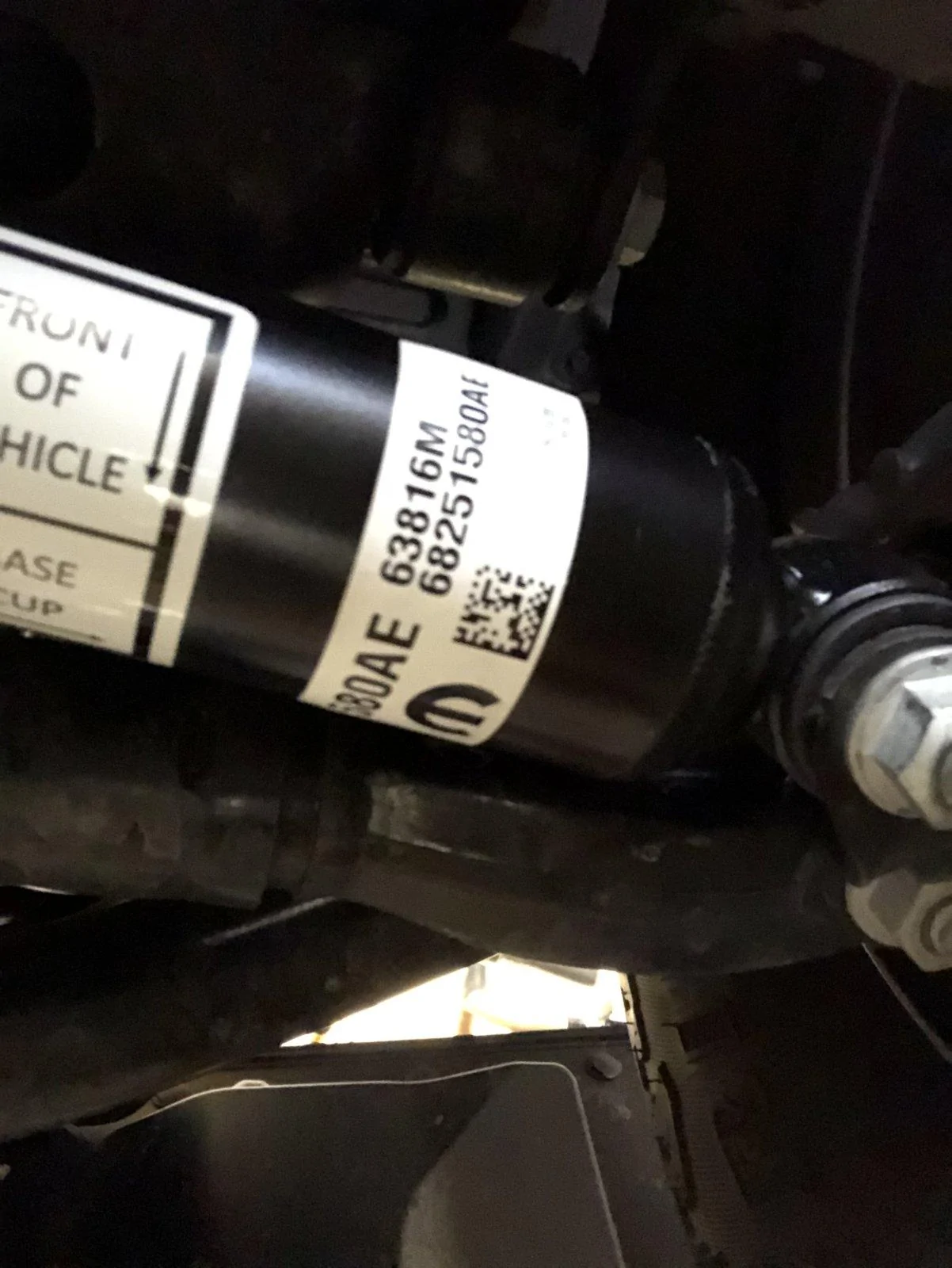

Here is the part on my car - wondering if anyone recognizes this as OEM/appropriate.
I had a different dealer redo the recall so it would have had to be done wrong twice, by two different people, for the issue to be caused by the damper. Still, the car is otherwise new so not sure what else it might be, other than tires, which I’ll deflate a bit.
That's OEM, yes.
Try yanking the stabilizer and see if the pulling goes away.

Invest in a “through shaft” design steering stabilizer like the Fox TS or ATS or the Teraflex Falcon Nexus 2.1 or 2.2, they absolutely will not cause pull or push to either side. You get what you pay for with steering stabilizers. Definitely worth going with a good one. Through shaft is the key. I can almost guarantee this will alleviate your pull, if it’s not your alignment or tire pressures. The OEM stabilizers are hit or miss at best.

Thanks @BLACKMOAB - It's too bad I'm already in the realm of having to shop for parts just to make the new Jeep functional, but I guess that's the Jeep world...
