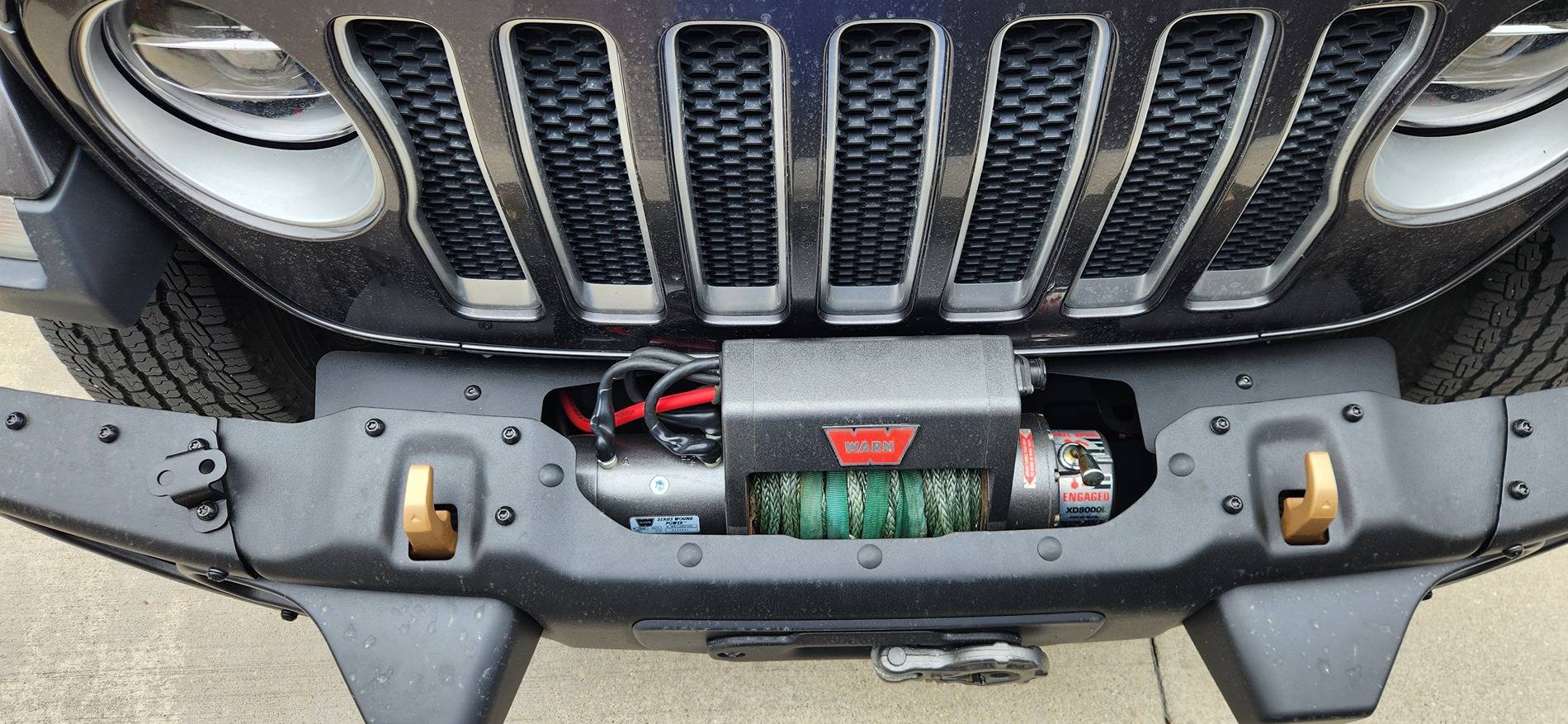

Is this one the same for plastic and steel bumper? Do you also have closeout panel?
no they are two different pieces for the plastic and the steel bumper.

Hello. I just replaced my OEM bumper with a MOPAR steel bumper. In doing so, you remove the plastic molding piece that goes between the back of the OEM bumper and the grill. Now the space is just empty. Does anyone make a piece to replace that plastic molding? The original cannot be reused, because it cannot be reattached along the back of the top of the steel bumper.

If you are getting a winch use the items below, the other two posts are wrong.
Kit contains:
Item # 7FX60RXFAA - Passenger's side Closeout Panel
Item # 7FX61RXFAA - Driver's side Closeout Panel
Second on this. The closeout panel does not work with the winch.
That is where the winch goes.
