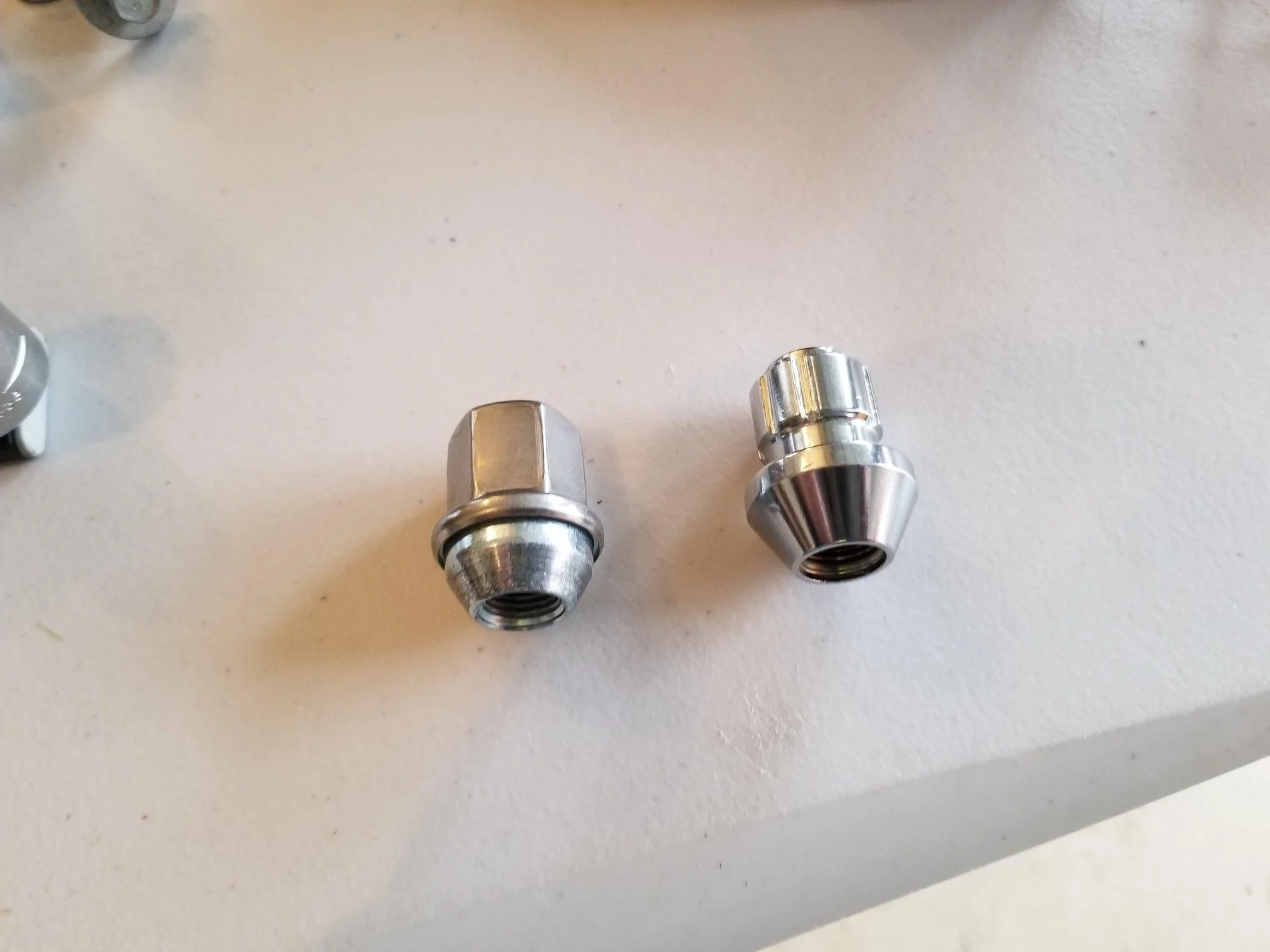

I bought the Gorilla spline lug nuts on sale for $79 at Amazon about a year ago. Been very happy with them.
Do you know if these work with aftermarket wheels? They look as wide as the factory nuts.
The width of the Gorilla lug nuts and the OEMs look close. Unfortunately, I don't have calipers to measure them.

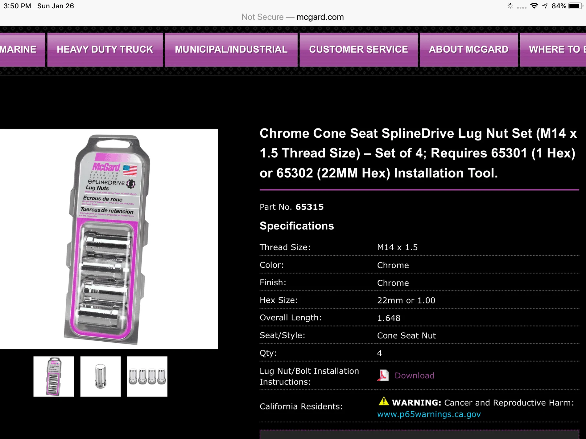

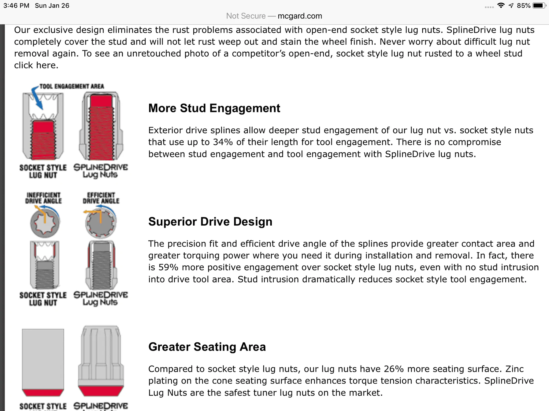

I have the USA made mcguard spline drive lugs. Very high-quality, lifetime warranty. They have a hardened seat at the end that spins so when you tighten the lug nut it does not turn against the wheel and it gives proper torque. Very unique.
