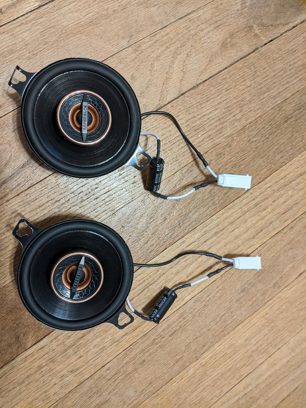

Here's something I haven't seen mentioned for a while. The Metra 72-7902 speaker harness is wired backwards with + to -. When used as is, it puts the 3.5' speakers out of phase with the 4" speakers and sounds terrible. Here's how I fixed mine. Instead of opening the connector and swapping wires around, I cut and soldered the wires so I would have a clear visual indicator that the adapter was fixed.
Jeep Wrangler JL Speaker Setup and Help speaker adapter fixed
